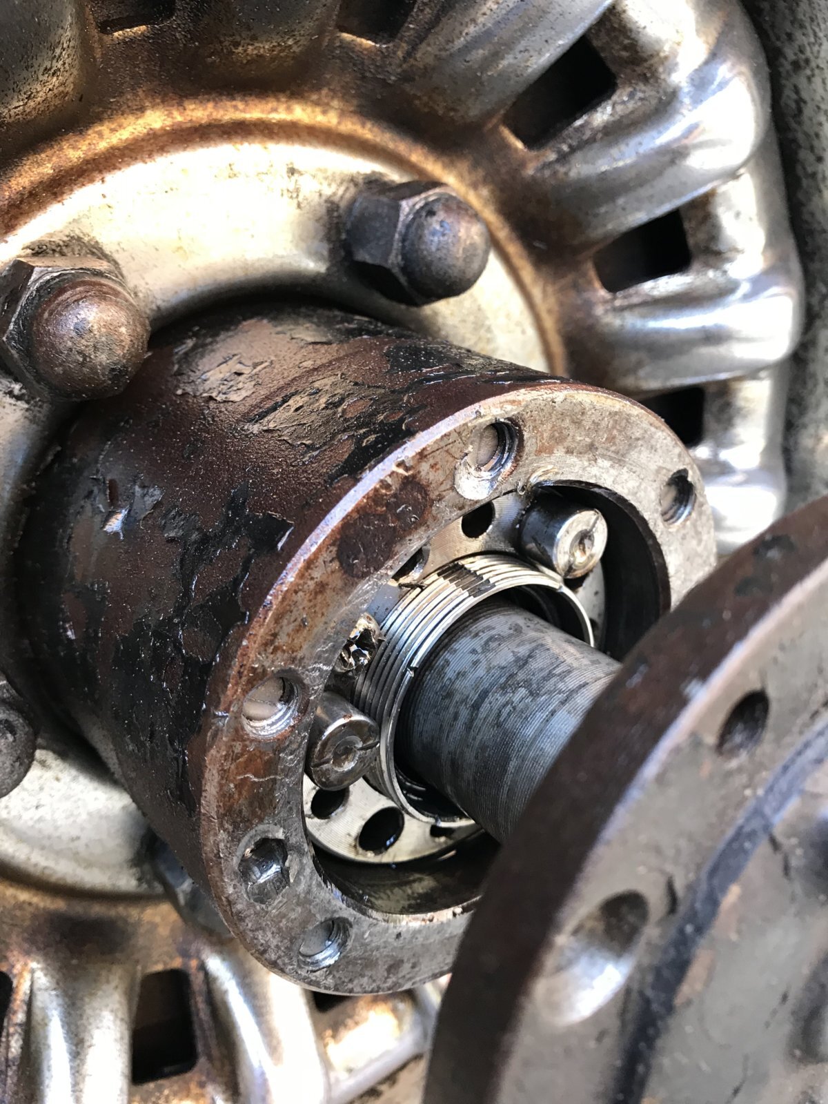

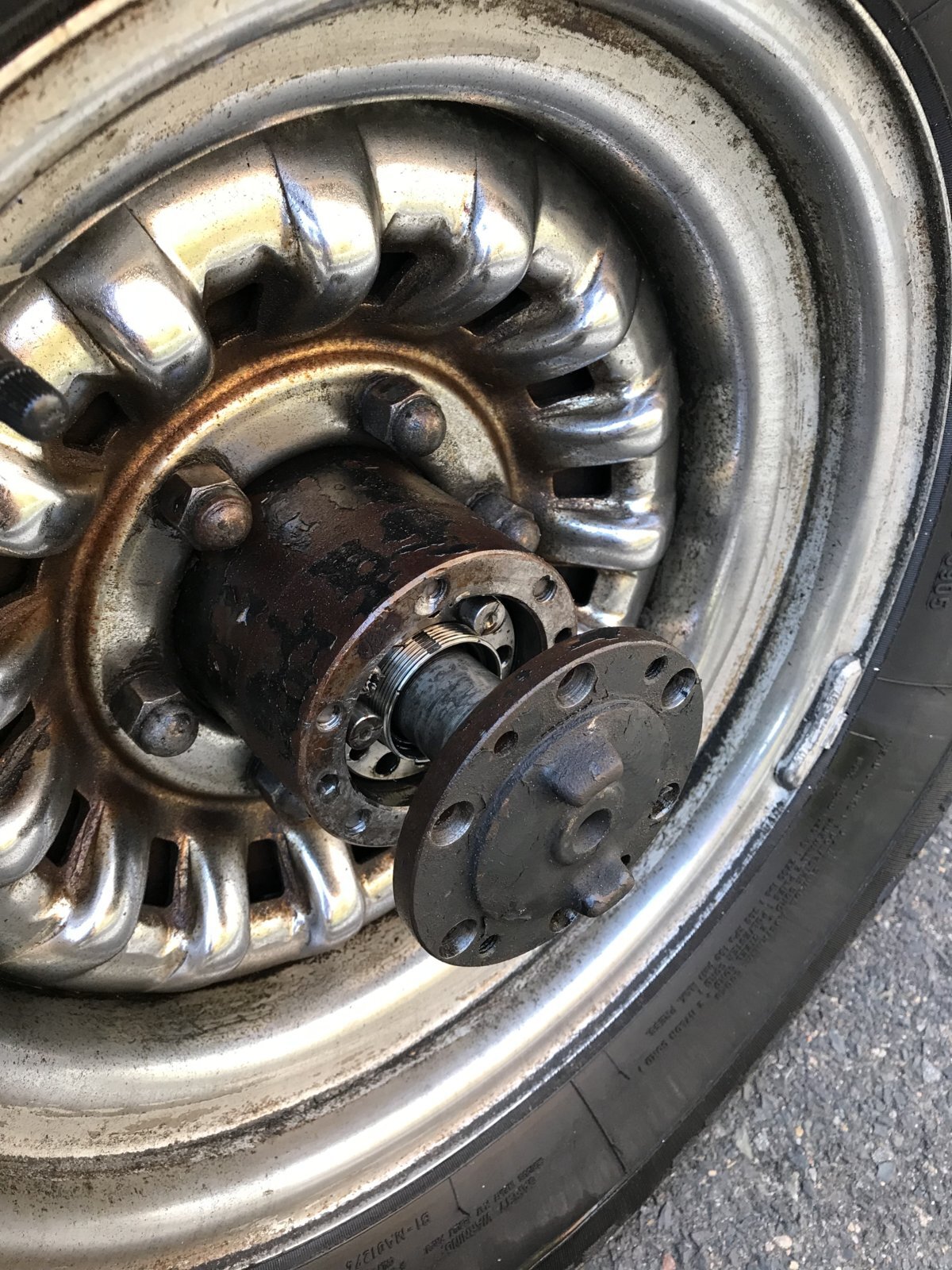

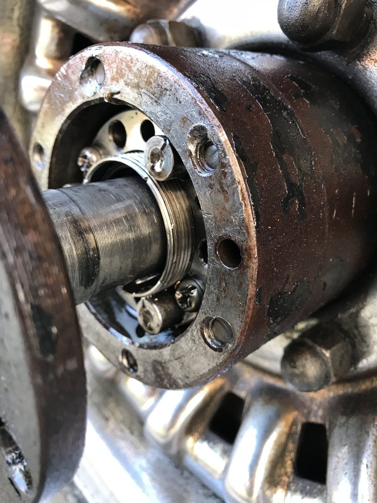

Hi guys,
I’m new on the forum, I’ve just bought this beauty of a 60 series landcruiser, will post pics of it later. However, as I was driving home from a road trip the rear left axle hub bolts snapped off leaving the axle (I think, I’m not too mechanically educated) coming out of the wheel!
Has anyone had this before? There was a slight amount of oil leaking prior to it happening. What are my best options, is this something that can be done myself or would I need to take it to a garage?
Images attached
7EA1CE75-AAE8-4331-99E0-49DF8F3C61E7.jpeg F5C0390C-49E0-4B7A-AADD-AC715F627B57.jpeg F91CC41A-5EED-44B1-A7D2-03BB80018CDF.jpeg
Those are the drive flange bolts Alex. The drive comes from your diff, along the shaft that you can see then the end of the shaft is bolted to the hub that connects to the wheel. So all your drive goes to the road through those 6 studs and usually a couple of locating dowels too. Usually failure can be attributed to the nuts on the studs not being correctly tightened, allowing the flange to spin and rip the studs out. It is not catastrophic and can be fixed but it needs doing by someone who understands Cruisers, not simply any old garage. It's very hard to get the broken studs out and looking at the mating face it looks in poor condition. I'd put a new hub on there.
Also - can't be sure but I'm thinking that the gasket is also missing between the hub and the flange. It does quite an important job does that.

I have an 80 series but the setup looks very similar if not the same. It’s possible the bolts has come loose or weren’t fully tightened or maybe even overtightened. Any of those 3 scenarios could lead to the bolts shearing. The bolts secure the half shaft to the hub via the flange, transferring drive. The hardest bit will be getting what’s left of the sheared bolts out. As there doesn’t seem to be any damage (hopefully the splines on the inner end of the shaft and in the diff will be ok) it should just be a case of fitting new bolts.

The problem with re using the hub is that firstly you have to get the broken studs out. Well this can go one of two ways; successfully or a total disaster. If the stud isn't too far down you can use guile and wit to get them out. Drill and stud remover, drill and LH tap, weld a nut over them and so on. Sometimes they are distorted and simply won't come out. I made a special tool which sits in the middle of the hub and tales pilot drills over the centres of the studs. Without that, it's very hard to drill the end of an uneven stub. You could try strong bonding glue to attach something like a hex key to them and wind them out. But if the threads have taken a beating and it looks like they have then to be honest just how well are they going to hold up next time? Tough call really but in the land of the Cruiser, I'd say a replacement hub would be the simplest and most cost effective solution.
Oh and order some replacement rear shaft seals too. Don't do this without swapping those and also get the correct gaskets.
x2 for a new hub, if you haven't removed it already jack up the wheel and see if the wheel bearing is loose, that can cause the bolts to shear as well. When you replace it all recheck the wheel bearings at tight after 1000km or so, you have to remove the axle to check them

Looks like somebody’s been in there so the advice given on replacing seals and checking everything/replacing is good. Bearings need a preload and the drive flange is secured with cone washers over the studs to hold it on properly without movement (if it’s anything like the 80s). Hopefully these will be present on the other side. A replacement hub is easiest for sure if one is available. Otherwise once removed it could be taken to a friendly engineering works who could either remove the broken studs and clean up the face or drill new holes offset to the originals. If you’re lucky and get the studs out, the holes being damaged aren’t going to be able to support the studs like a new hole/hub. If I were you, whatever hub I used I’d be replacing all the studs on both sides as overtightening could well have caused this.
