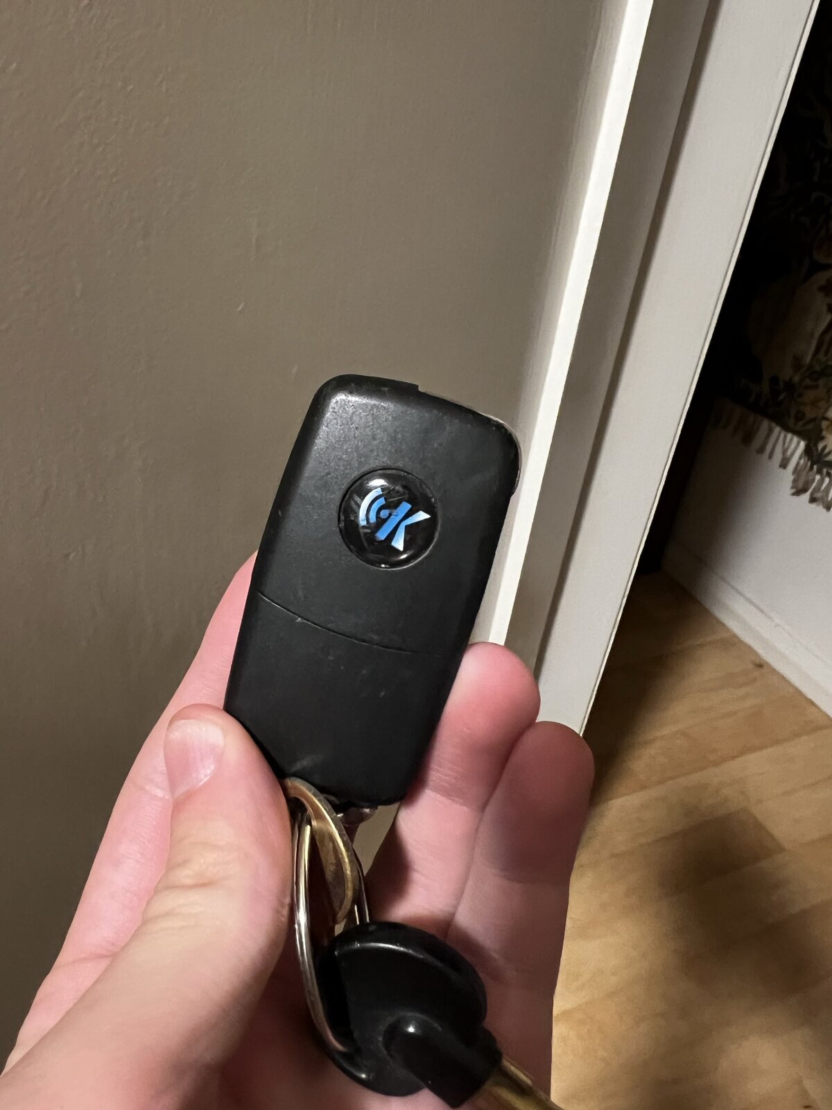

no it doesn't it is very much a third party key, I took a picture and google searched it, comes to a company that seems to make a fob for every single car out there, I just have no idea if he got the right one or every set it up

Tbh it's probably easier to get the Toyota ones and go from there. I think it is possible to view the remote module from behind the radio if you wanted to be sure.
Actually I think you can tell for yourself if the module is there by following the pairing instructions even without a key fob to pair. You'll just look out for the 20 flashes of the hazard lights, if you see these you know the module is present and can most likely buy fobs with little risk.
Instructions and lots of discussion here, apparently from 99 remote central locking was standard on the GXL. Re-programming central locking remote - Toyota Prado How To's, Technical Information & Reviews - [Leaving Land Cruiser Club]
