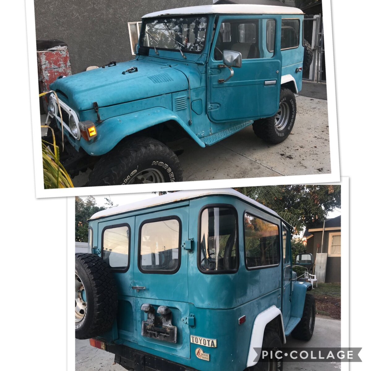

So excited for you! I recently picked up a 76 and it was 85% stock.. needed some work and it’s in the shop and will be ready soon.. I already have my body guy ready to get her painted..I’m having such a blast but can’t wait to take her for a drive in November sometime! I wish i could give you tips but I’m the farthest from being a mechanic. I would like to see it.. here’s mine.
