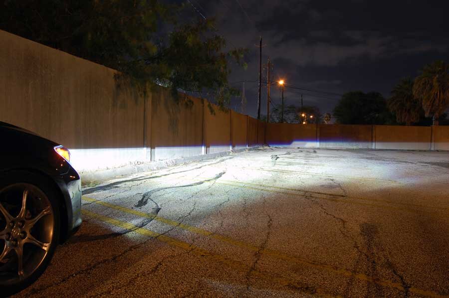

I think this picture sums up quite nicely what I'm trying to say.
the main thing I remember from the A8 is lack of contrast so missing detail and that gave me a bit of eye strain. Pic above is washed out and blurred in places but that may be just the reproduction method.
