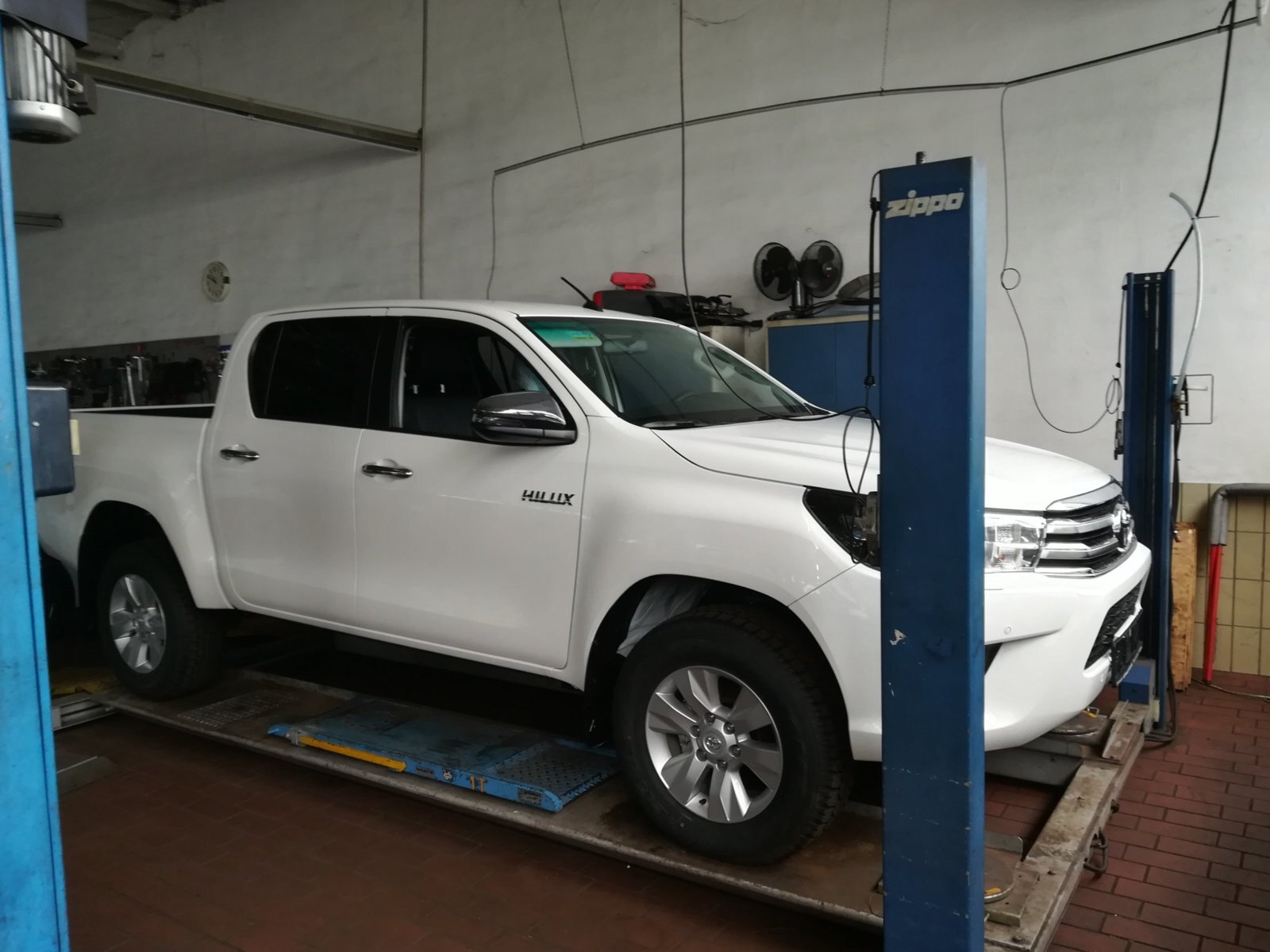

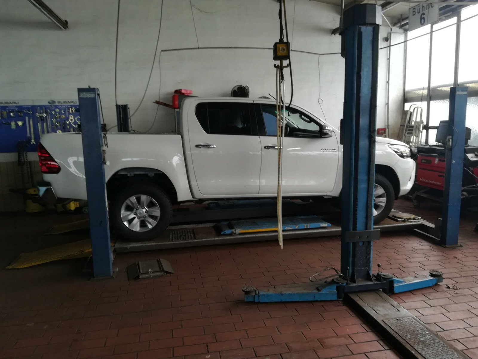

This are some pics when it arrived at the dealer, a week ago. I was delivered on Wednesday, they had a few things to mount and the registration paperwork.
It is the medium trim, auto box, with climate control and heated seats, and absolute minimum of electronic nannies.. I had the top trim for a day, Executive, took it off road and the bloody start stop system and the other safety sensors were driving me nuts...
Plus the executive comes with 18 inch wheels, impractical for off road..

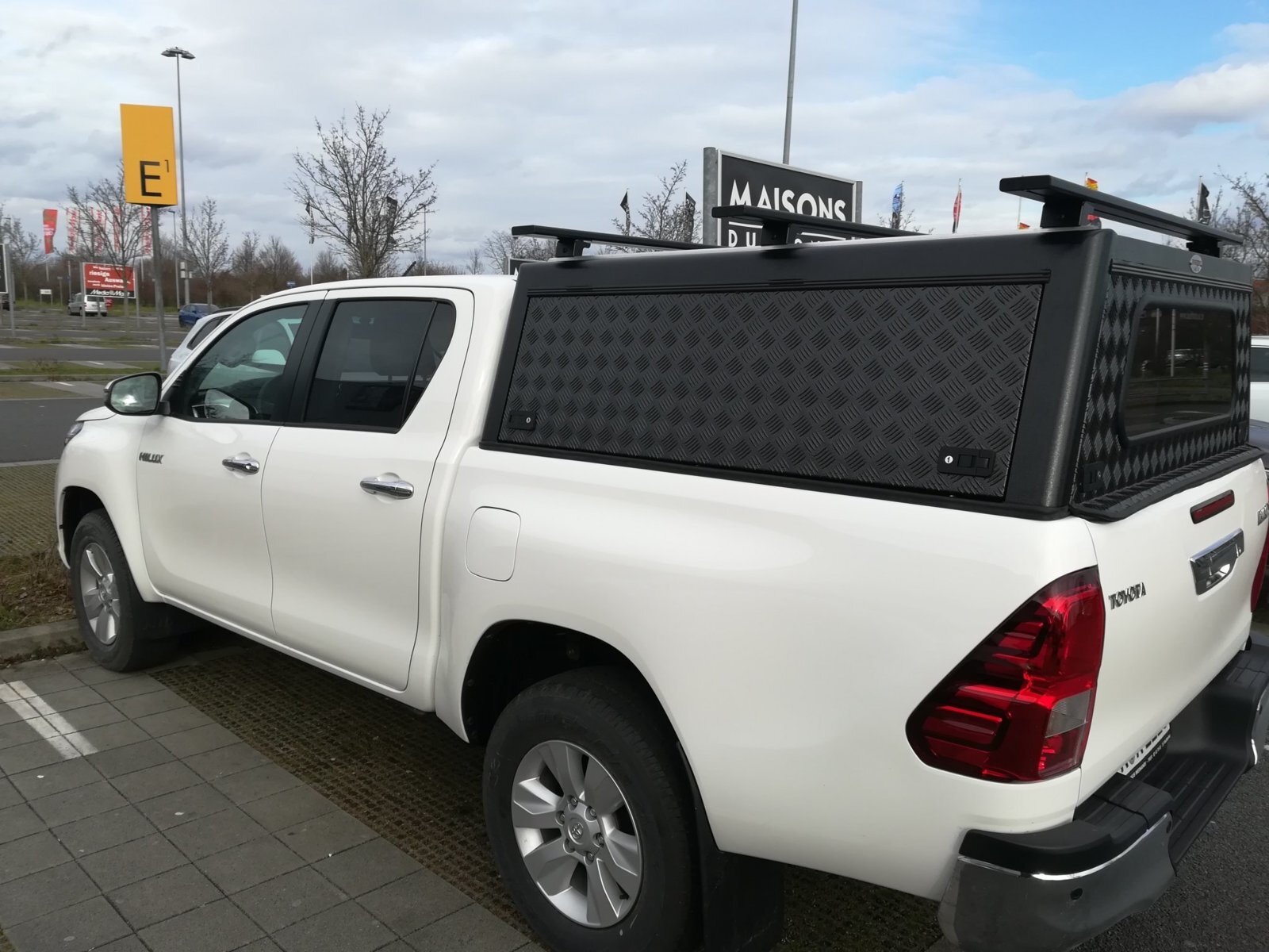

Friday I went to mehari off road, to install the canopy and engine shield.
The canopy is an Aluminium canopy, made by Bushtech, an SA company like Alucab In my opinion is much better than Alucab, the quality of work, details and the insulation is far superior. I seen both at expo's and Alucab all look like they were build during the World Cup..
As options got the table that stores in the ceiling, the cheapst fridge slide I could find, and a side cupboard+ the taild dust kit. The last 2 did not arrive yet..
Pricewise it is a bit more expensive than Alucab, but the optionals are cheaper, so more or less same money. Those looking at Alucab should give this company a chance..

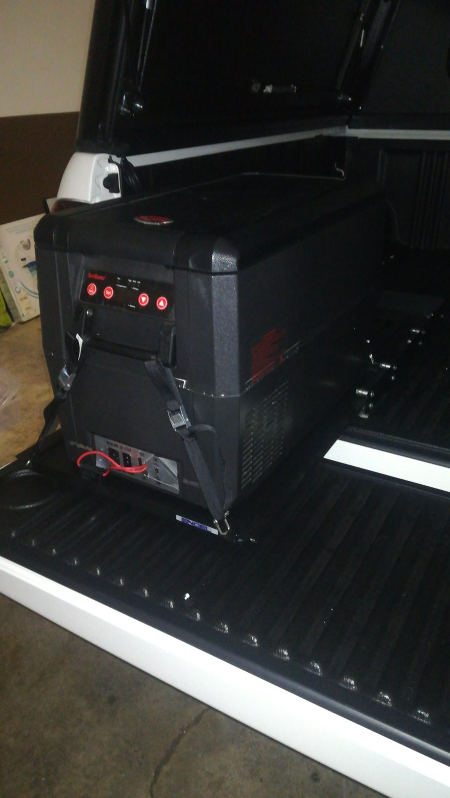

Fridge slide is in

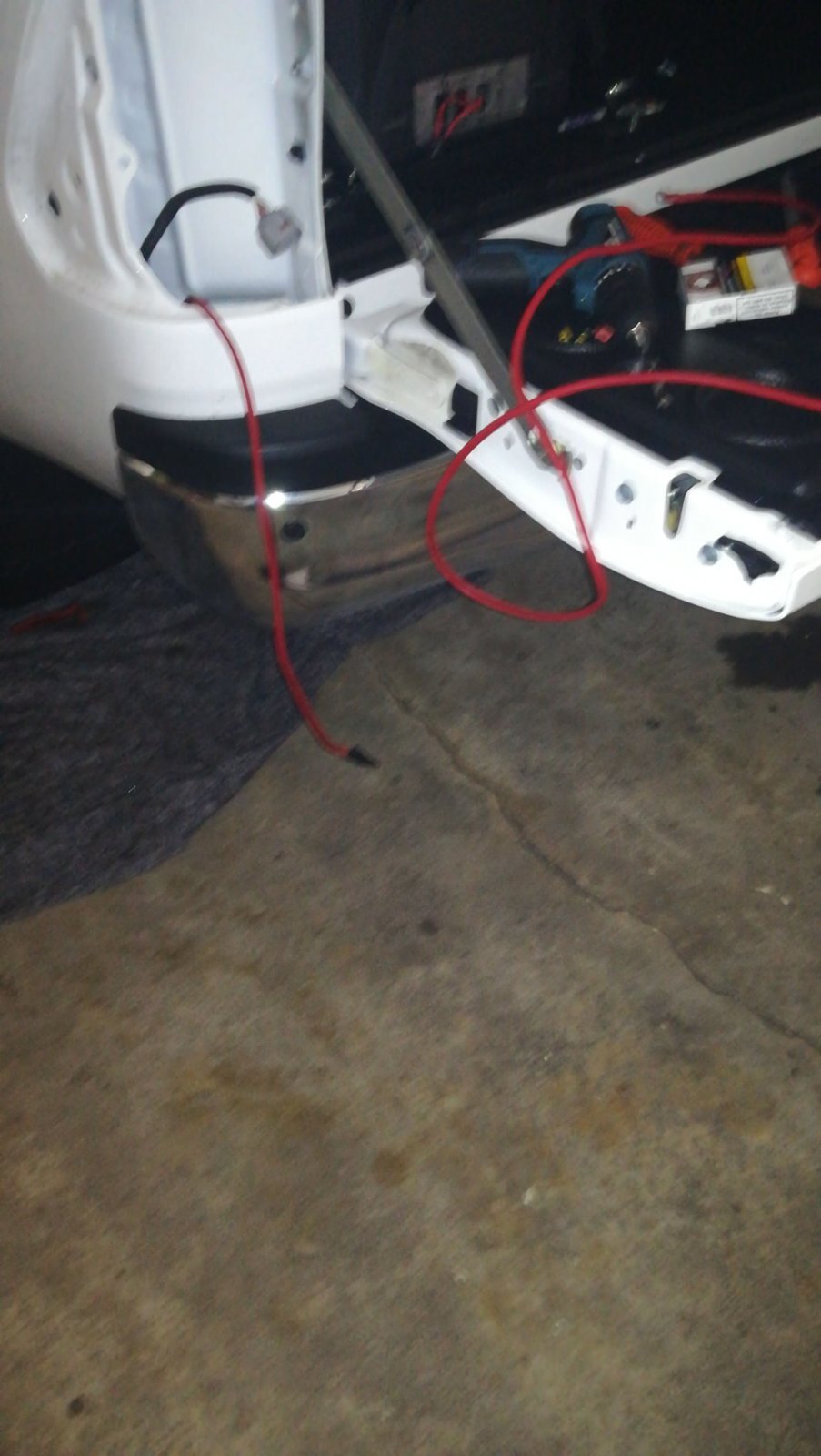

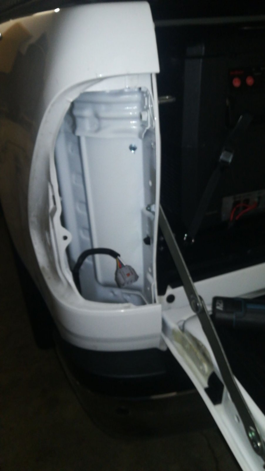

They say you can get in the back of the bed via the Stop light. Bullshit.. you still need to drill a hole, always painfull in a new car..
sexy red zip tie to know what to cut if need it.. :)

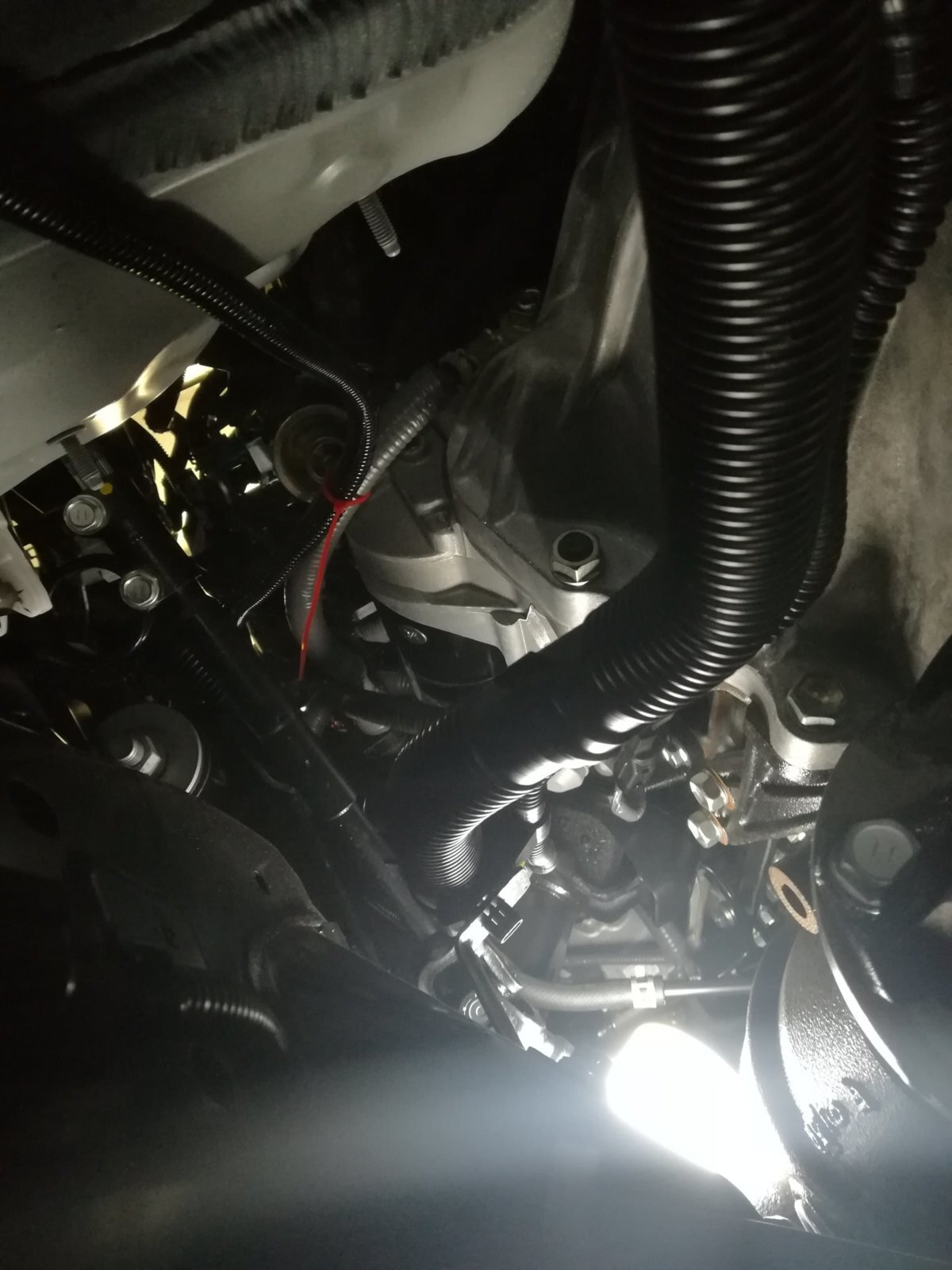

1 h later the + is in ..

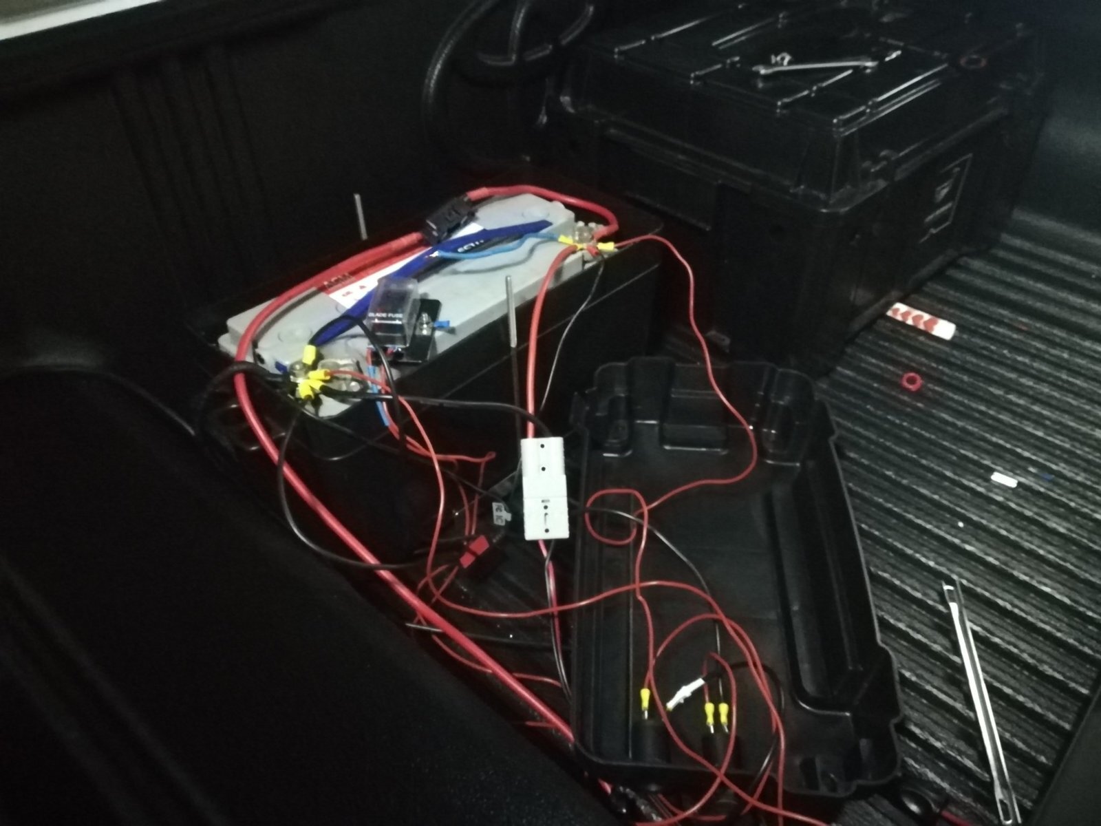

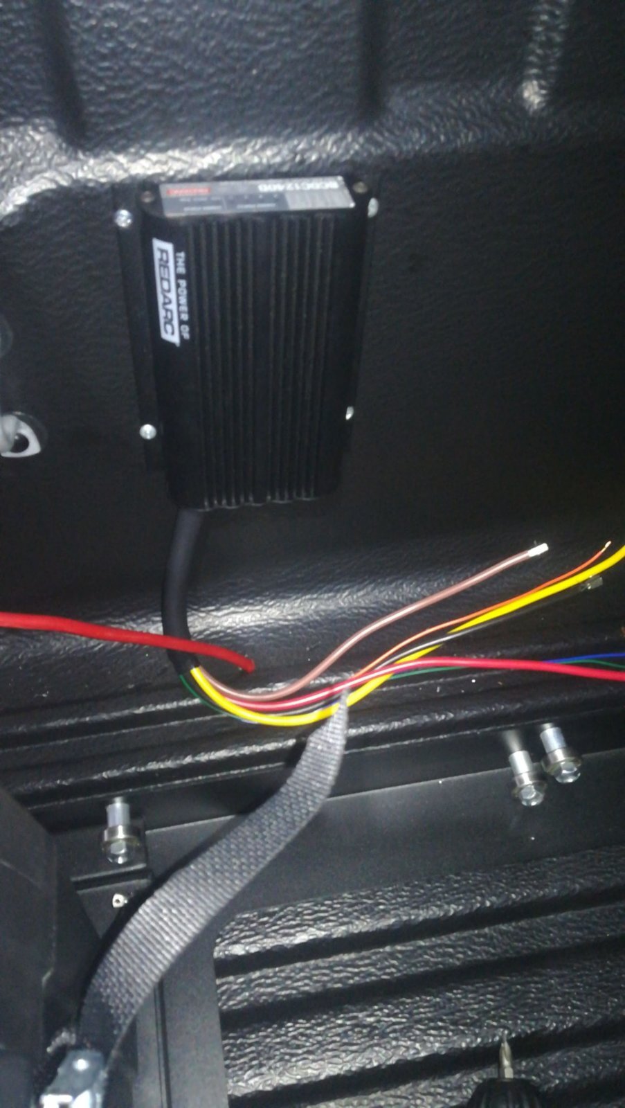

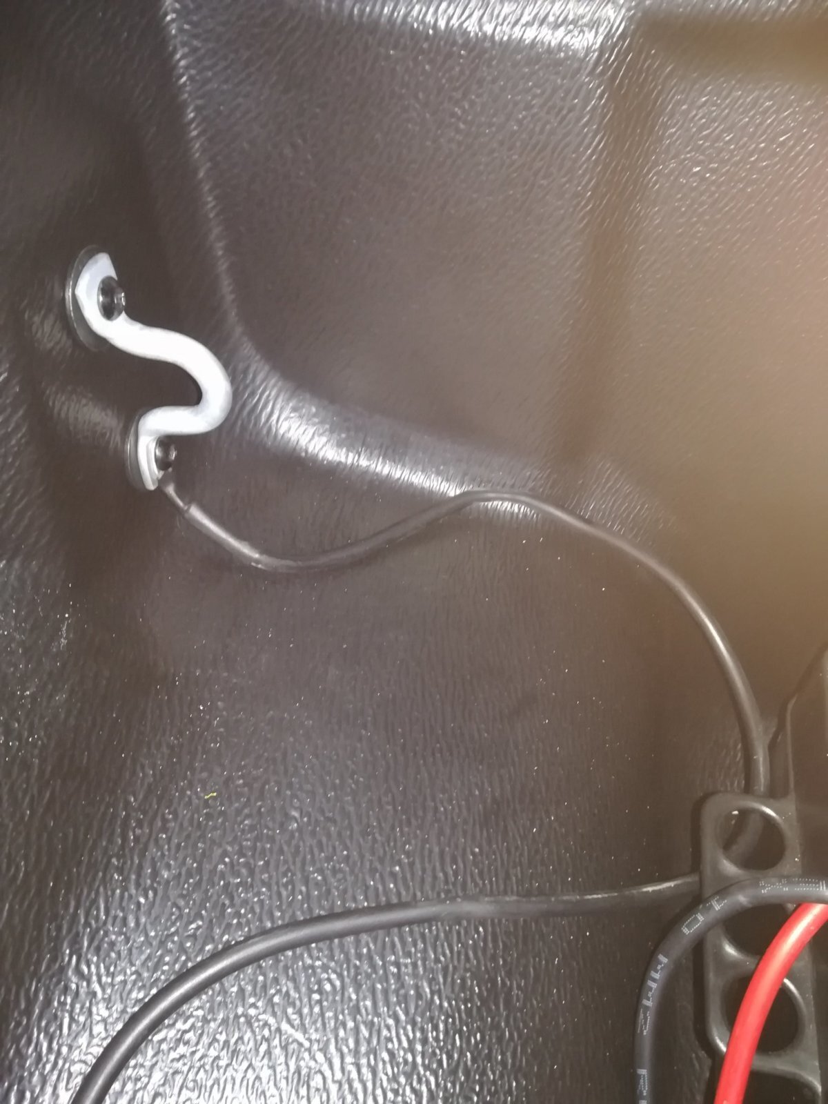

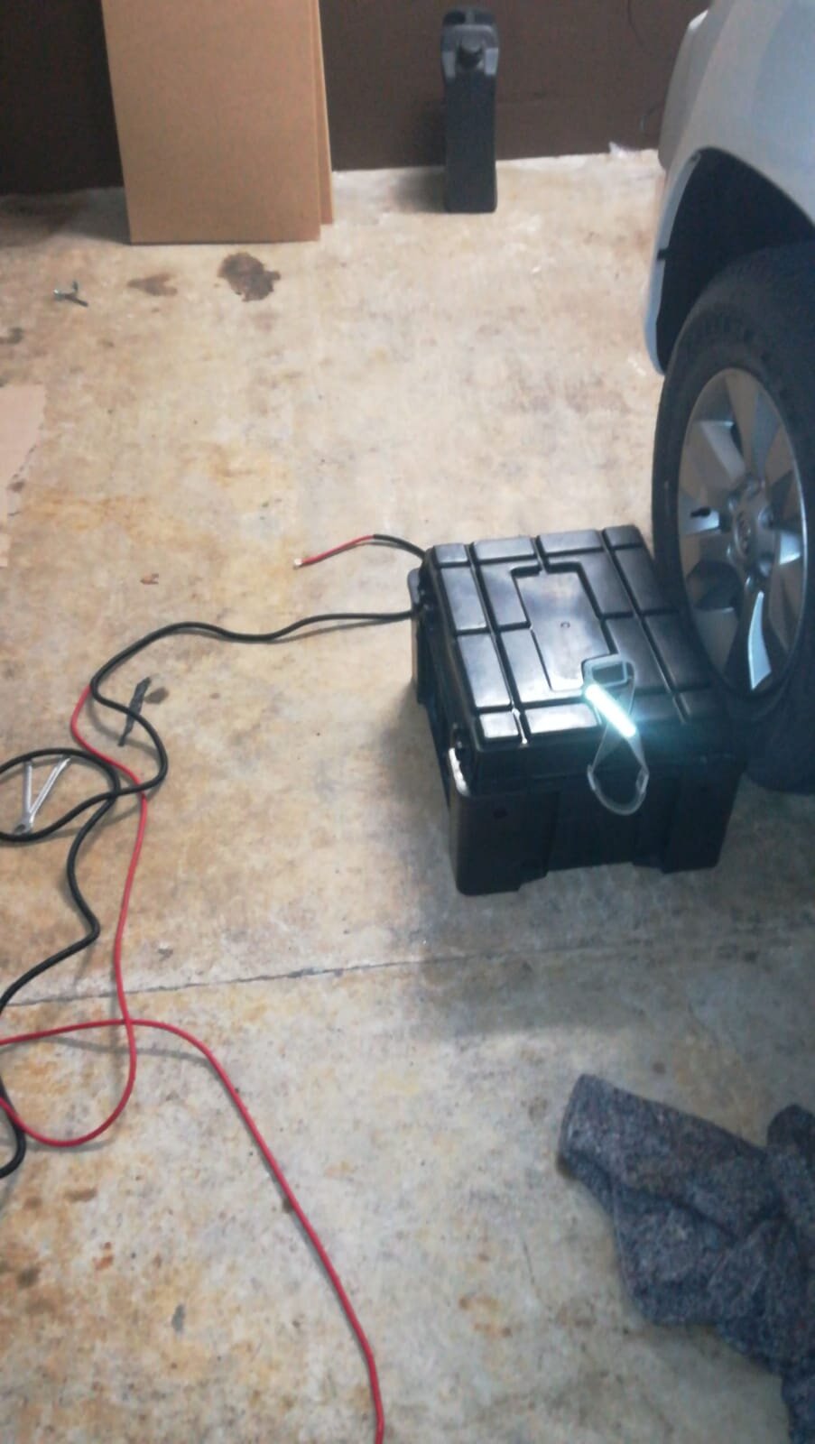

I continued working over the week-end.
Found a good earth conection :)
All is connected and works, the redarc charges very fast, I am very happy with it.

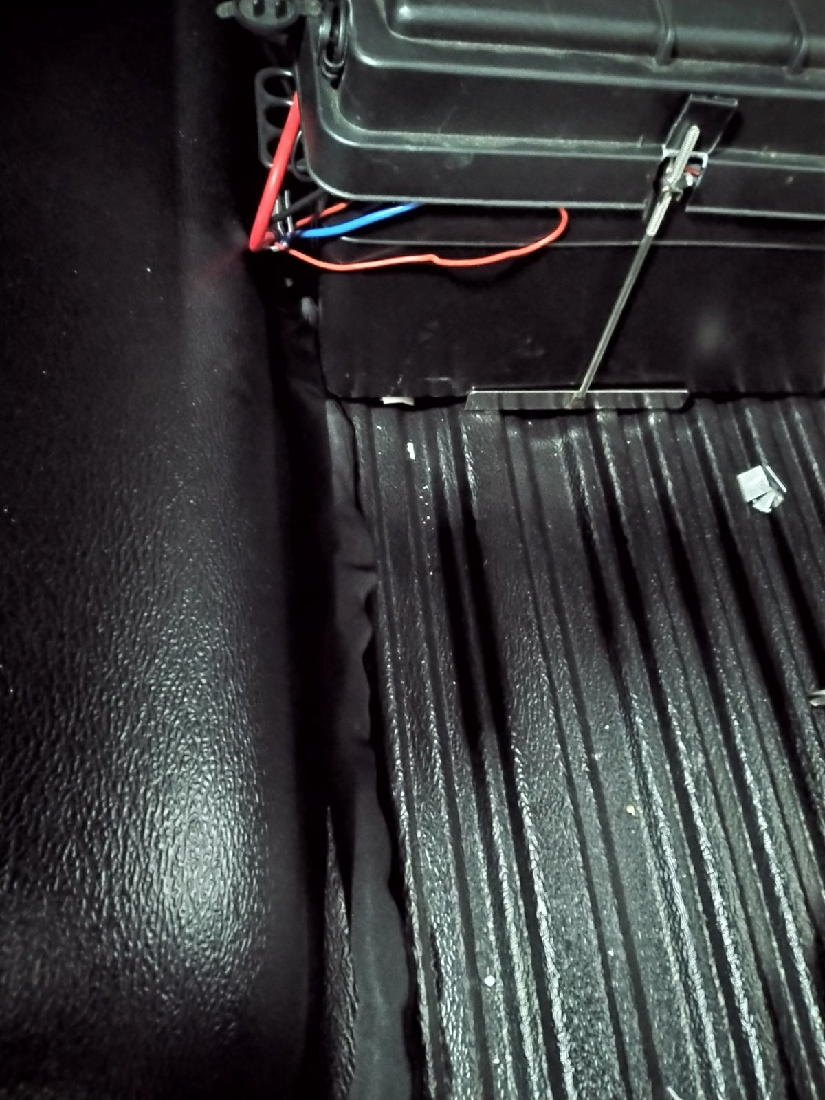

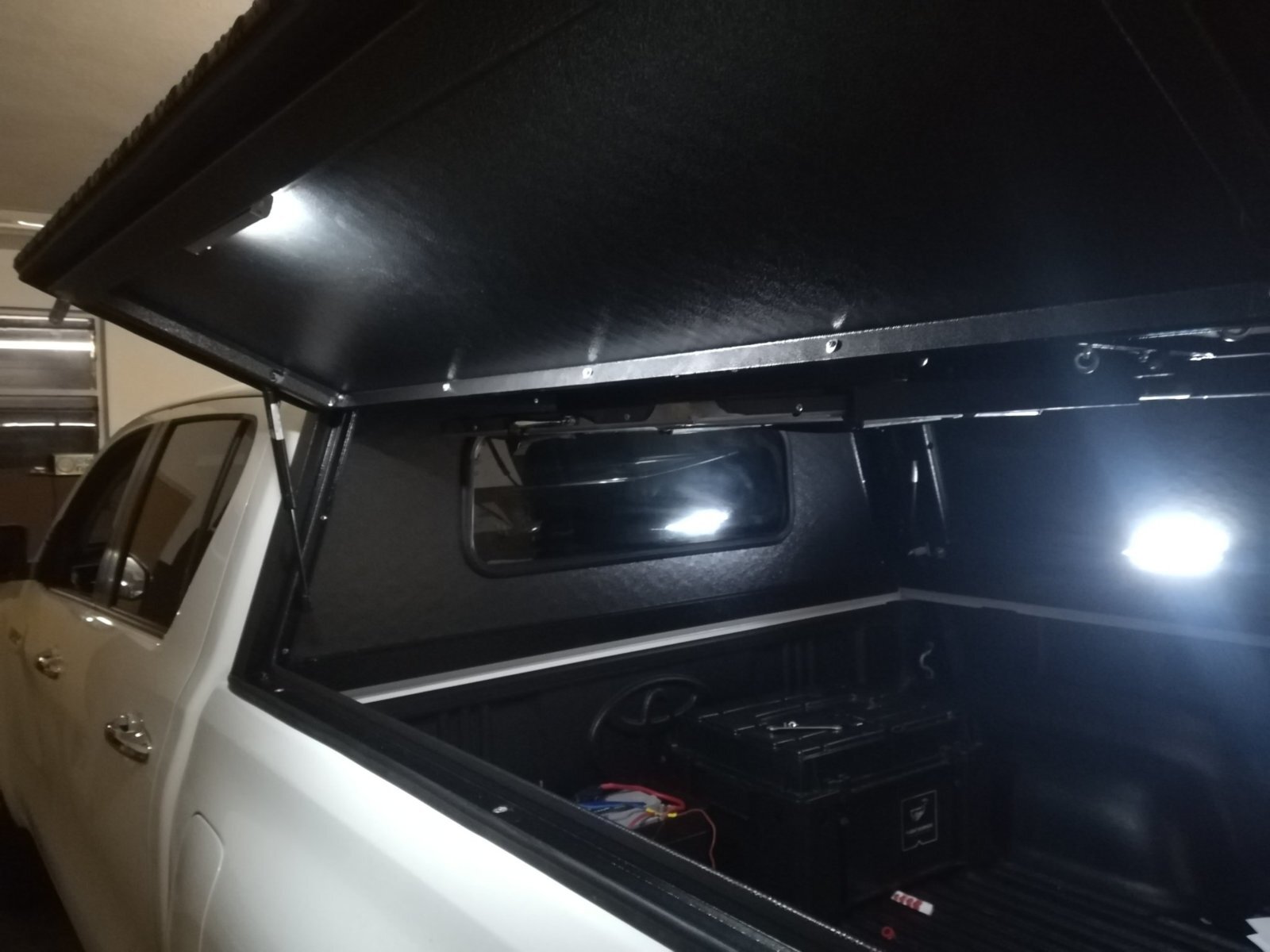

I have light in the canopy :) IMG_20200223_185334.jpg
Should have done that first, would have made my work easier..
I still need to connect the solar system and after I will arrange the cables properly.

I mean the Redarc BCDC chargers are very good in my humble opinion
I had a VSR before. While it was charging, never had the full baterry before, also because my LC was one of the late ones with smart alternator.
It can still be a good option if you don't need a lot of power and you are on a budget, maybe you don't do that many trips.
So the redarc does charge the battery much faster and brings it to full. I was measuring it and it was charging exactly at 14.6 like in the book :) .
