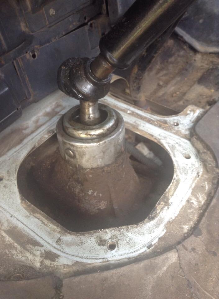

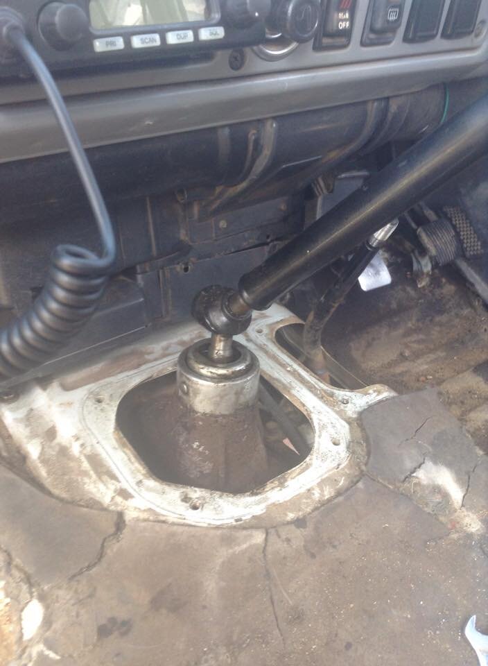

Hj60 How to remove gear shifter from the gear box itself?
Axel0410
Jan 12, 2014
5
australia
I just need to take it out so its possible to slide the gearbox back so i can change the clutch
Thanks :)

You need to push down on the center piece that surrounds the stick and turn it anti clockwise and it will pop out. :icon-wink:
Push the ring down, and turn it counterclockwise. once rotate the right way the spring will push it up.
