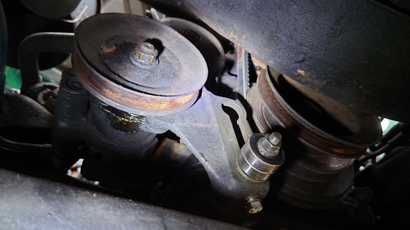

I had my first mechanical failure, water pump broken. With some parts from Cruiser World I now have new belt and pump fitted. Nice job this weekend, it's been a while since I've done this type of maintenance so was pretty pleased with myself.

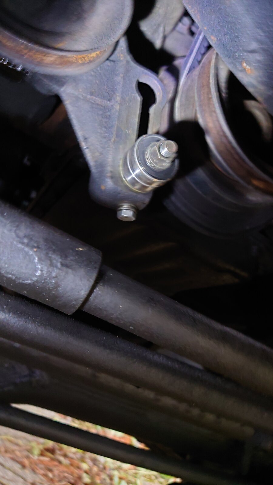

In doing this though it looks like there has been a modification to the power steering pump idler pulley assembly. The V-pulley had been replaced with two bearings. That's ok on a solid V-belt but likely to result in failure on a serrated v-belt as it's acting on the inside of the belt not the outside..
Does anyone have an idler pulley for an early series 60 diesel? If not are there any recommendations for a v-pulley modification suited for a serrated v-belt?
Will post a picture of the offending part later. In the meantime am using the car as exercise as it's heavy muscle work without power steering. Reminds me of my army lorries that had no power steering....
