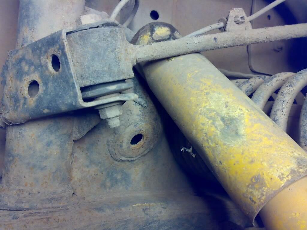

Not very so it seems :mrgreen:
Top mount has sheared off, lucky it the lodged itself here and I did not even notice any difference.

is that an ABS sensor wire it's cut through?
Yes, I'm hoping I can rewire that or I'm guessing I will need a new wheel sensor as well.
There shouldn't be anything electricaly special about the wire (I've repaired a few ABS wires now), it just usually has a thick sheath for mechanical protection. Try and put heat shrink over the joints and then wrap it all in self amalgamating tape to really seal it up and avoid small current leakages at a later date would be my advice.
Was an ABS malfunction how you noticed the broken shocker? :shock:

Yes the ABS light came on in the Western Sahara maybe 2.5K miles ago, so the shock either broke at that moment or a little time before, I'm really pleased I did not know because I would have been very worried :mrgreen:
My LC was not over weight, in fact 200KG at least under the GVW (I put it on way bridge so I know)
Looking back I was thinking the back seemed under sprung at that time, which I still think it is.
I bought them for a soft ride in mind for green laning in the UK with a light load, so the shocks and springs are the softest OMU's
The shocks are around 18,000 miles / 3 years old.
I came home and went straight back to work and today was the first time I really looked around the LC.
EDIT thanks for the advise about the wiring.

I did think it was time for a very good look this year of the suspension and joints (front joints) but I never thought an OMU shock would break after only say 5K miles of hard use, something I would never of thought of changing for PM after so little time, maybe I was just unlucky.

It might be that the top bush's were too stiff or that the nut was done up too tight which puts a lot of extra stress on the pin.
Could be, it's a very hard location to get a socket / spanner on, I will have a good look at the break point with the grammar school boy at work :mrgreen: when I get it off and see what he thinks.
I did do the same apprenticeship as Ross Brawn don't you know I don't normally over tighten nuts(my claim to fame) :mrgreen:

It would be great if you posted a close up pic of the break surface. Would be interesting to see if it was a fatigue failure (which would be of great interest to OME especially after such little use) or an overload failure. Even if it was an an overload failure it would be interesting to see if it was a purely brittle fracture or ductile fracture.
Either way I would be in contact with OME to see what they think and if find out if their warranty is valid out here.

I will take some photos although It will not be for a couple of weeks or so before I gather the parts together for the repair. I'm not driving it atm and I don't want to start the job unless I can finish quickly.
