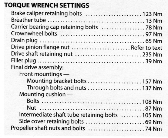

The correct torque for this nut would be really important.
Gregory's Prado 90/95 repair manual says the drive shaft retaining nut is 235Nm.
7th entry
