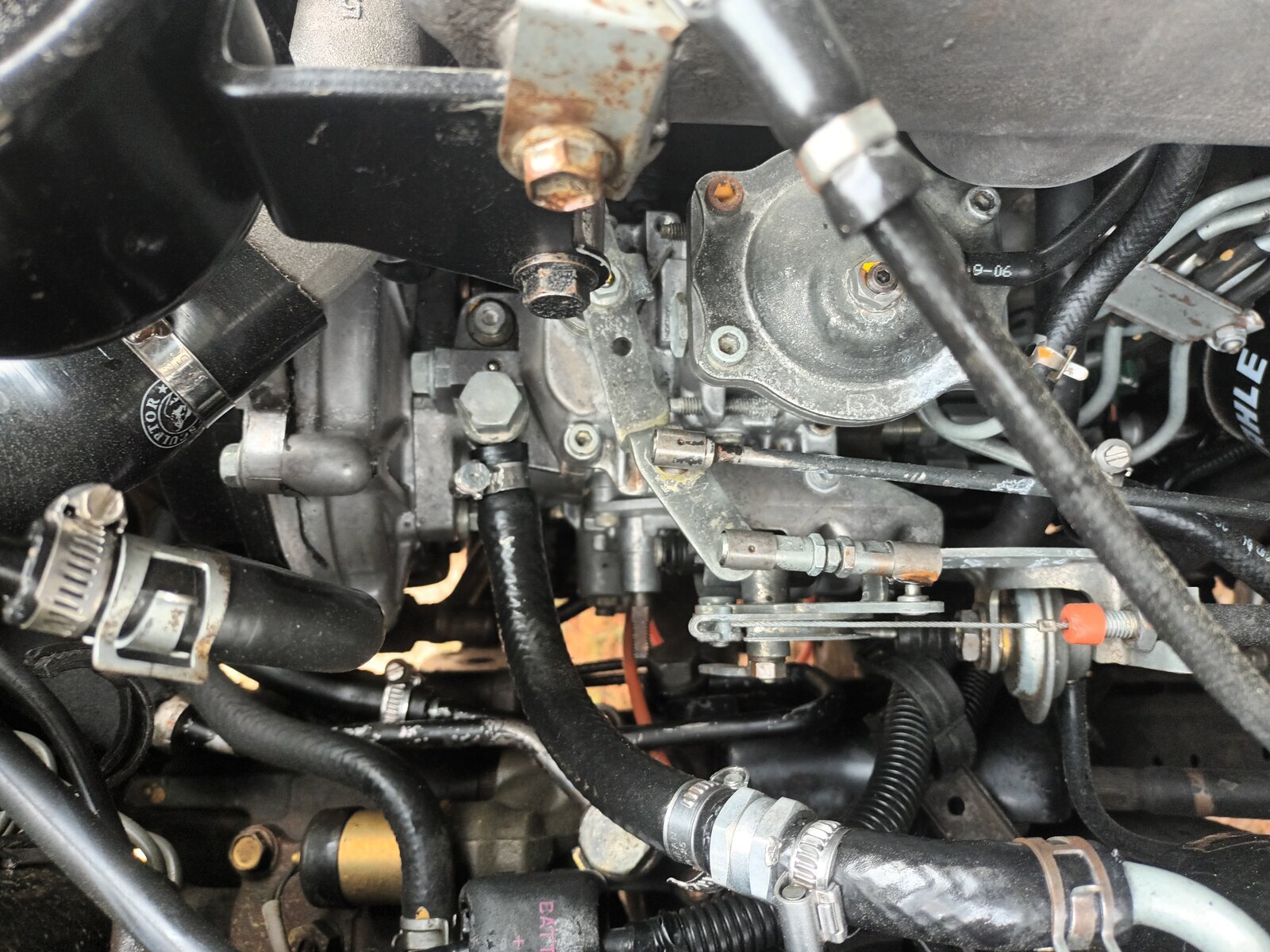

Take a picture of the FIP and post it so we can see exactly what pump you have and what's fitted ....
