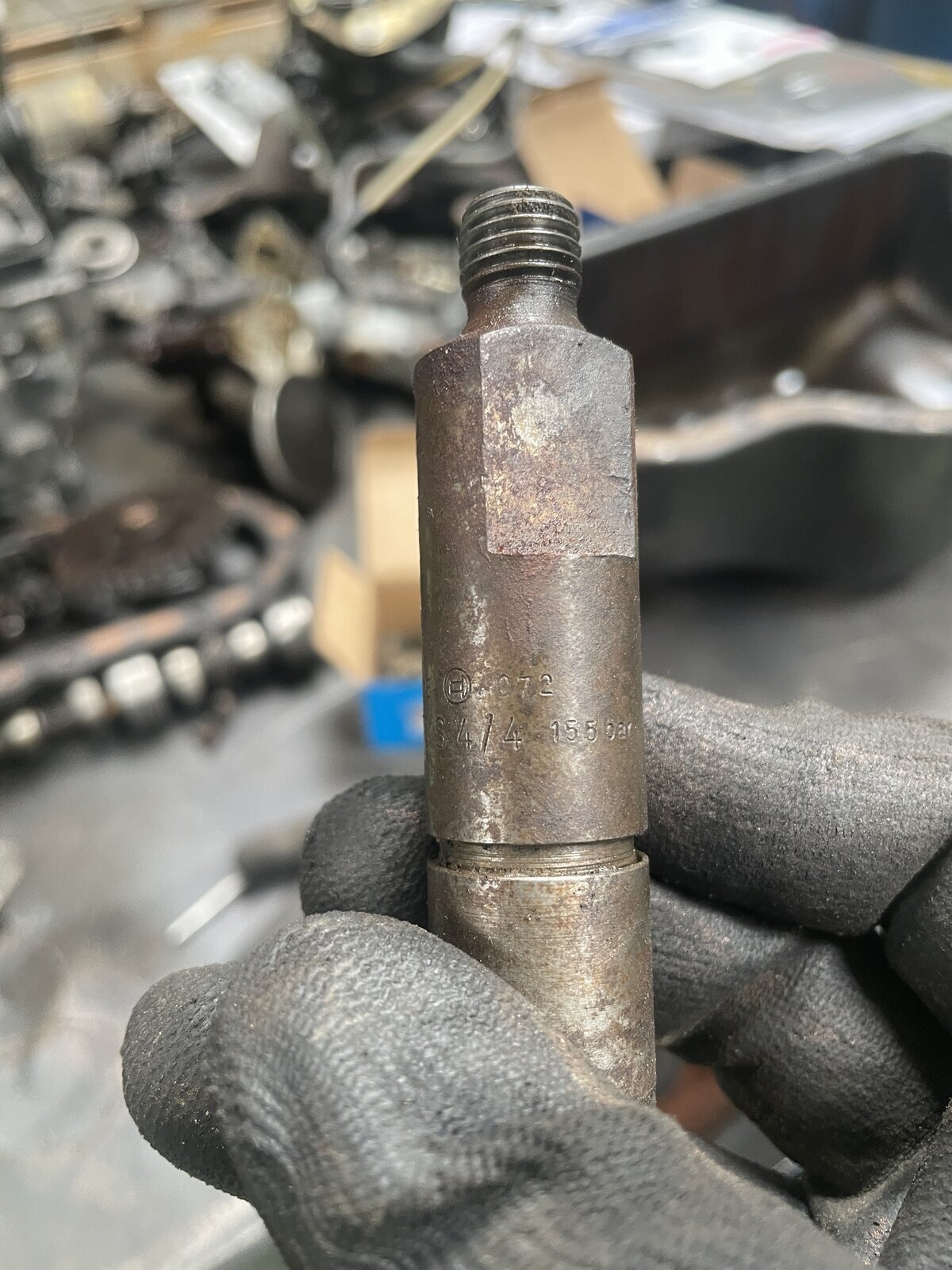

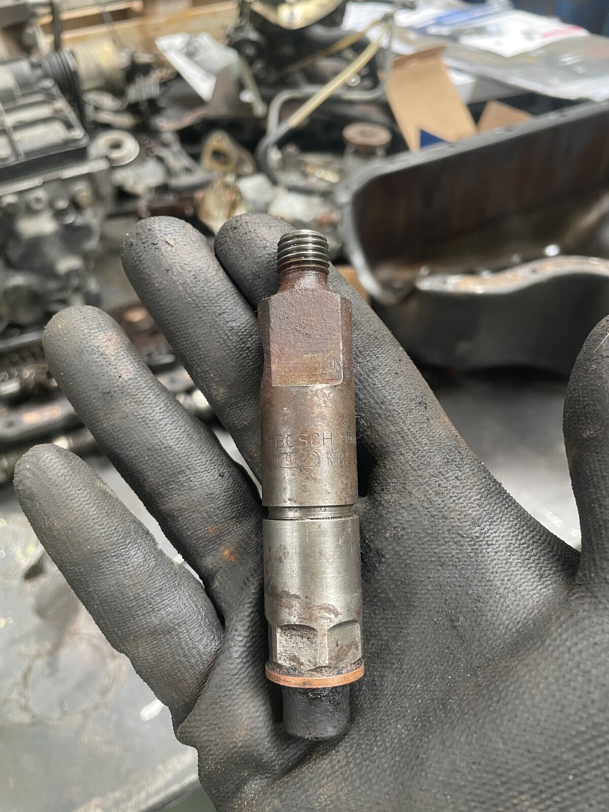

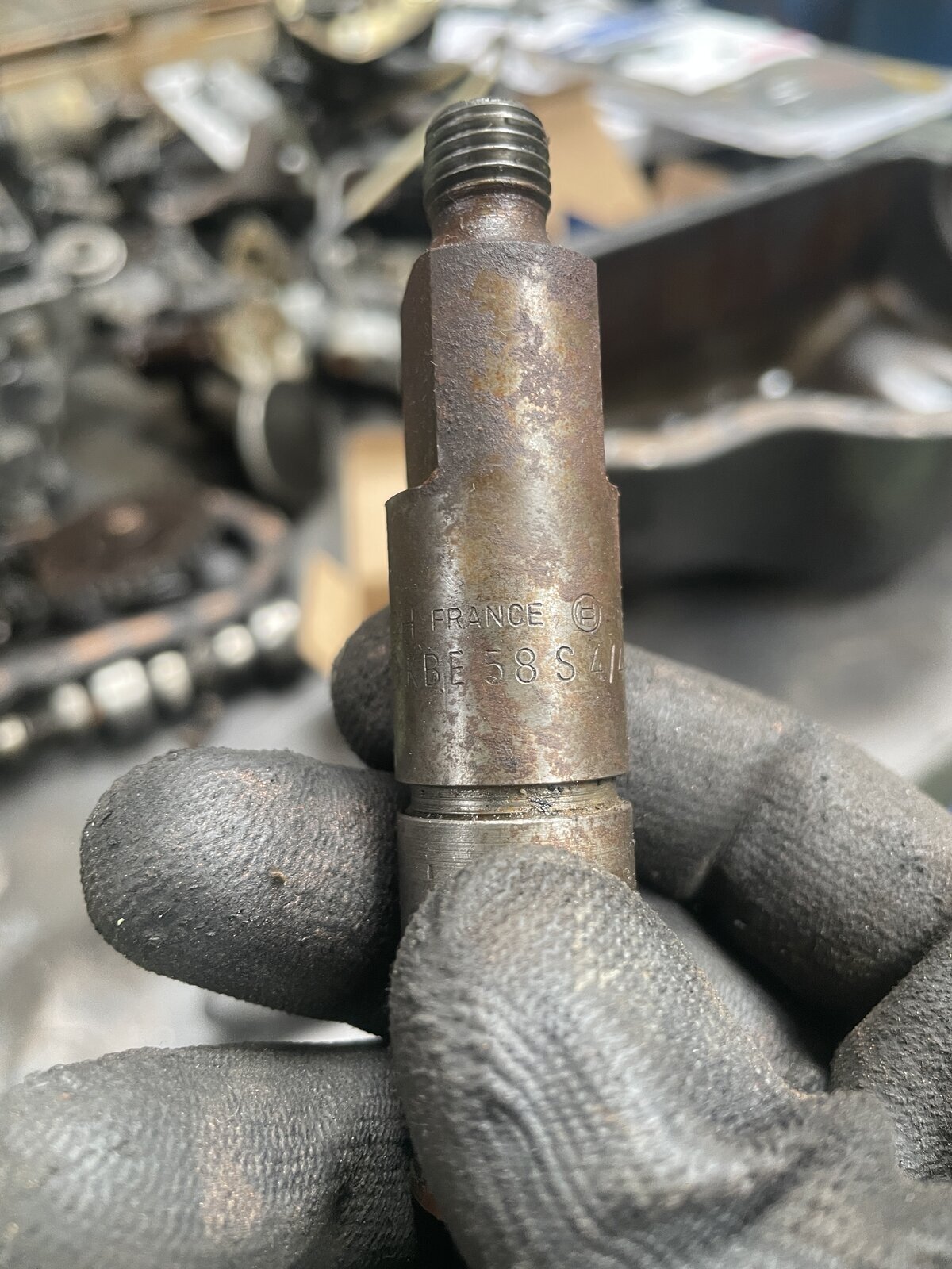

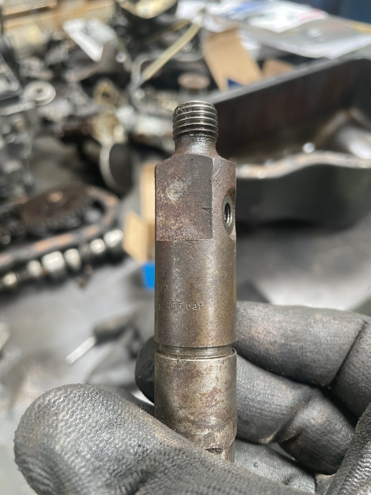

HI username , Wanted to ask if found injectores reconstruidos or a kit to rebuild? Your injectores look exactly like mine.
Bosch 937
KBE 58S4/4 155 bar
072
