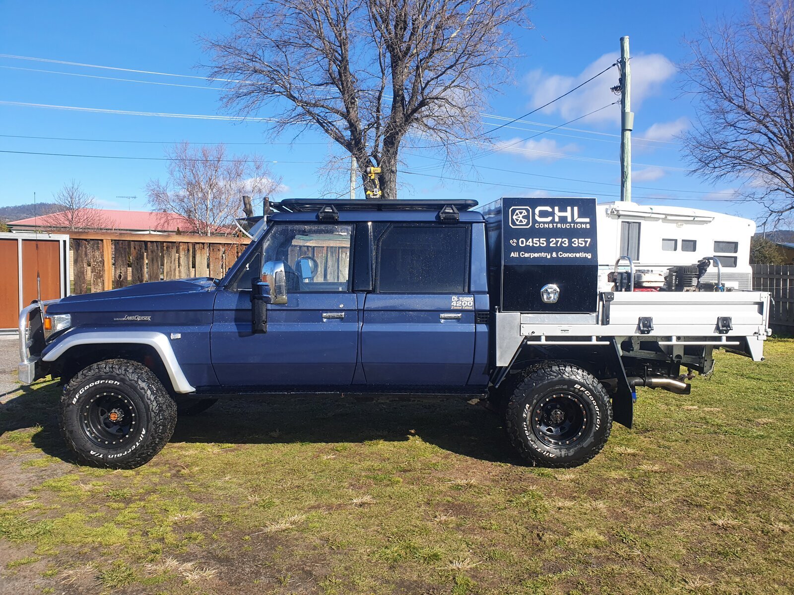

hi everyone thanks in advance for you advice.
I've got a 75series turned dualcab and a 1hdftm installed which makes 245hp 913nm. The i fully rebuild my 75series gearbox 27,000kms ago and it no good now.
So I have purchased a A442f hydraulic to go in her. But I believe my 75series transfer will not work with the auto (bolt up) am I correct? If so what would be the transfer case to use?
