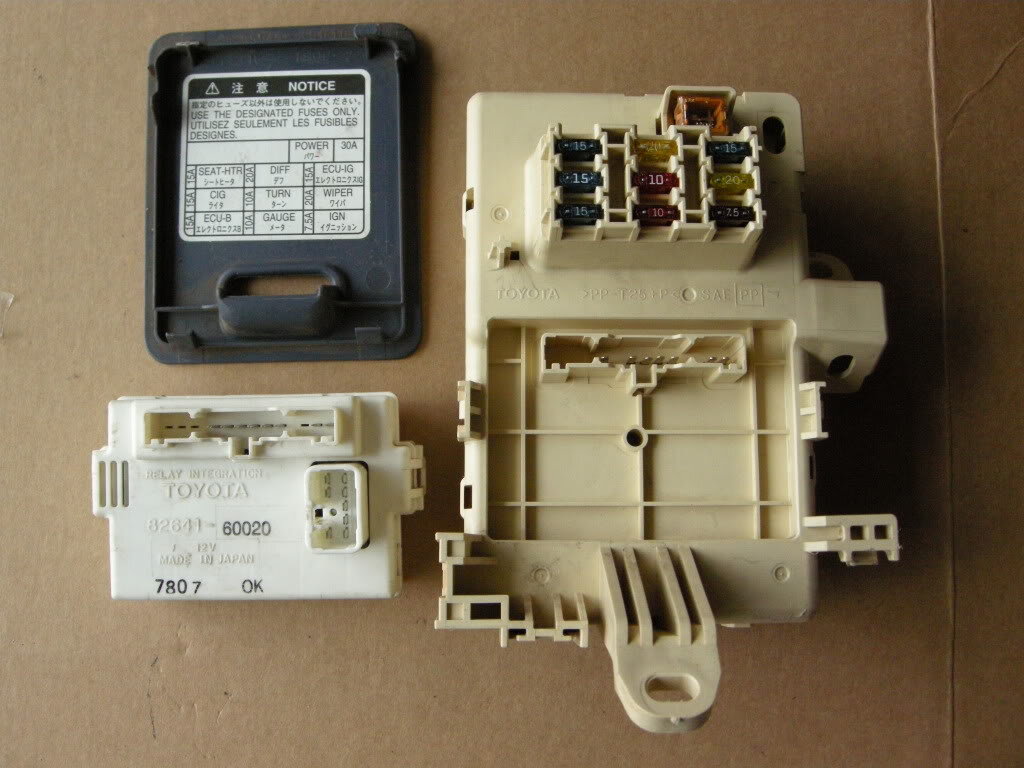

Start by checking the 20A 'Diff' fuse in the small fuse box by the driver's right knee:

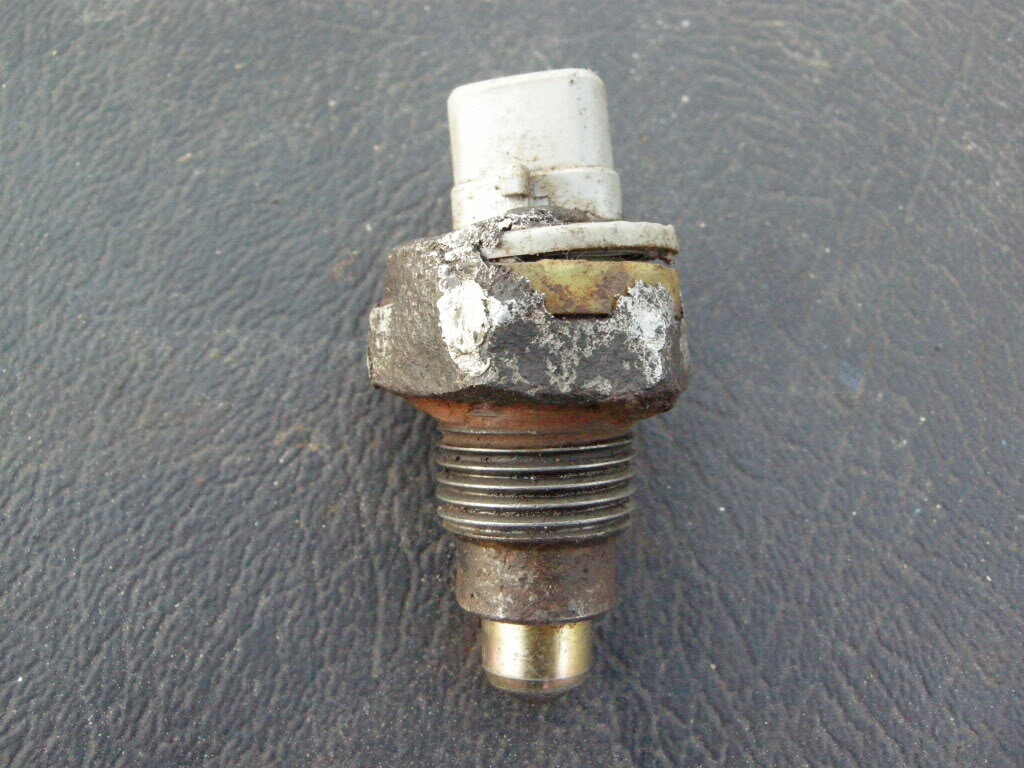

Also - check that the Detector Switch that sits in the Diff above the Locker is working - mine wasn't and had to be replaced.

Hi Bob, thanks for your kind help. all was ok and no faults found on plugs, sensor, actuator and fuse. I have got to the point where I am waiting for an auto spark to test the wiring between the switch and the diff. Plus everything in between. At least the spark will have an assistant, hopefully between the pair of us we'll get there.

Hi there all, We are having a bit of a battle trying to sort out the Diff lock on this one. I have a working one off Karl (thanks Karl), and the switch on the diff (or the sensor) is working. We have traced the wiring to a 4x4 control box behind the rear seat above the nearside wheel arch. So went on eBay and got a used one. And hey presto, no change.

Ok, happy to say that we finally have a result.
On top of the gearbox behind the gear lever there is a lock out switch, it was faulty and very difficult to get to, so it is now by passed.
The switch function stopped the diff lock being engaged in high ratio.
All working well now. Thanks to Bob for your input including the faulty switch position which, once tested, was easily fixed. Also Karl for sorting out the replacement diff lock and giving a live tutorial on the the wiring up..... and finally thanks to Flint for the Wiring diagram which was crucial in tracking the switch fault.
