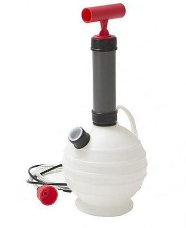

yep - as per Ben's experience as well - once you have it primed with another pump it will often keep going.
You could also use an oil extraction pump for this like the Pela 2000 - they're a good thing for removing oil/ fuel from many places
