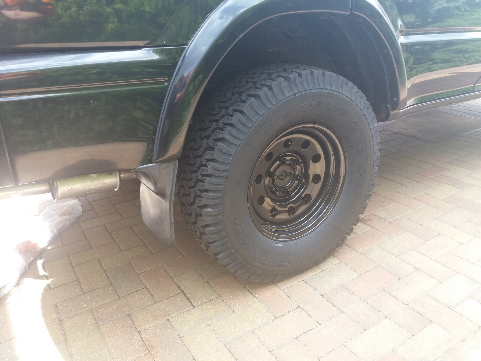

I got these from 4x4tryes.co.uk so you can gauge the look. These are 16x7"
Like i said i don't know the 70 series but i imagine these would be a pretty safe bet 16" x 8" Tuff Torque Modular Steel Black ET-35 - 4x4 Tyres - [Leaving Land Cruiser Club]
I got these from 4x4tyres.co.uk so you can gauge the look. AT tyres on 16x7". Hope it helps.

This is what your looking for 6x139.7 et25 , it seems very unlikely to me that you will find any factory alloys with a negative offset but the aftermarket choice is vast .
Regarding offset if we accept -25 is a minimum for clearance then even -35 is only 10mm difference of no importance .
