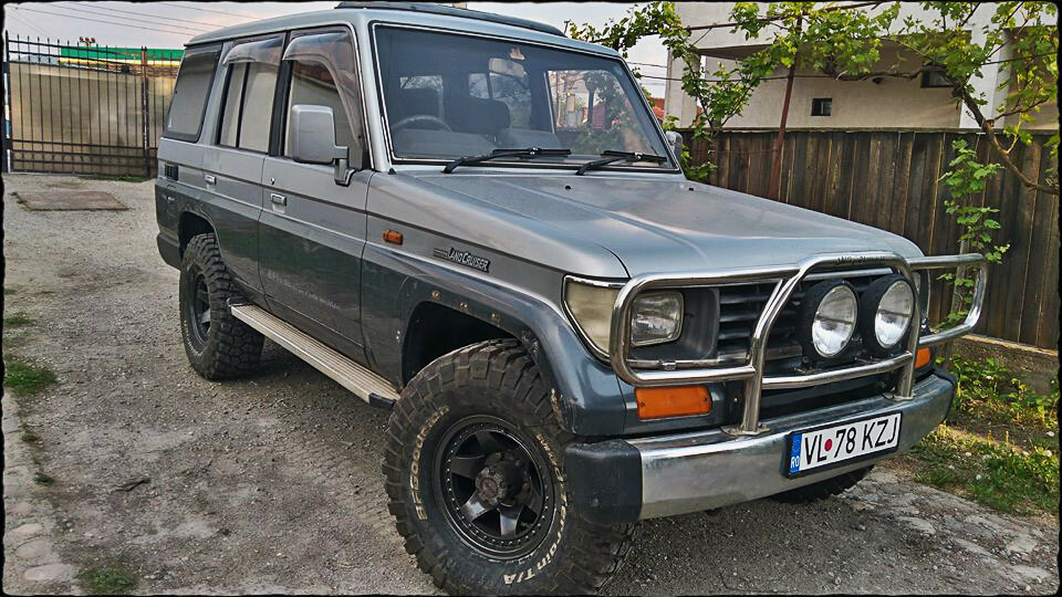

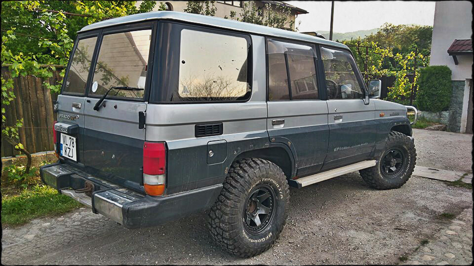

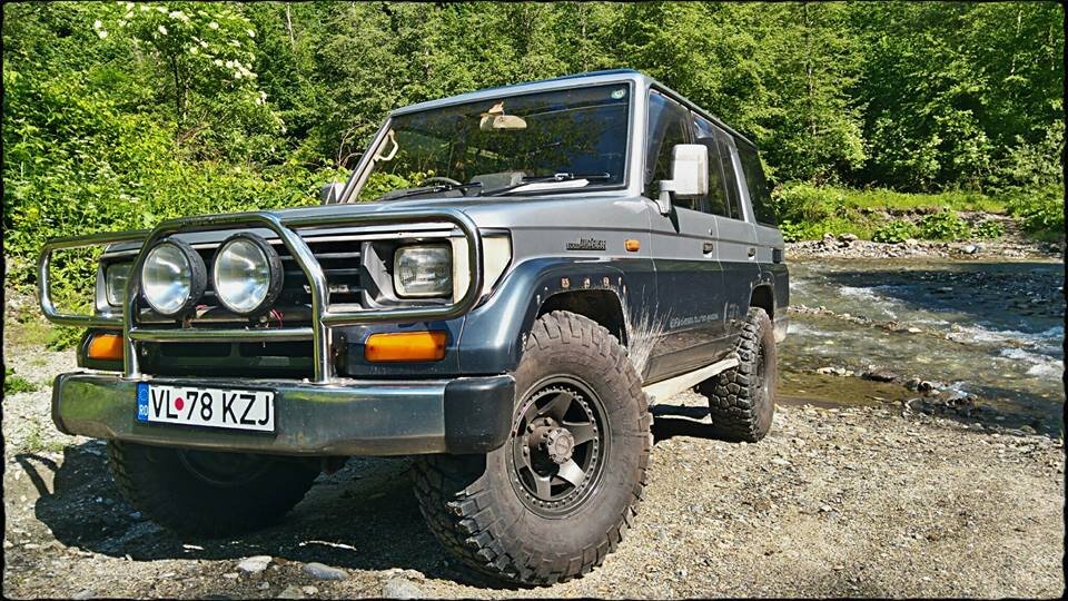

Just realised that I've never present my latest Toy here. It's a Land Cruiser LJ78 Prado SX, Winter spec, pretty stock, except the wheels (BFG 32/11.5/15 on some aftermarket alloys),
I have some big plans for it, including an engine swap, suspension lift, a winch and some "expedition setup".
I'll update the topic as soon as I'll start to modify it.

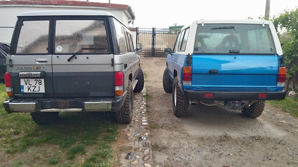

Hi, Ben! "Unfortunately" it's an auto and no rear factory diff lock, just the usual LSD.
I really like the auto, with all that negative points, that's why, if I'll swap the engine I will try to keep it. Maybe a torque converter look up will help.
Anyway, for the moment I plan to use it as it is. After a week it will be replaced by the Patrol until it will receive all the mods ...

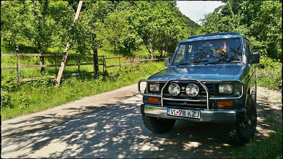

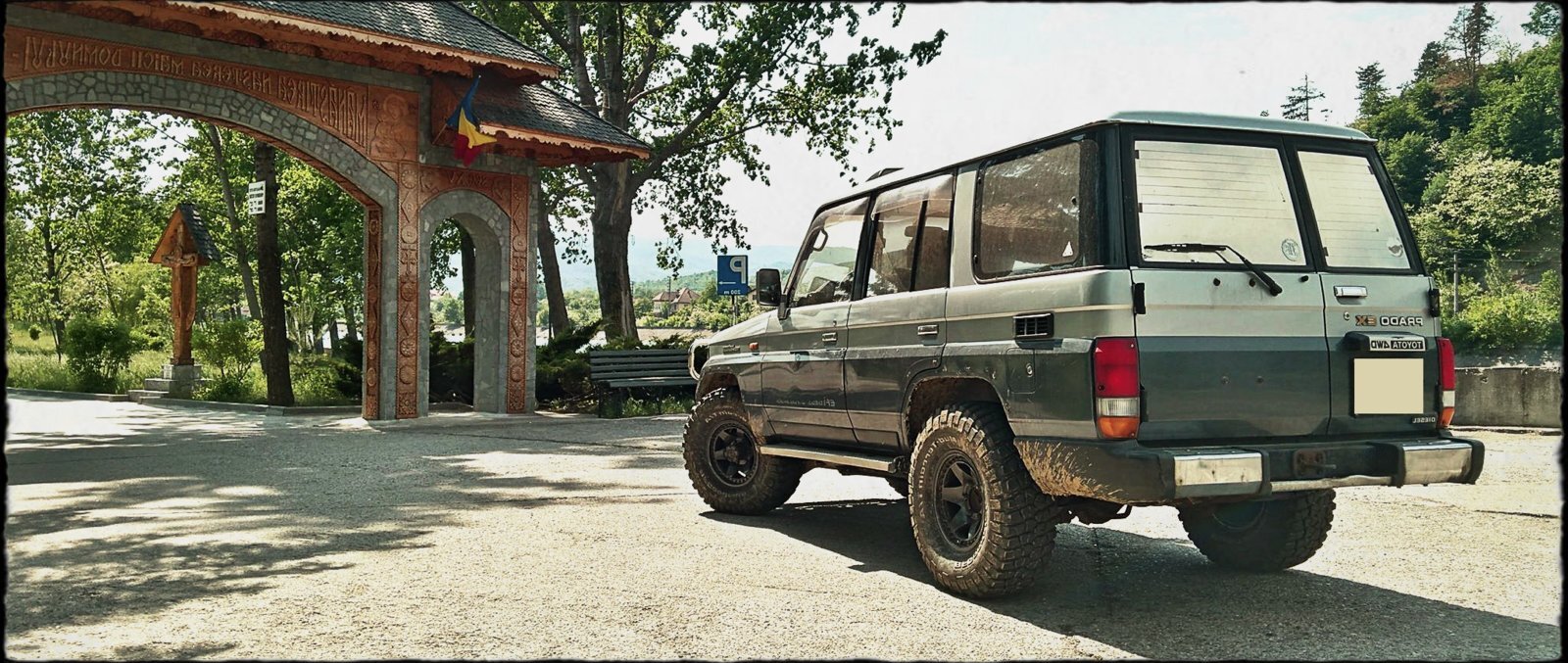

Few pics taken in a short trip last weekend:

You've got rid of the arches before the rust goes around the rivet holes there man! If you can get to the inside of the guards and seal up the removed rivet holes with a plate and sealant to fill the the holes, then you could well halt any further rust etc! I like your 78 man. My 78 has the exact same alloy wheels..
If you go for a 1kzt (e) conversion I've read previously that the 2lte loom does work the auto when you convert to 1kzte. Your best to do your own investigations. Failing that to convert to manual at the same time would give you great gearing with the larger tyres that you have!
Good luck with it bro!:thumbup:
