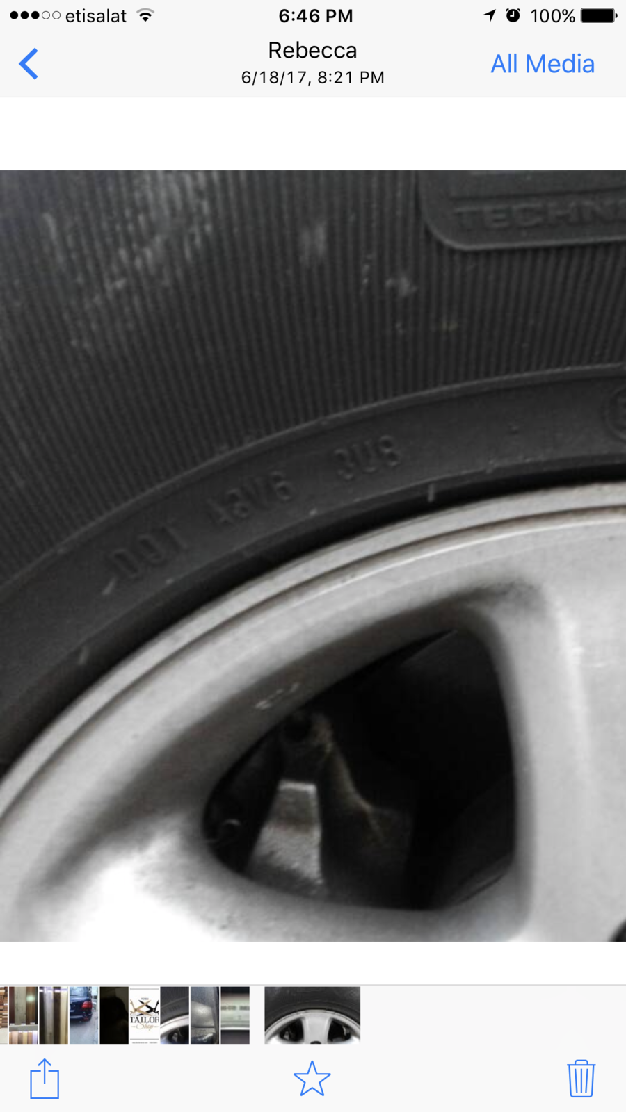

Hi Clive, those are my tires
mmmm, not really very helpful Jimmy, I was hoping for photos like this, so we can have an idea of the tread pattern, wear or anything that might be the cause of your problem ...
