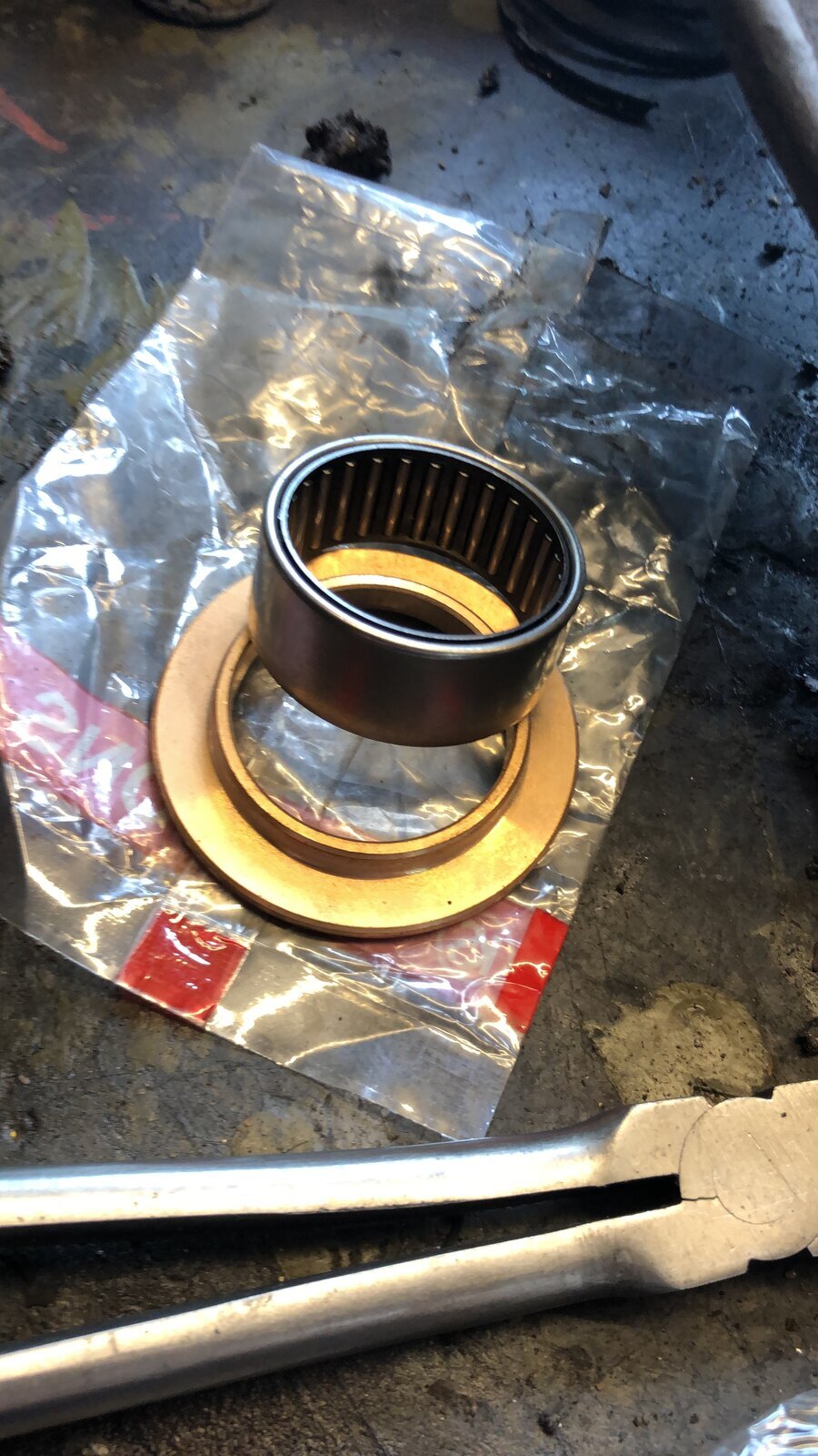

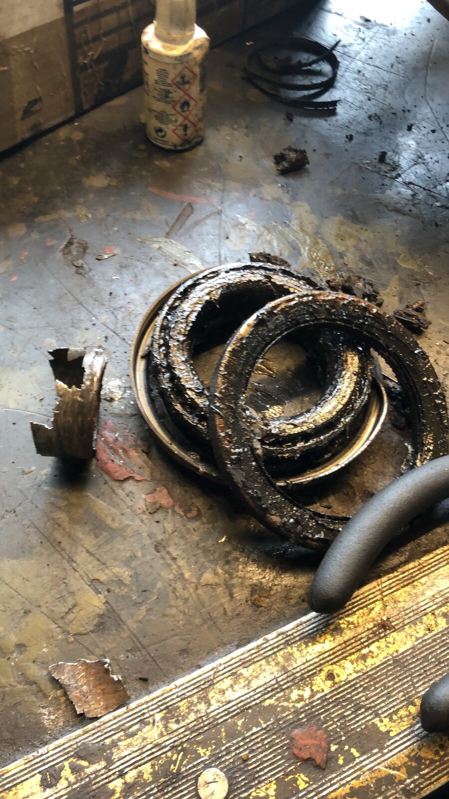

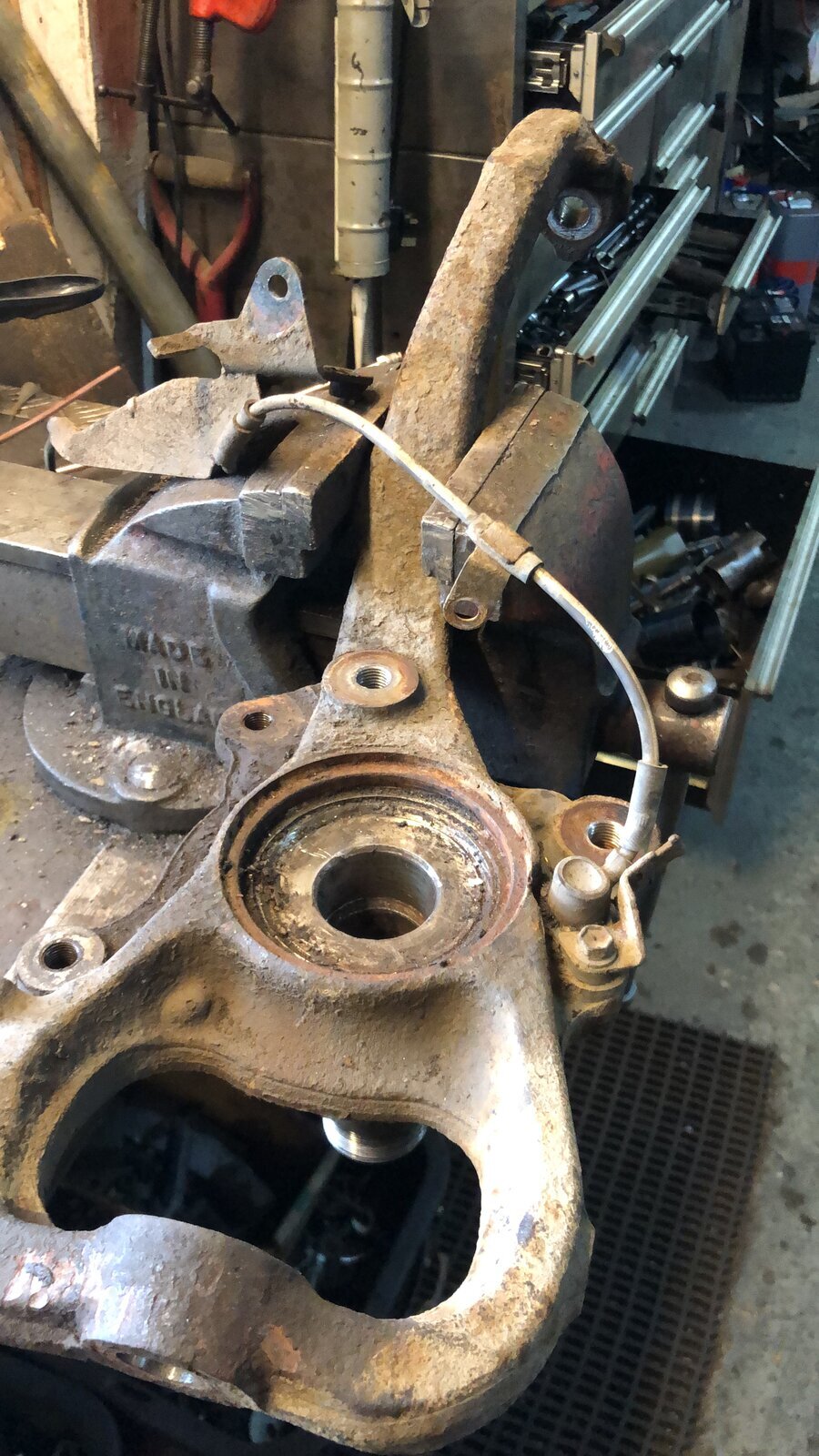

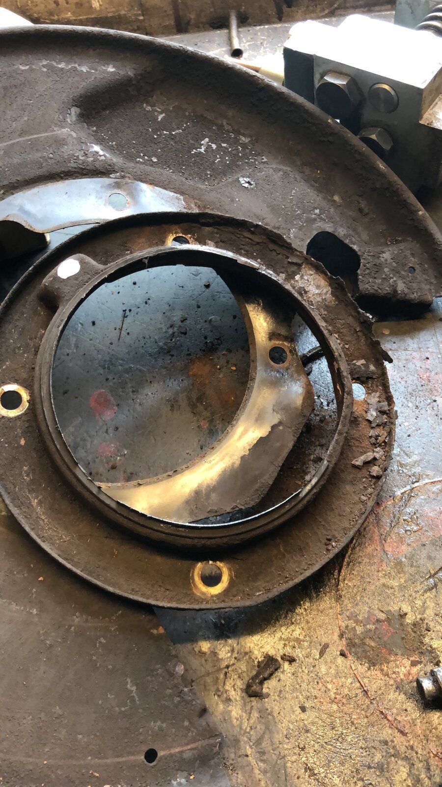

half way through rebuilding my Landcruiser front hubs, I had no idea there was a needle bearing that is in the hub, mine had disintegrated !
bet this is a part not many people keep greased !
if you have play int front shafts this I think will be your problem !
