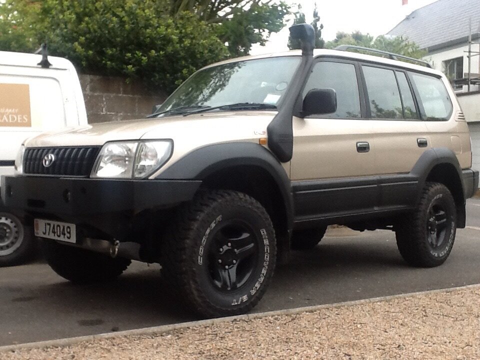

Arrived in about 7 days from Ramingo4x4 in Italy so thumbs up to them .
But be warned it is not a simple bolt on option .
The winch tray will bolt on fine but the bumper bolts to the tray which makes it 2 inches too low .
So i either make the chassis rails 2" longer and 2" taller or modify the tray brackets so much i may as well make new ones .
Instead i have decided to use the tray that was already fitted to my truck which is far stronger as it bolts in place of the factory recovery points and probably weld the bumper to it , lots of chopping and trimming and the powdercoat finish will be long gone before everything fits
