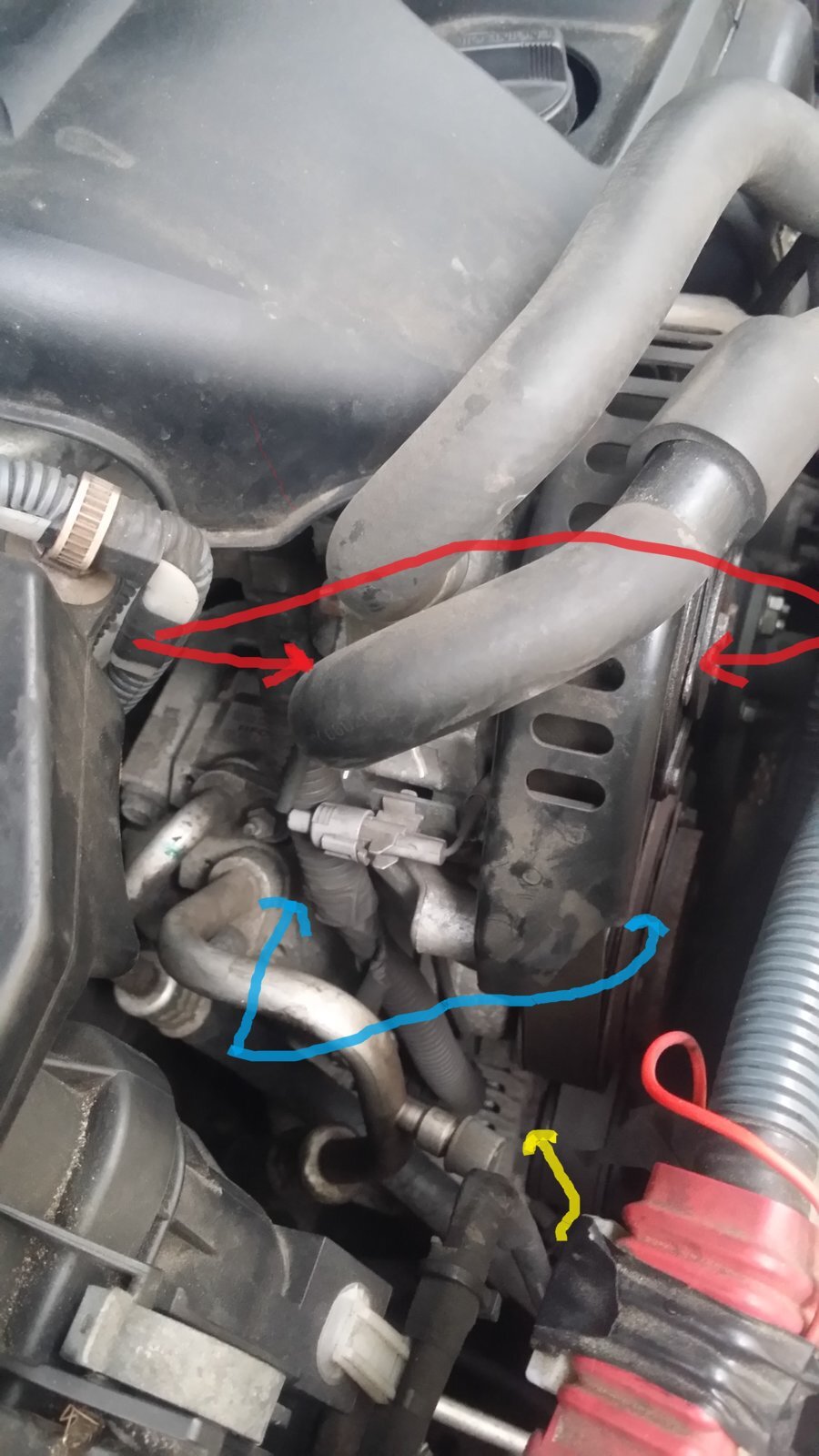

Don't think its the aircon pump. Tried to take photo as attached - the squeal seems to be coming from the pump marked with red arrows - it has connections to the water system. Just wondered what this is. Read somewhere this is a second water pump for 'extreme cold starts' and has some sort of magnetic pulley drive? Sounds a bit OTT - but intend to take off, examine and renew belt when weather a bit warmer [have to work outside :( ]
BTW if I have it correct right, the aircon I think is below - marked blue - and alternator yellow.

Sorry, I had it the wrong way round. You are correct. The red arrows show the Viscous Heater (part# 87120-35030). That should operate when you press the "PWR HEAT" button. The workshop manual shows adjustment of the clutch. If you DM me your email address I'll send you the instructions. I don't know if that would resolve any squealing though.

If you have the power heat / idle-up switch on does it squeal then or when it's off. When off there should be no load on that pulley other than from the belt.
When off the inner part to the pulley should not spin as the clutch is disengaged.
I had my pump bearing start going on the 120. It growled when the pump was working.
You cannot change the bearing itself with a Mr-T part - it's a complete pump. (Around £1500 with fitting IIRC)
That's not to say you cannot take it apart and buy another bearing when you get the part number.
