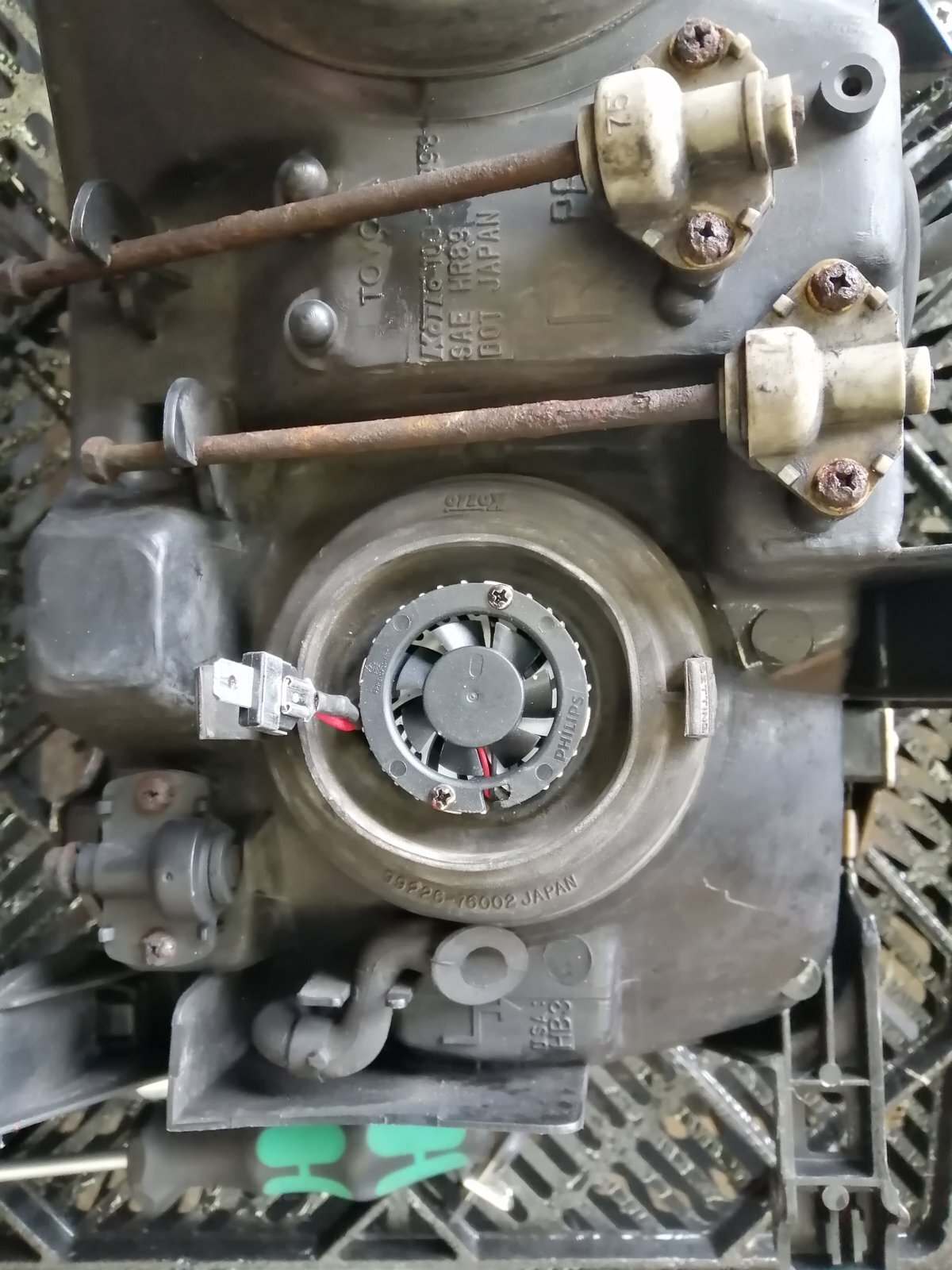

These are what I've fitted, built in fan etc and length about the same as a H4. Rubber boots fit on perfectly.
Fan being inside the light might even help to stop condensation

found time to Bob these in today.
They are the h1s, main beam.
Bit of a messy install tbh.
Had to cut the rubber boot. The driver is stuffed in the back of the lamp.
View attachment 162491 the connector to the 80s lighting loom just hangs there. Not as tidy as I would of liked, it is what it is...

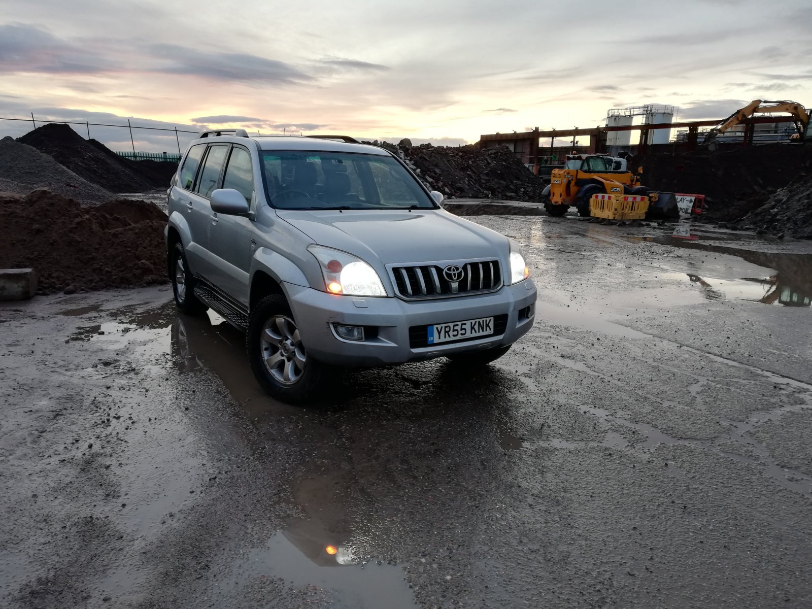

On the plus side they are much brighter and have a longer reach than the halogens.
There he is, see him?
