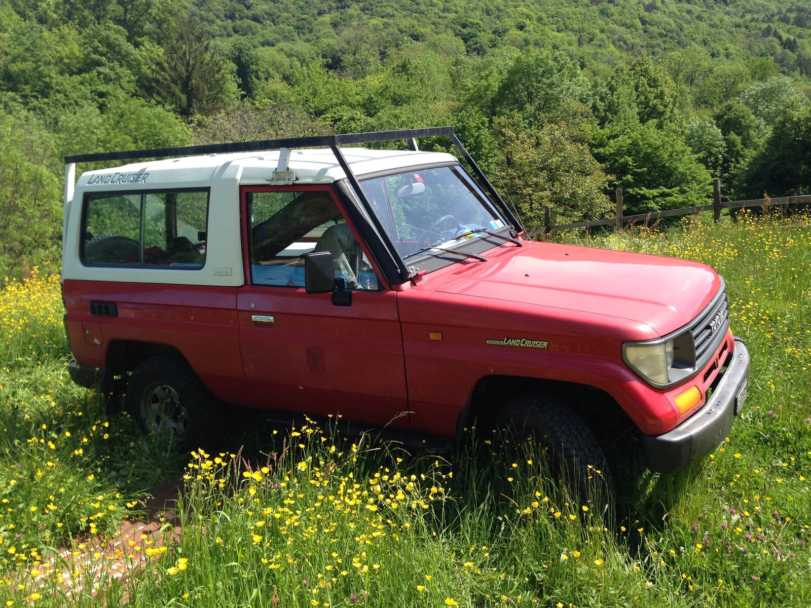

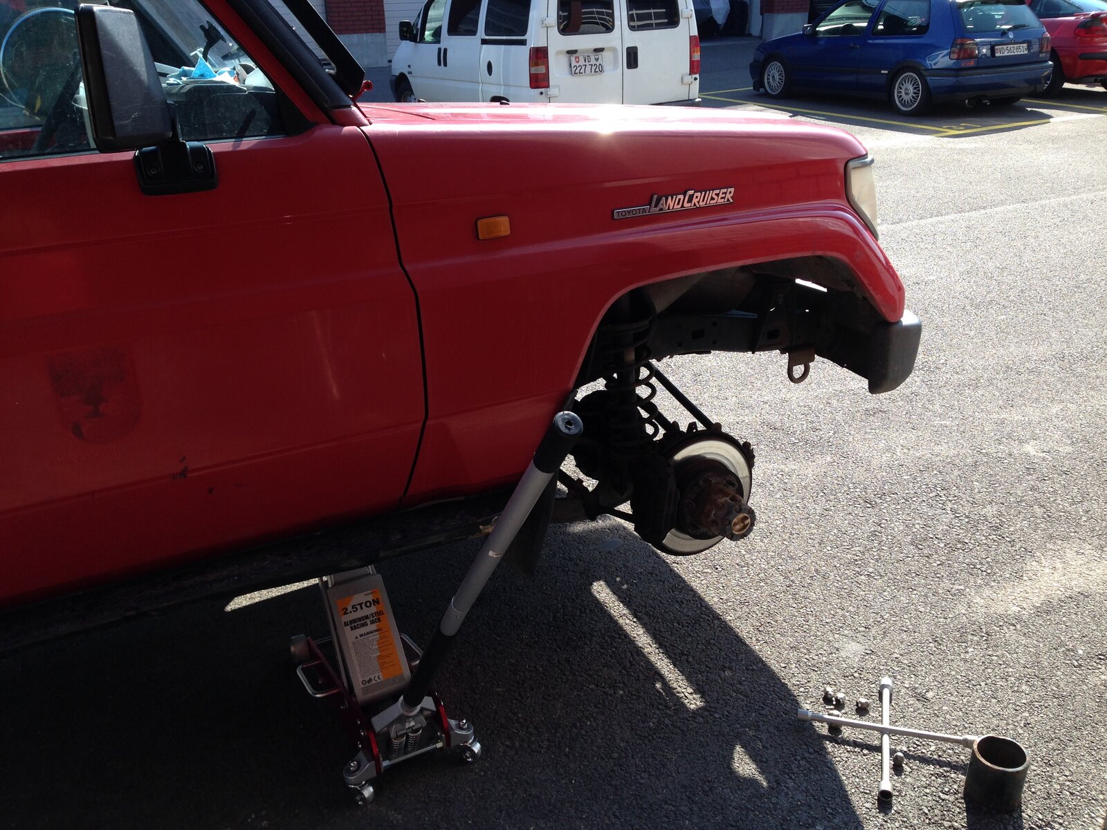

My truck is a RJ 73 LV-MNEW FRP-Top. Don't think I have extended arches... I've added some pictures below.

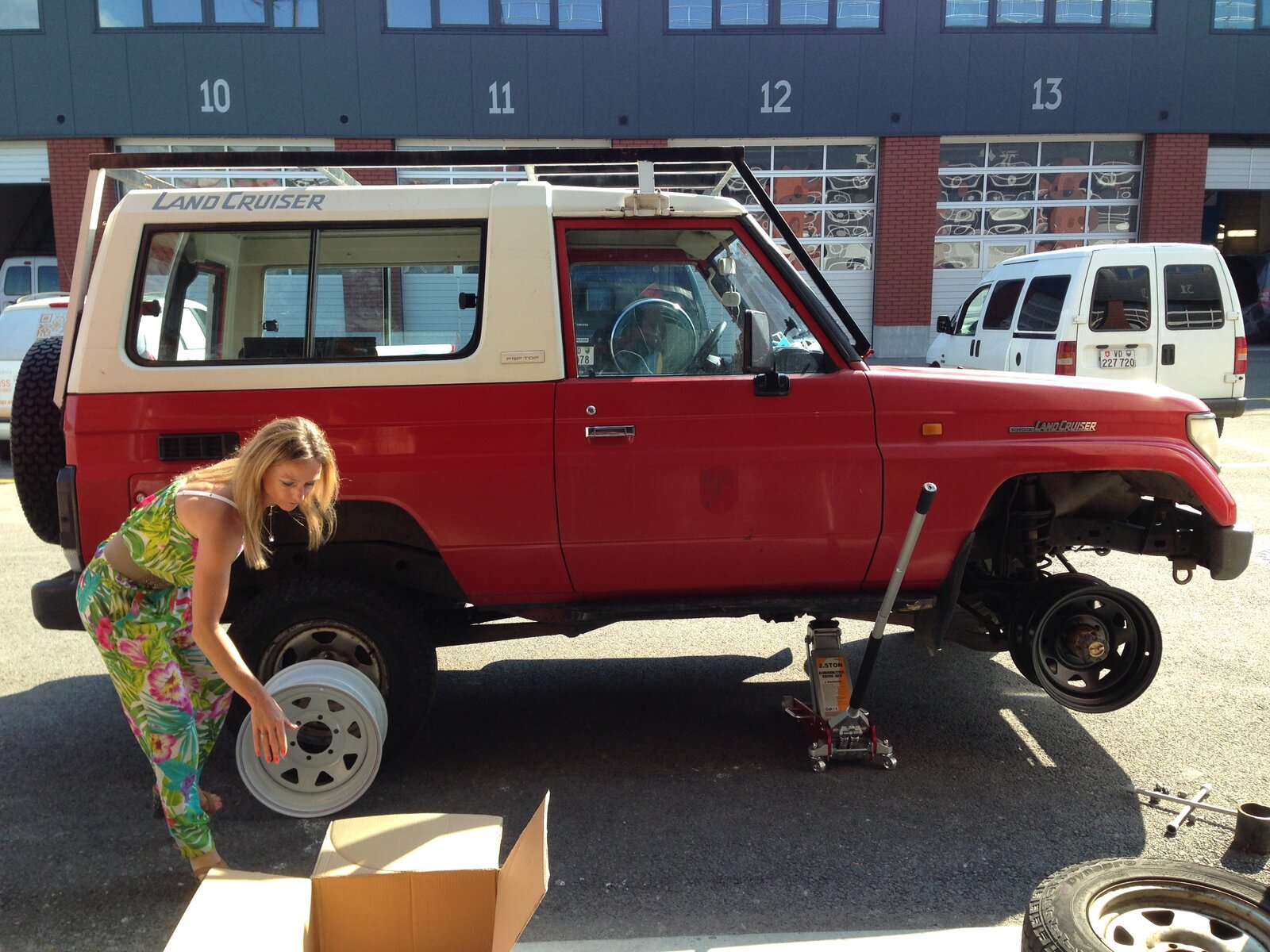

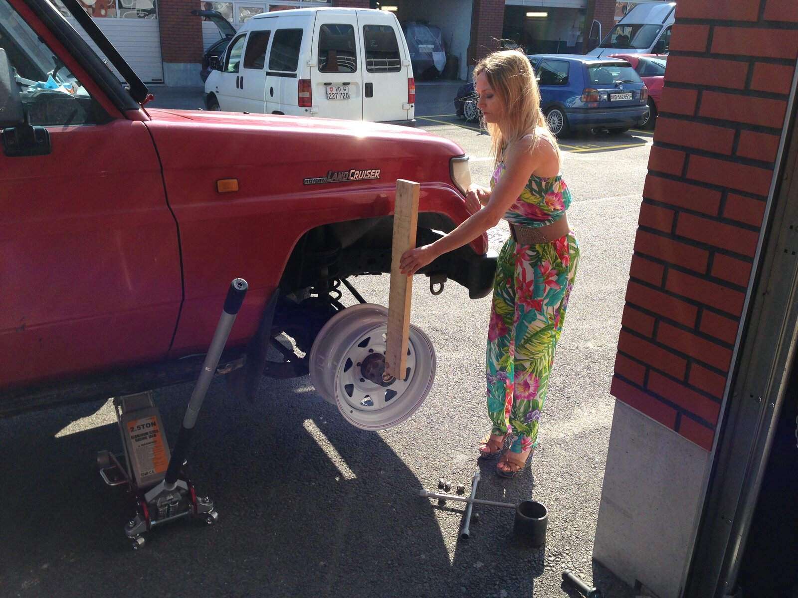

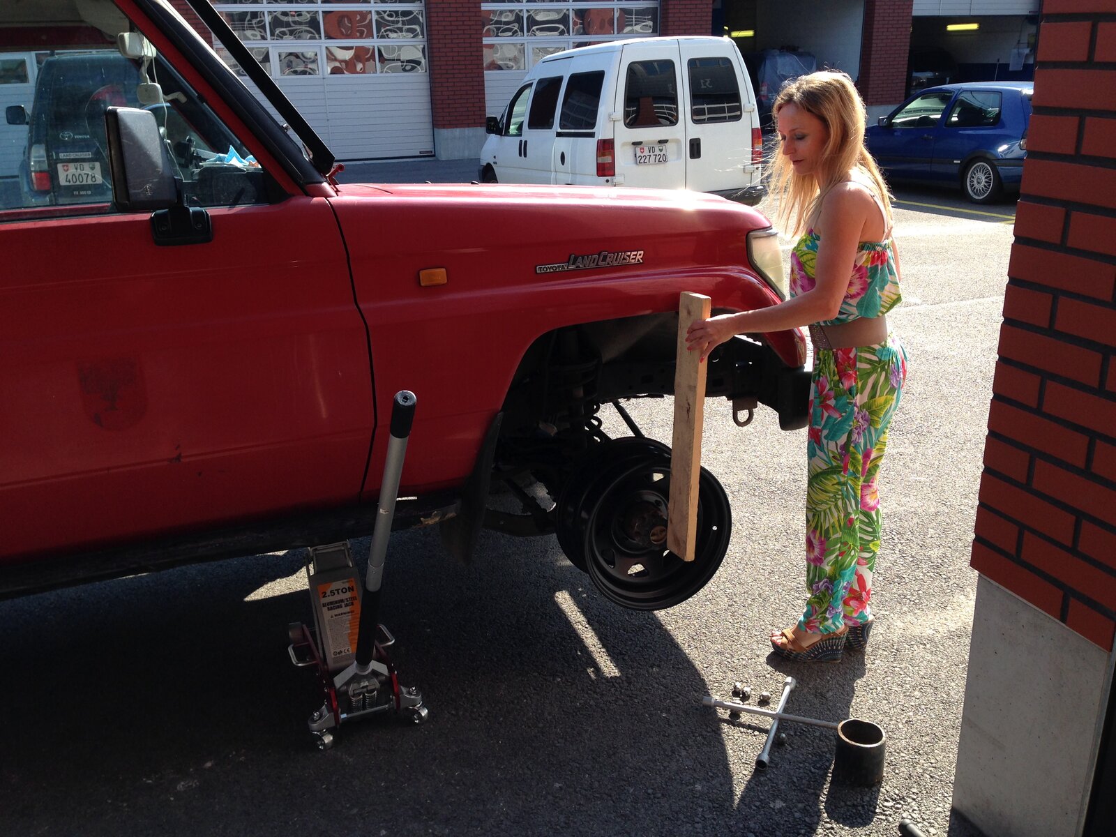

Bought some wheels from here:
http://www.accessoires4x4.ch/20-jante-acier-4x4-triangular-soft8-dwindow
They were really helpful... I went to the shop to speak to the, and the woman there helped me try a few wheels out, to see what the overhang was like. She was incredibly knowledgable, and has (I think 4) landcruisers herself, including one which is permanently stationed in Jo'burg, so when she goes overlanding (which she does about once a year) she has one there ready...

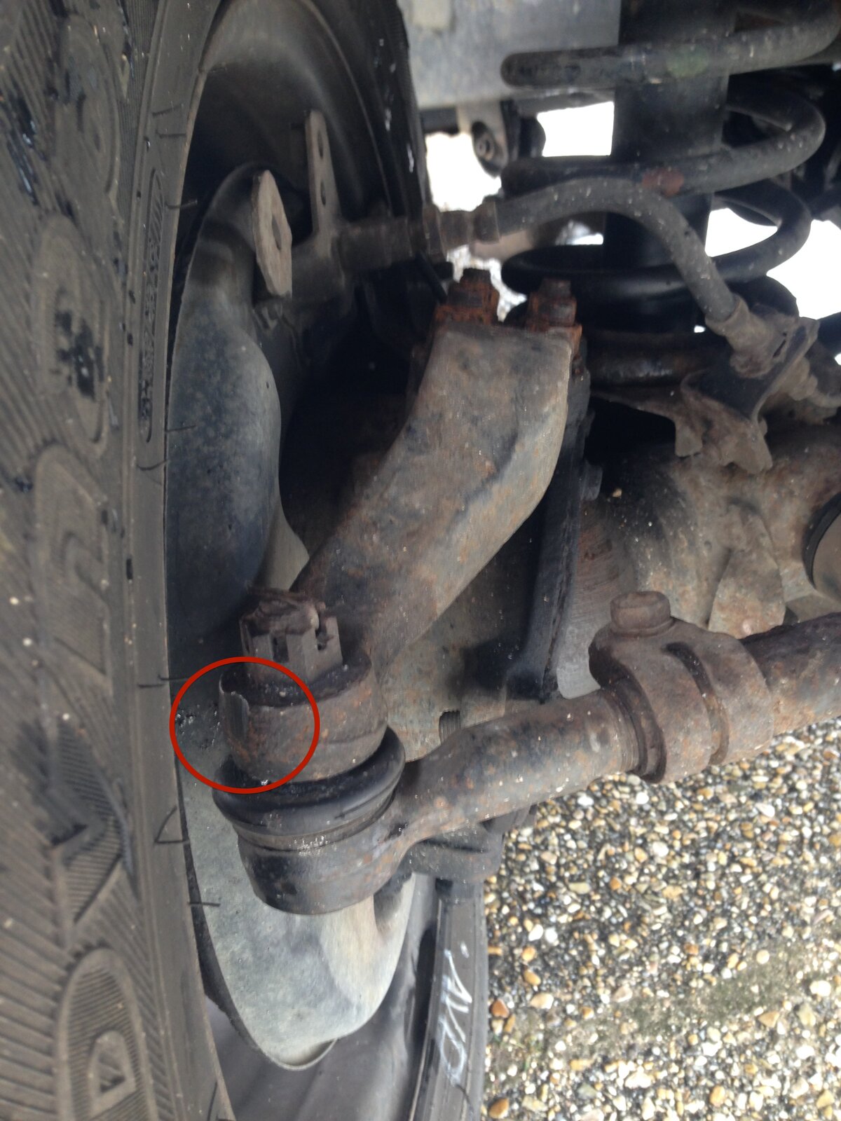

The wheels don't fit! :-(
The tyre place said it all seemed fine, but when he drove the truck out there was a terrible noise and he so took them off again. One wheel is badly scraped on the back, and in the picture below you can see the damage done to the tie rod (which I'm thinking I don't really need to worry about). He said some spacers (3mm) should allow the wheel to fit ... would these be okay do you think?
http://www.euro4x4parts.com/parts/pev4019-2134_wheel_spacer_6_mm.html
Just an update on this - the spacer did the job and I'm pretty happy with how the old lady looks now (will dig out some photos). Best of all, the improvement in grip in the wet and snow is amazing! Very happy.
