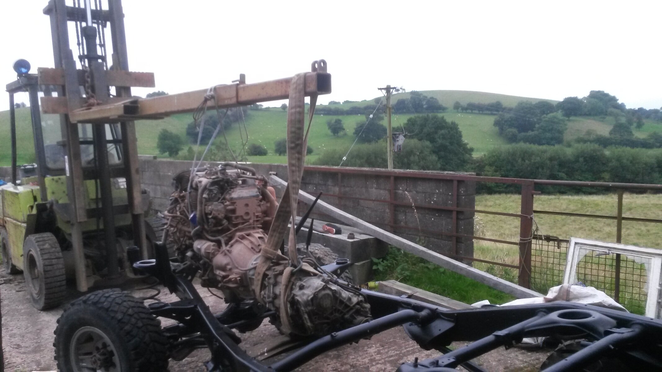

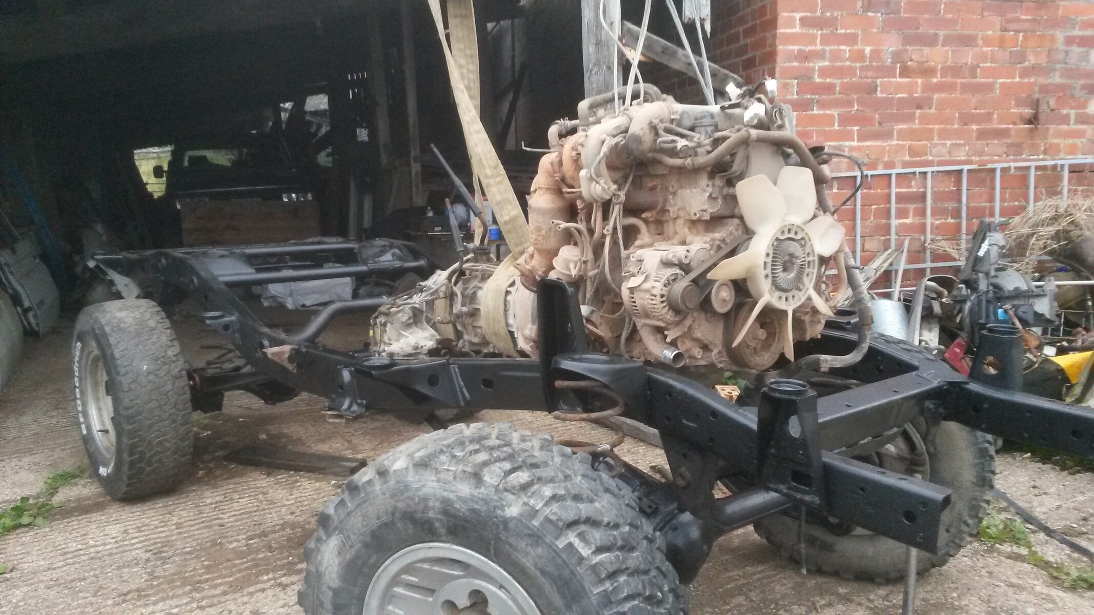

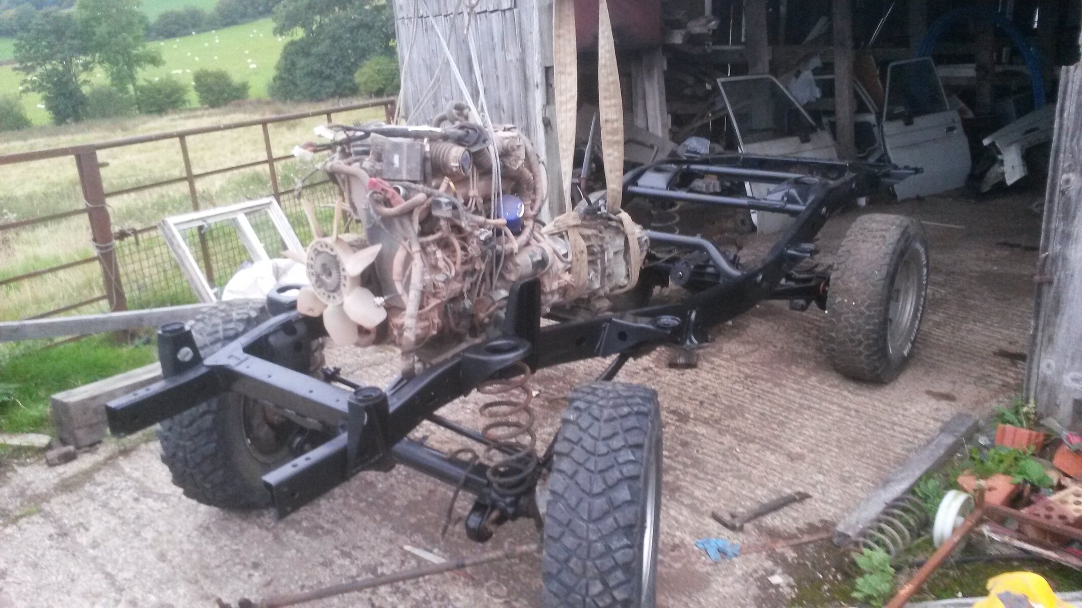

Had another quick hit to the project after work tonight..

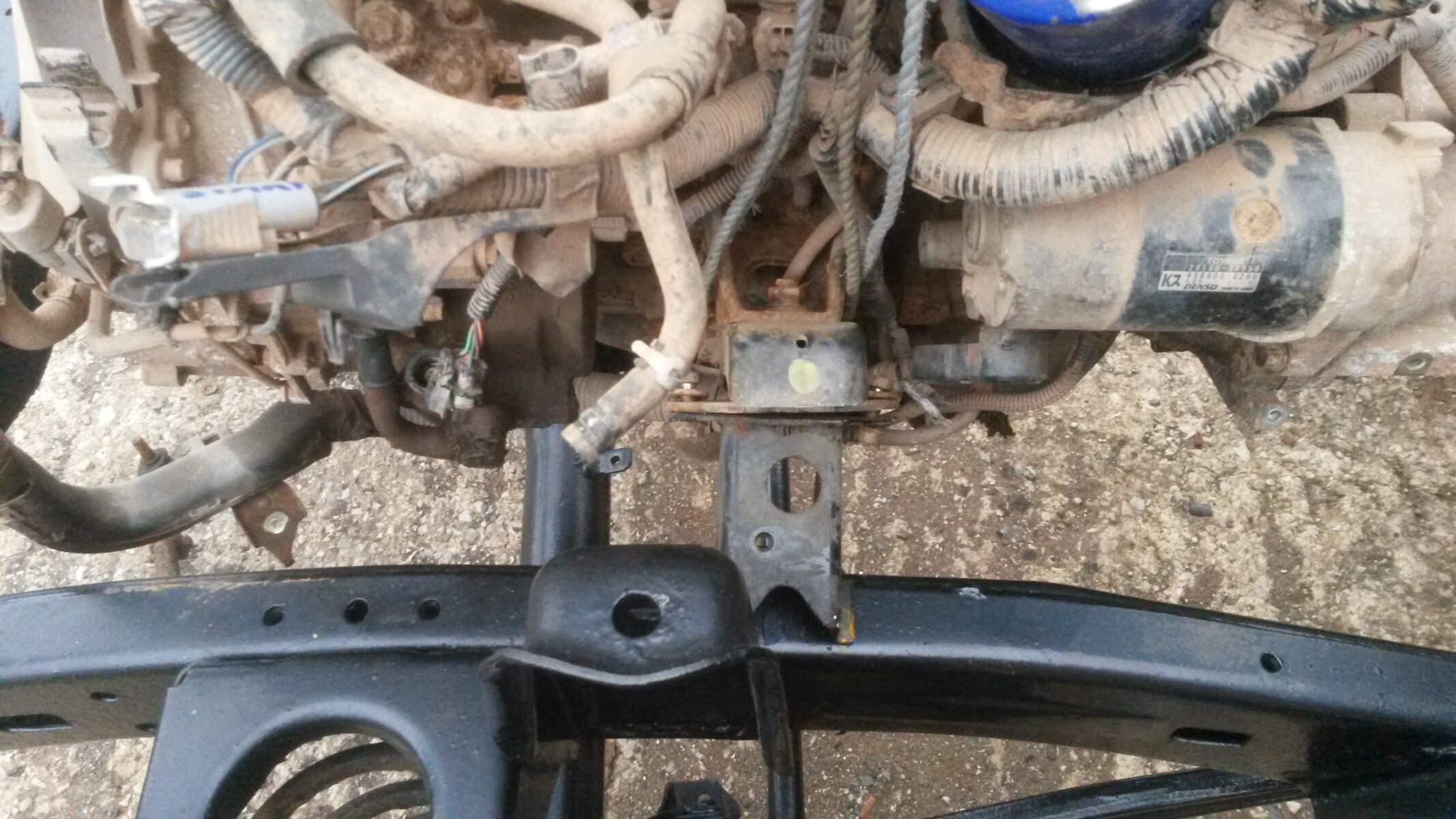

Quite a standard procedure!:icon-eek::icon-cool: Dropped in quite easy, scratched my chassis paint a bit here and there. Didn't break anything!!:icon-biggrin:
Toyota have changed the spacings on the engine mounts from 1988 to 2004. A bit of attention needed there.
It is definatly a hefty looking old lump now its on the chassis. Sitting at the set height of a 2lt on the mounts, looking at the viscous fan I'd say it needs to lower at least 30-40mm to get it vertical. Was happy to see that the 80 series springs have dropped by at least 50mm with the added weight!:icon-biggrin:
Thinking that I need to put the body on before welding the engine mounts on and dry fit the wings, bonnet and front panel. Pretty sure that the bonnet will not shut as it stands. Luckily can do a measure up off Matts 1kzt'd lj70!:think:

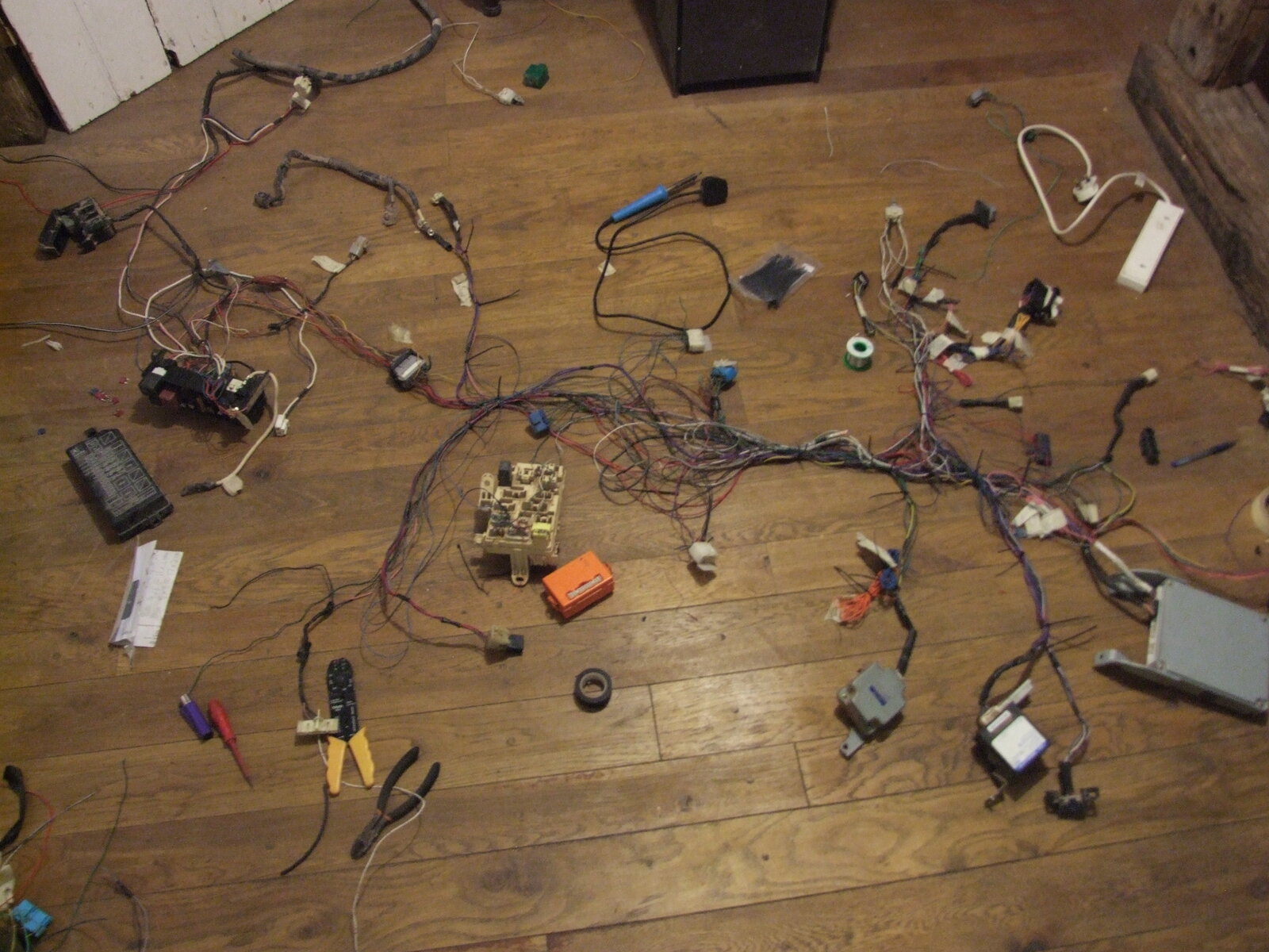

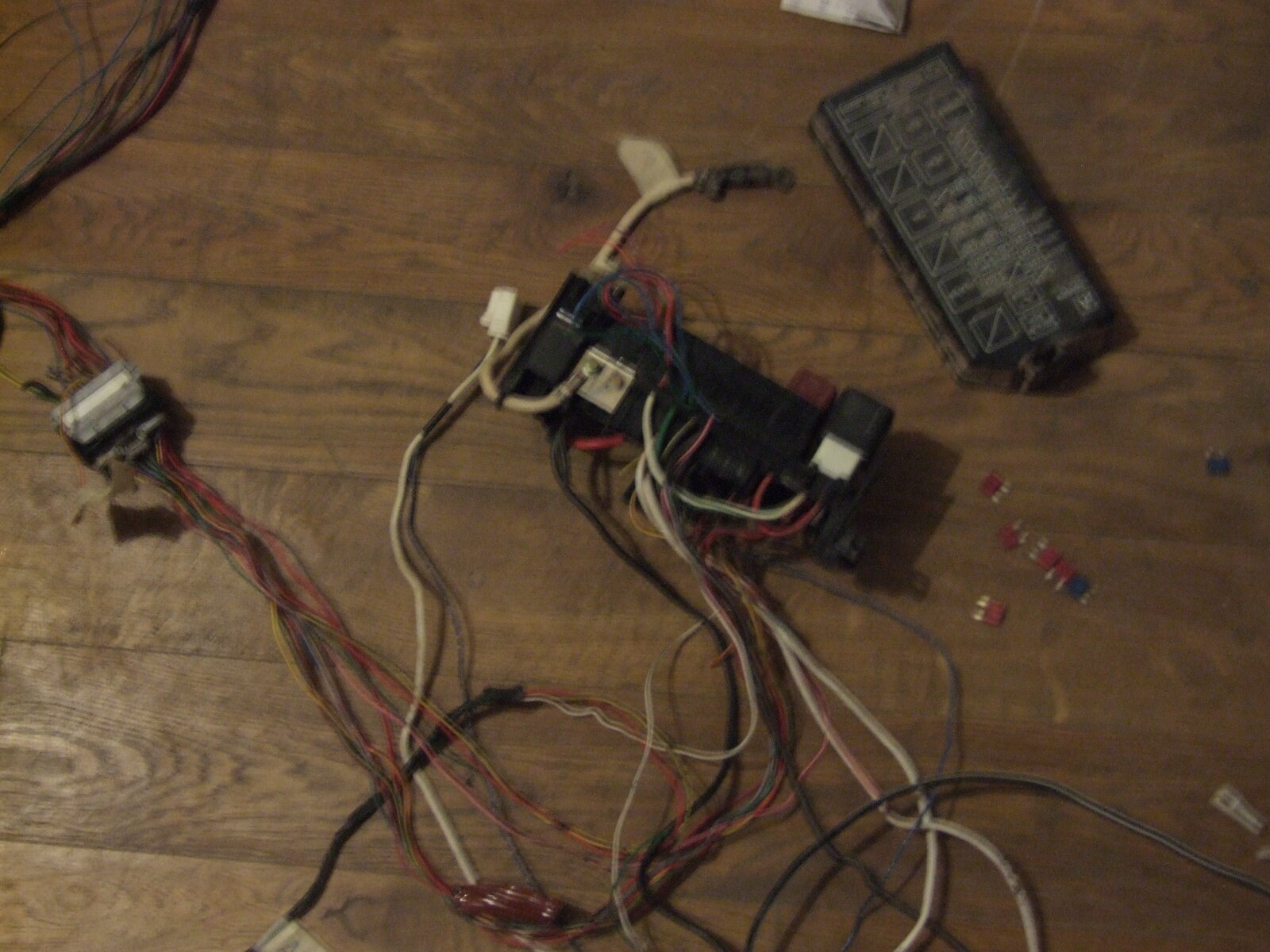

Loom work..
Had another hit on setting up the vehicle loom today..

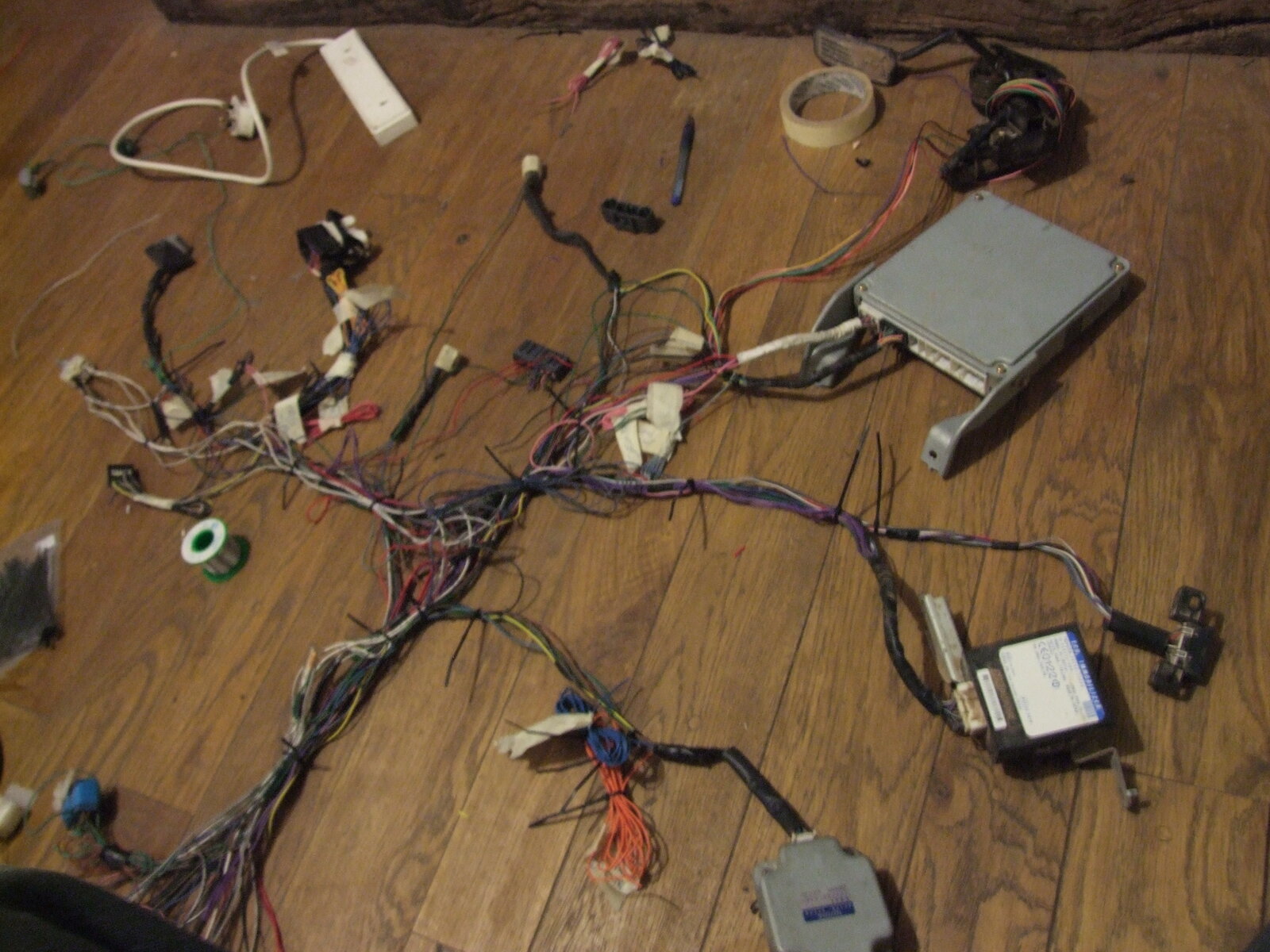

Makes so much more sense to lay it all out and work on it on the flat. A fair bit of cutting and soldering back then finish with heat shrink. Something satisfying about getting it in order instead of it being a right rats nest!
Opted to keep the immobiliser for now as originally I was thinking it was going to make the job impossible. I have retraced my last moves/cuts from after I heard it run last. Am going to look into if it's possible to fit the hilux ignition barrel into the cruiser. Then the immobiliser wiring will work fine then????

I have stripped out the fuse box leaving the ignition system, glow plug relay, charging circuit and then running from that is the power for the ecu etc. So really I am going to fit this in the lj70 and wire the truck to this. (some how!).
Have traced all the wires from the dash unit and now have the wires for the instrument panel marked out.
Tomorow I have a bit of finishing off on the loom then fit! Fingers crossed, it will be running again!
Funny this wiring job, there's always a feeling that it wount work!!:think:
Regarding the Ignition wiring and Immobiliser, I believe that they're paired aren't they and will only work with the vehicle it came off? I could be totally wrong but believe a guy who swapped his 1KZ for the D4D had the same problem. You might want to look into that and make sure it'll work with the Hilux ignition barrel.
