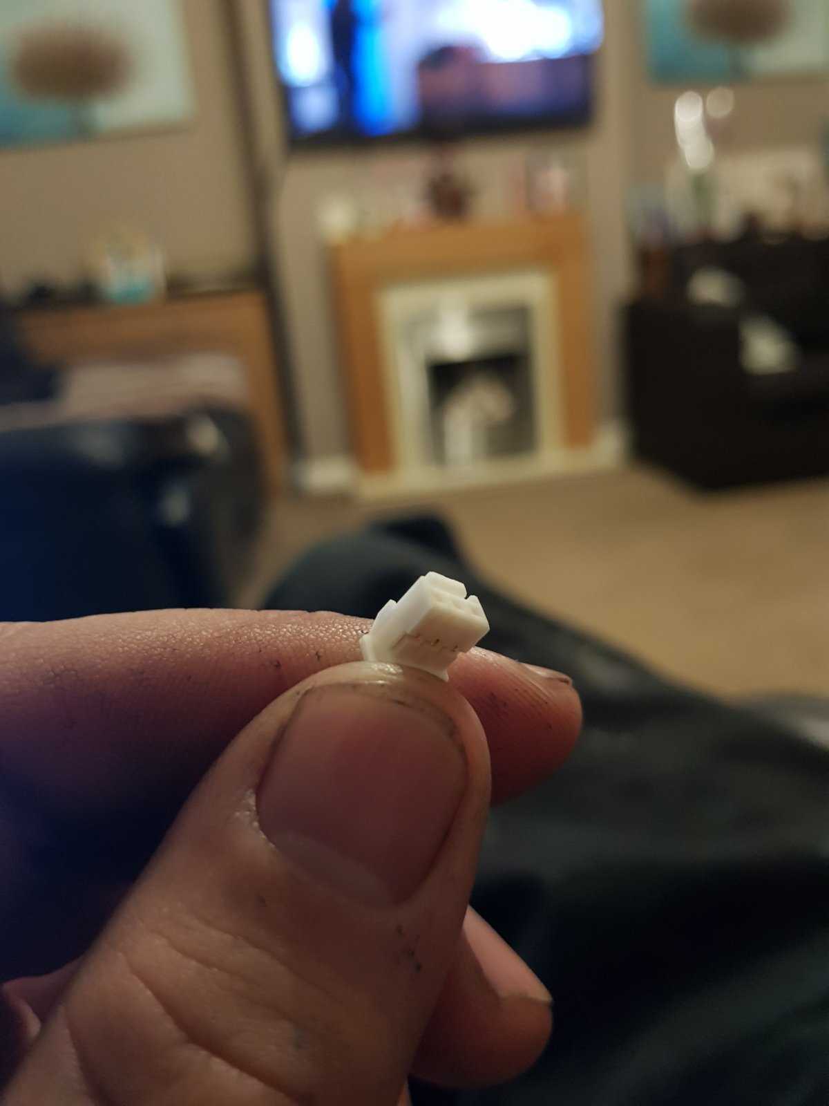

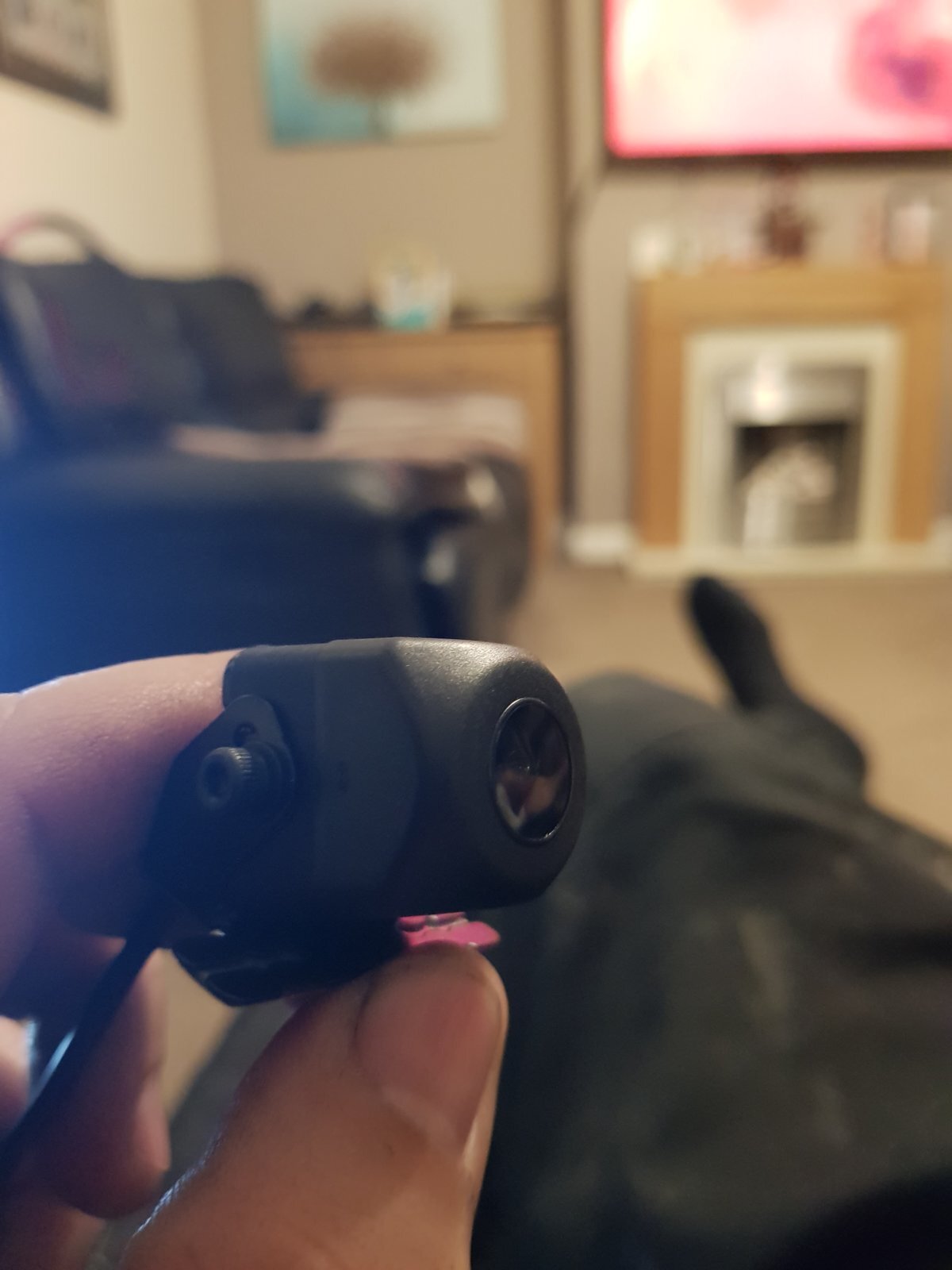

So I thought why not bring it up to date and install a rear view camera.

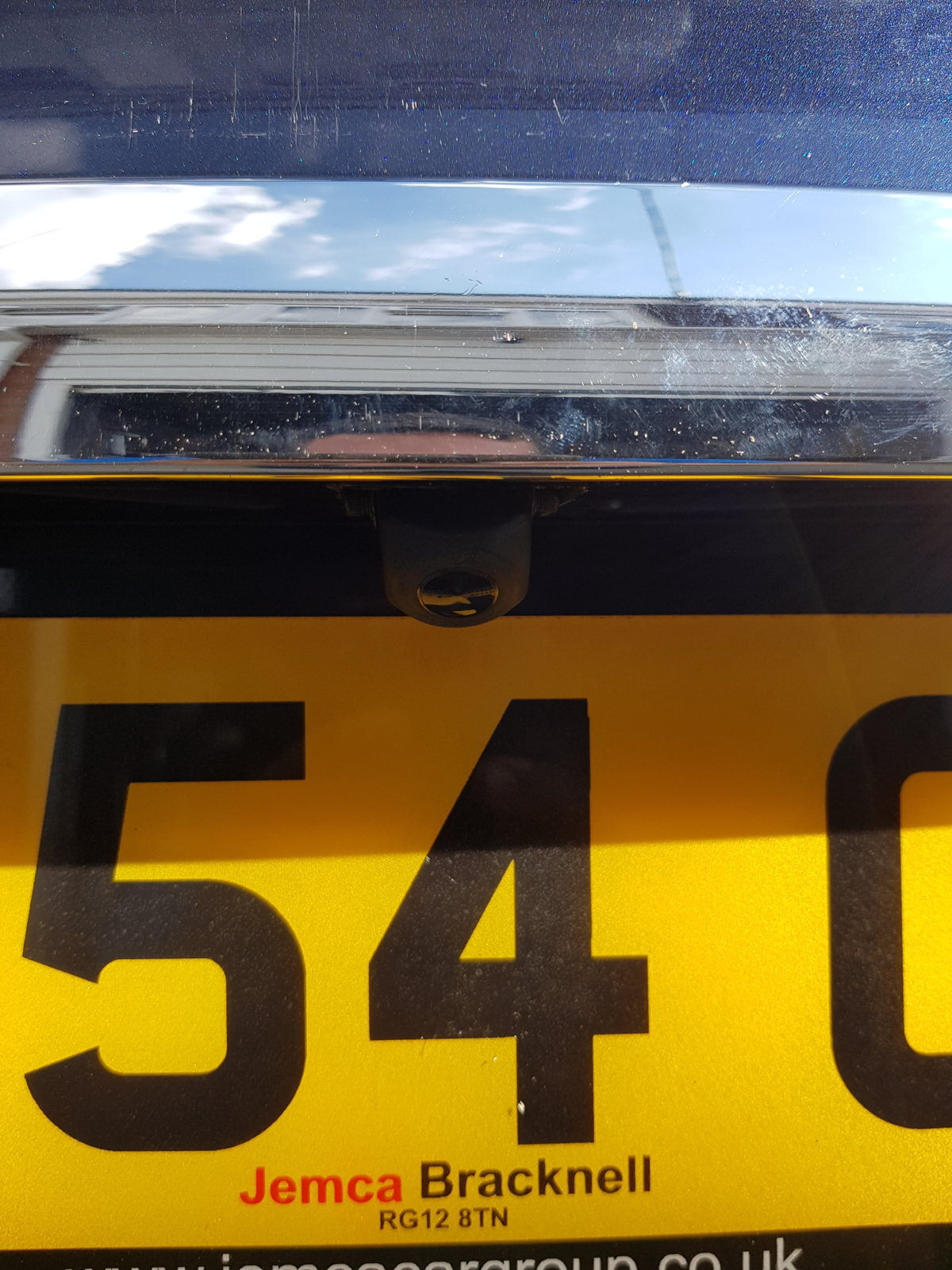

I plan to install it next to the number plate light and try to get it looking as factory fit as possible.
It has a nice small plug so should be able to pass the wiring through the rubber boot on the back door.

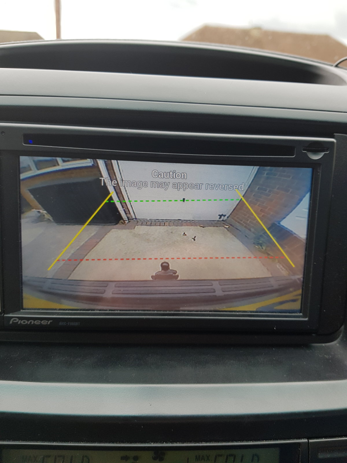

Same as mine, very easy to fit although had to wire up direct to a battery as rest of car is 24V.
Very clear especially in darkness being infrared.

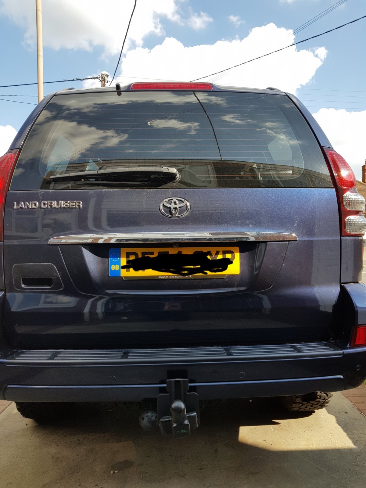

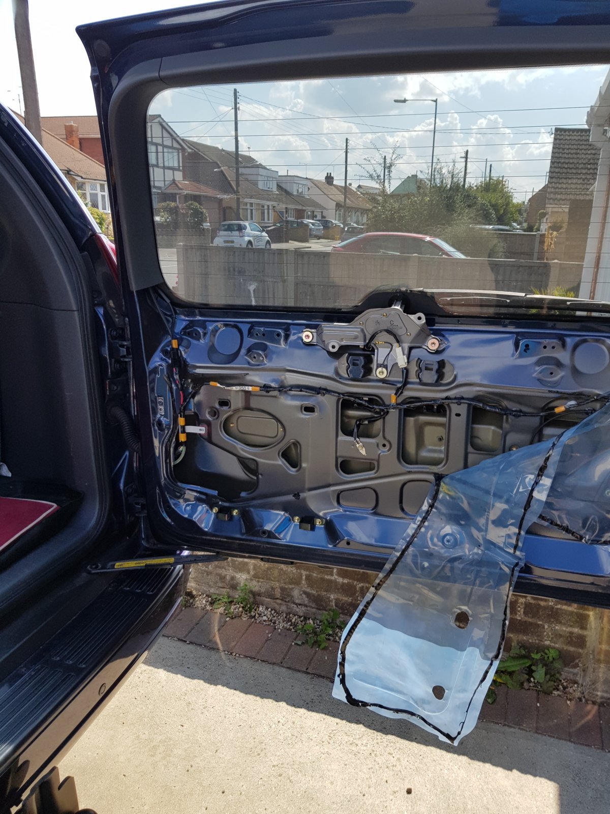

Finished work early today so got the camera fitted on the back door and got the wiring through the rubber boot into the rear quarter. Hopefully I can finish it sometime over the weekend.
