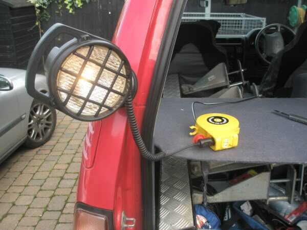

........I was on the cusp of buying myself a LightForce magnetic base work light http://www.lightforce.net.au/products/p ... yworklight for the sum of £65+P&P :shock:
When I remembered that I had an old/unused CB magmount in the shed & I got to thinking about buying a work light from off of the bay & fixing it to my old mag mount viewtopic.php?f=53&t=8636 :)
So after a bit of a trawl I came up with this Wipac work light for £11.99 free P&P :)
http://cgi.ebay.co.uk/ws/eBayISAPI.dll? ... K:MEWNX:IT

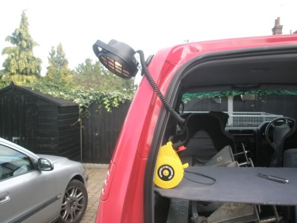

:cool: :cool: :cool: :D It turned up today so I did this to it :D
Found an old curly cable with a cig lighter plug on one end :thumbup: It used to be for a rechargable tourch that has long since died :)
Poped it all together :)
And hey presto :D :thumbup:
It even fits nicely in my cetre console ready for action :D :D :D
So one work light for just £11.99 :D A saving of @least £55 :dance: :dance:

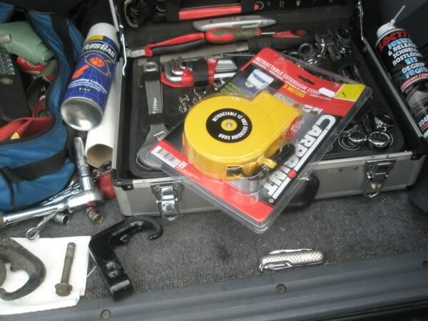

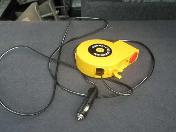

It gets better :D IMO :D ;) Found myself down the town this morning in the Motor Factors after having had a hair cut & I bought this 3meter 5Amp 12volt extension reel for £9.99 :D

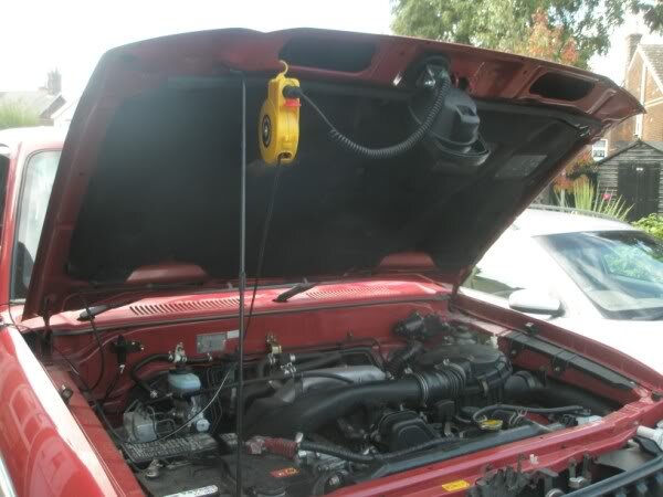

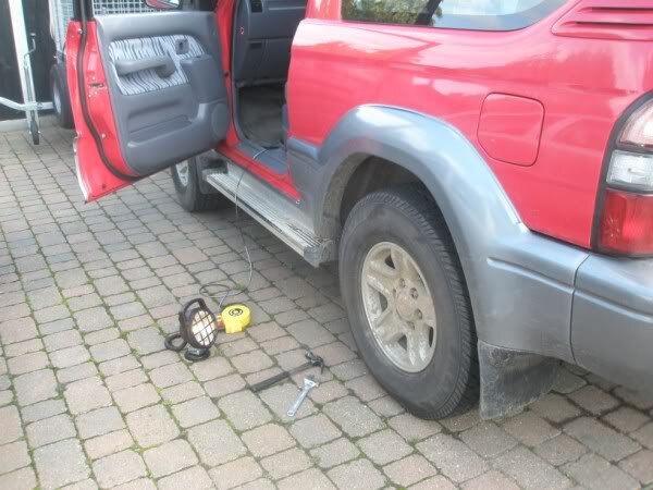

I have to say that I'm very happy with how it's turned out for a little under £22 including the extension lead I've ended up with IMO a very versatile search/work/camping light :D That's a saving of more than £40 over the LightForce one I was so close to buying :shock: :)
