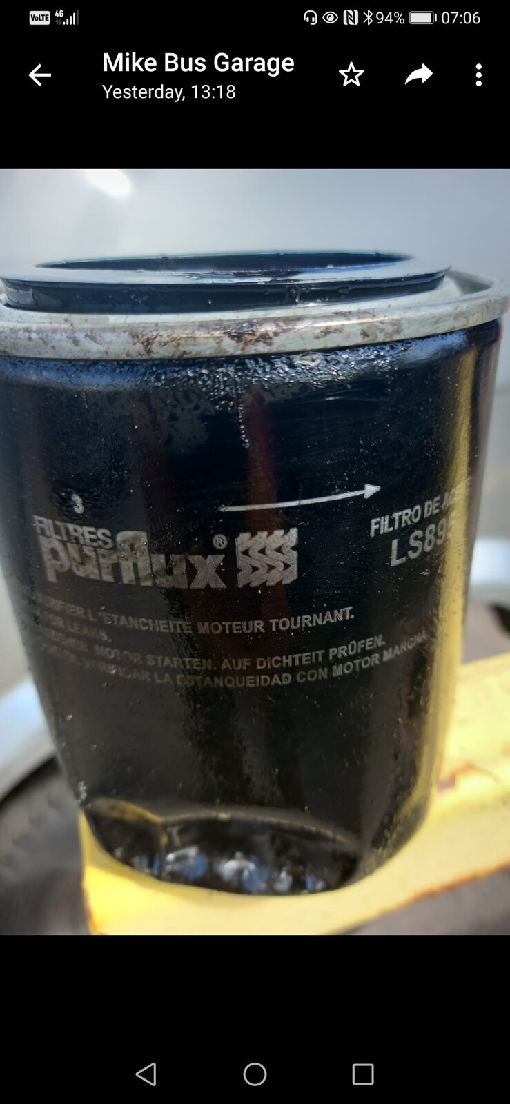

Update on my freaky oil leak.
I put my car into my friend's garage to diagnosis my oil leak.
The leak was on the passenger side rear of the engine.
I was thinking the worst case scenario that my main crank seal in my gearbox leaking but to my surprise it was ok.
The culprit turned out to be rust around the top of my oil filter so hopefully fixed.

I have had the car over 2 yrs now.
I have done a oil change last year but never changed the filter as way mega tight.
I never has the correct tool to remove at the time so left on.
Age of oil filter god knows..
Good result is always a good result.
Many thanks guys for your interest and support and information.

I always put the filter on hand tight on mine - as tight as I can by hand and that will do.
I don't like using tools to put them on, don't know about anyone else here....
Of course you might need a tool to get it off - especially if someone else screwed it on using a socket and a scaffolding pole...
I'm the same, hand tight when putting a new one on. Always needs a tool to remove, I use one of those chain tools to remove it, never lets me down
Hi Tony - I’m glad this worked out easy and cheap for you - and lucky you noticed the leak before the corrosion perforated your filter completely, causing all the oil to be lost when you were driving along.
I favour using a rubber/canvas strap wrench or a chain wrench (the type with a 1/2” socket drive) on my 1KZ engine to remove the filter. Hand tight only when fitting the new filter.
I change the filter at every oil change.
