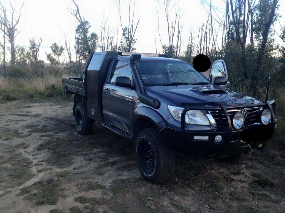

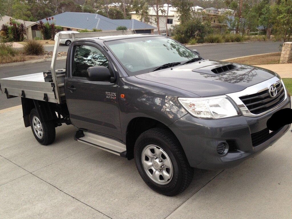

Found this forum after a mate buying a 78 series troopy and happy to show off my hilux build, because everyone likes photos

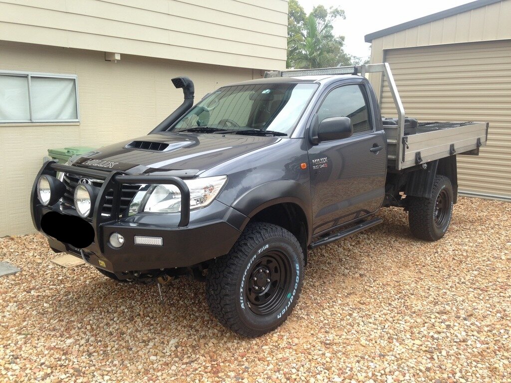

Bought it very stock last year with big plans
Booked it in the first week for all new
EFS suspension with airbag man rear airbag assist and rancho adjustable shocks.
TJM bullbar with ironman 9000lB winch
TJM snorkel
Then took it home and the rest of the work commenced
BFG All Terrain KOs 265 70 16 on black sunnies
Matson DCDC converter with solar input
Piranah dual battery tray

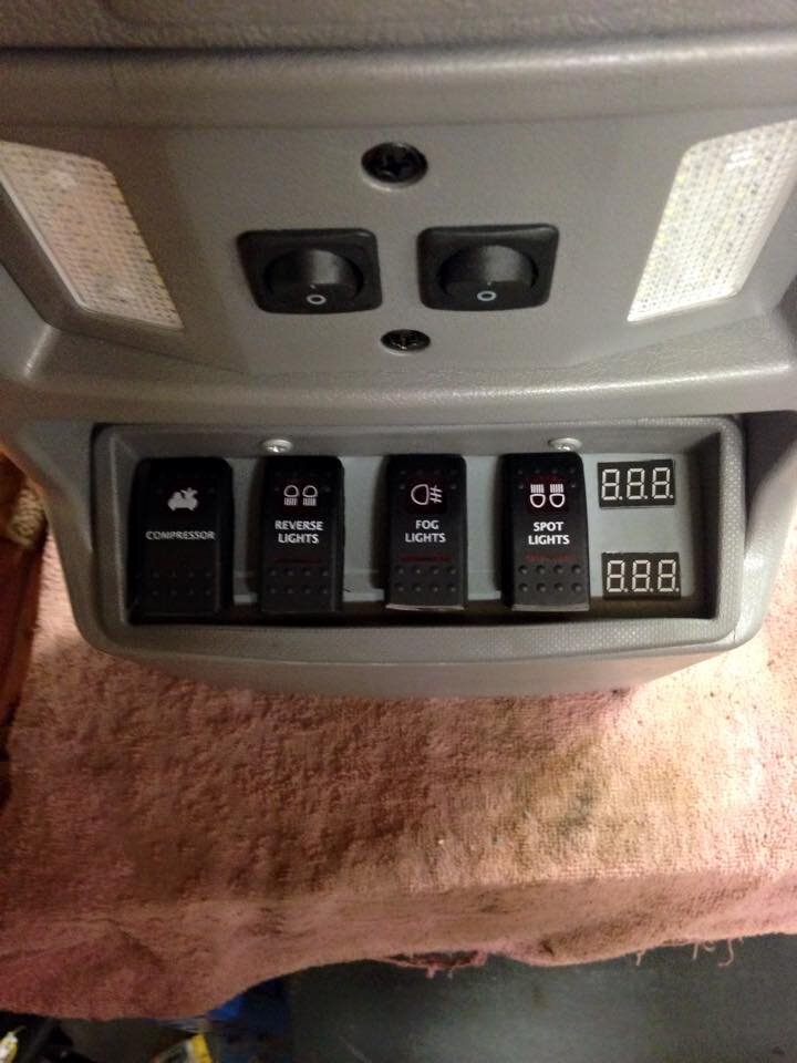

Outback roof console
Remote handheld UHF
FyrLyt spot lights
36" light bar
Buds customs rock sliders
Under body protection
SR5 gaurd flares

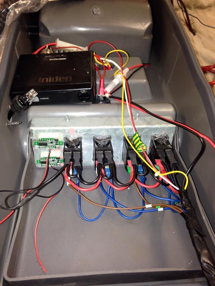

custom work to outback roof console, dual battery monitoring and remote uhf mounted inside with mic mounted to the side.

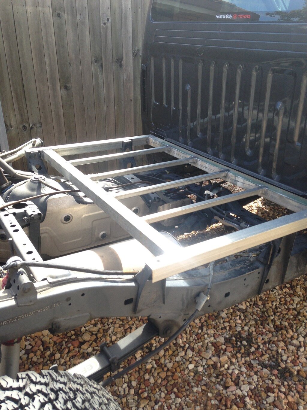

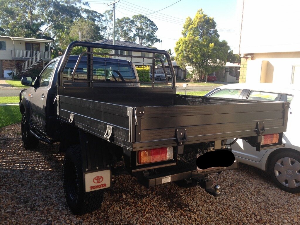

Then it was time to start attacking the tray and canopy. Stripped the tray down like a mechano kit, chopped it down to dual cab length. Then sent it off the the powdercoaters and made a steel frame for the new canopy to sit on the chassis rails
Then had the custom canopy built by MW toolbox centre and fitted it up.

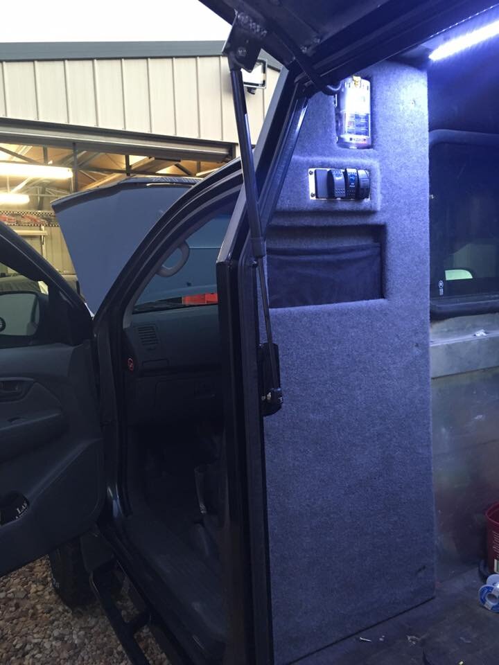

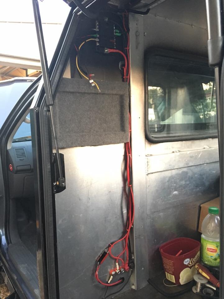

Then most recently installed central locking and tilt activated lighting in the canopy with a nice little carpet panel to hide all the wiring and fuse box etc. Made a little pocket to put charging phones and headtorches
Then finally got around to putting two 90 watt solar panels on the roof of the canopy
