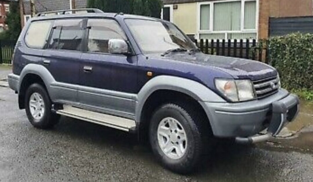

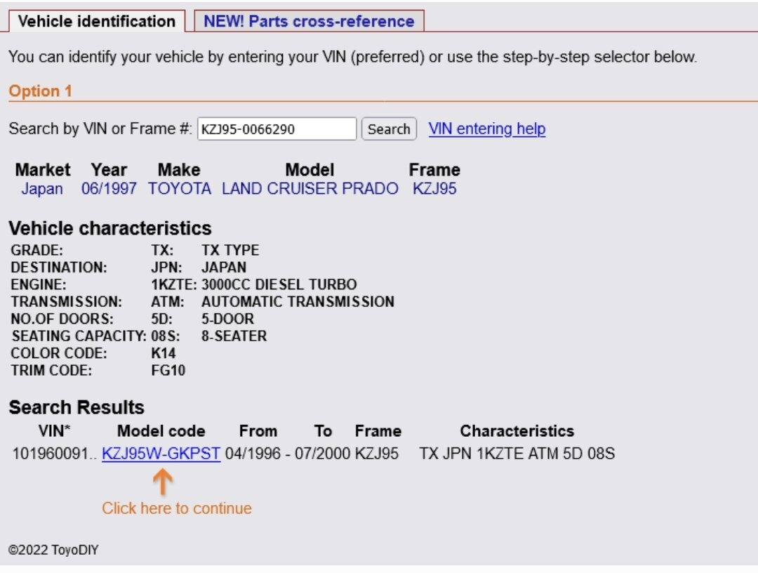

frustration, confusion... everywhere i look my car supposed to have 16 inch wheels. no, it is 17 im not mistaking i know its been raining a lot, but still c'mon.
now don't know what tyre size i should have (by toyota).
since your recommendations my car has visited Paul Toyotatech (super), we did biggred too. so all good just having confusion of wheel size. tell me please (the truth) ha ha ha
THANKS

5 tyre are already on the wheels. on my 17 inch wheels. they are fine, why would i have to read any numbers off from those tyres?
what i think the first owners in japan searched for 17 inch toyota wheels, fit them then car was imported to UK (2004) since nobody have noticed

90 series only came with 16 inch wheels and yours are original .
A 16" tyre will not fit a 17" wheel .
