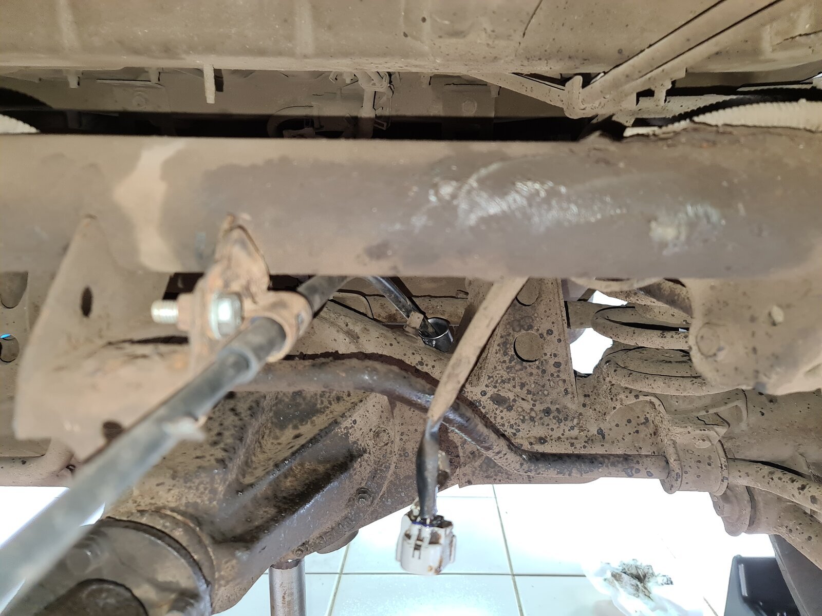

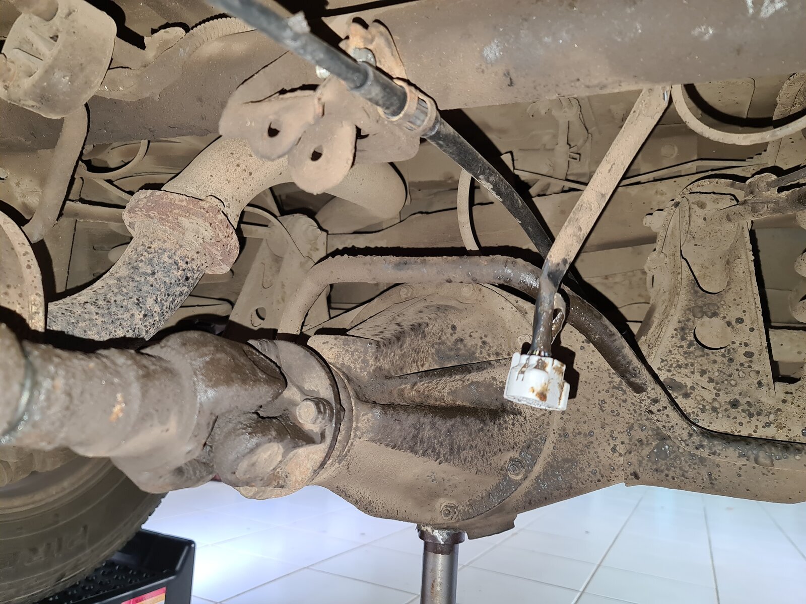

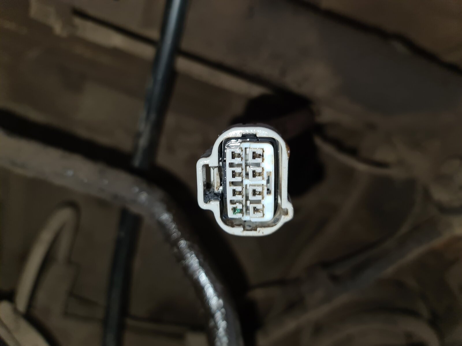

Hi guys! I found this plug hanging near the fuel tank and I have no idea of what its use is for. I tried reaching around the area to see if I could feel the other plug that connects to this one but nothing.
I clean it good with contact cleaner spray but the amount of dirt baked into the plug makes me guess this was hanging for years already.
Everything is working in the rear, every light, wiper and such so what can it be?

Trailer connector loom plug? I have a similar looking one on my 90 but it is inside the body.

Is that the connector for a rear diff lock? But I see that you have a model that doesn't have one. If so it might just be redundant wiring. I'm not sure, but there are some pictures elsewhere on the forum of the wiring for the rear difflock so might be worth checking.

Agree.... Looks suspiciously like Diff lock plug. Have a root around in the same Location there should be a smaller 2 pin plug for dash light....I think its wrong Location for Trailer plug..... Thinking about it there was a short cable/loom With a male one end which plugged into the Female (shown in pic) Then it split into Two males the other end that plugged into Diff lock

If you poke around behind the dash or in the engine bay, you'll find there are a number of redundant wiring looms just like the one you posted about. Toyota have long had a practice of wiring a vehicle for every available option, as it means producing only one wiring loom, hence saving production time. When you order extras with a new car, the piece is simply added, or can be added at distribution if necessary. This is how several of us have added cruise control on the D4D engine. (Even though it was never a sales option new in some markets, like mine)

Yep, they just told me there is no ready-to-go wire for the trailer. Haha. I found mine exactly where you said it would be. And that hanging one is for the nonexistent diff lock system.
