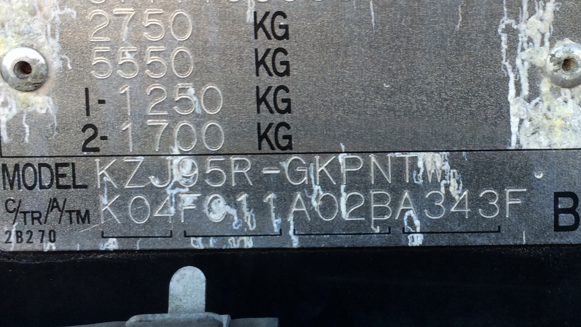

I advise you to check carefully what is wrong before you buy and to check your mechanic’s advice. You said the vehicle pulls violently to the left under hard braking. That doesn’t tally with the front left brake not working. If it pulls to the left, then the left side is getting more braking effect than the right. It’s more likely that the front right is not working. Are you sure suspension is ok?
As for identifying your vehicle, look for the VIN plate. Mine is on the bulkhead behind the engine - see picture. Mine is a KZJ95R.
