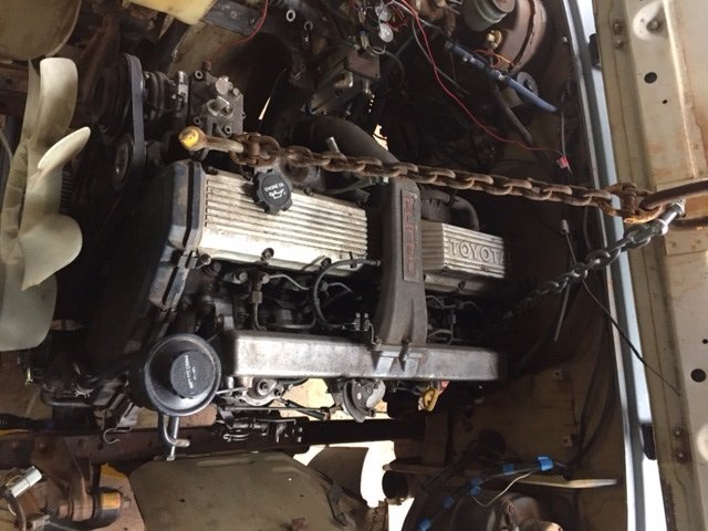

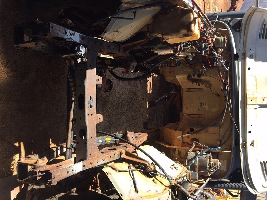

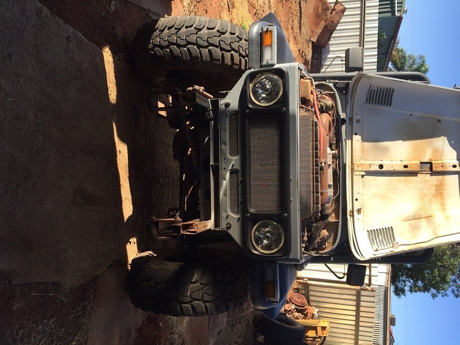

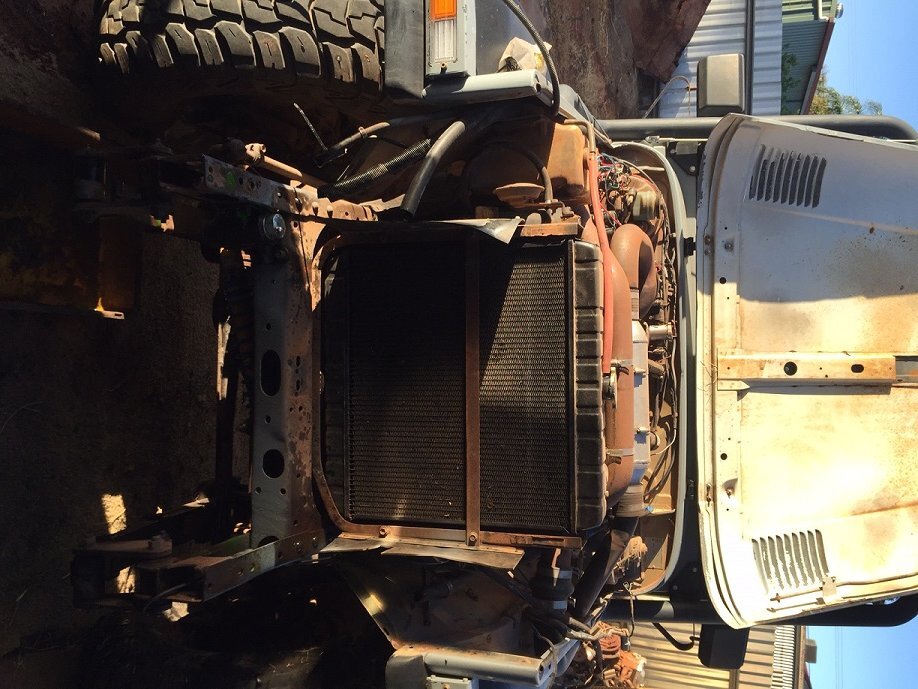

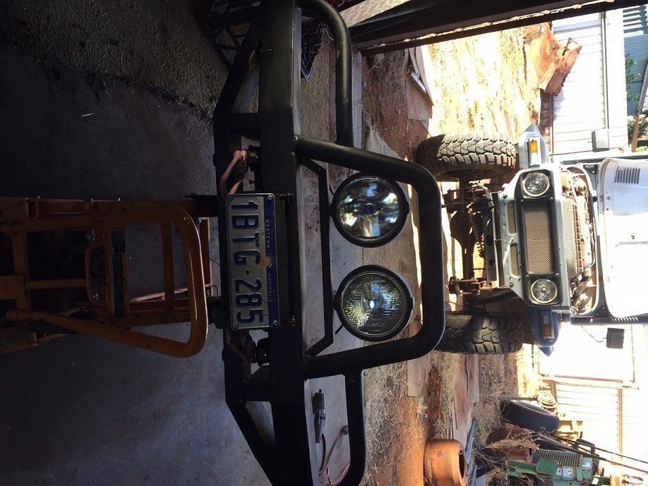

Started the strip out for the new Donk! IMG_1368.JPGIMG_1369.JPGIMG_1370.JPGIMG_1372.JPGIMG_1373.JPGIMG_1374.JPGAll degreased waiting for me to strip out wiring and dumy fit up donk and box for engine mount fit up.

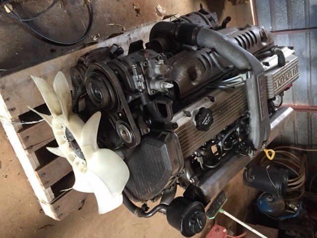

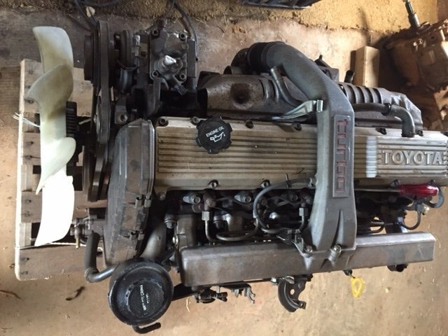

New engine ready for hook up to G/Box4.2 Turbo.1.jpg4.2 Turbo.2.jpg
Engine and Box in place for dummy fit to allow the building of new engine mounts.4.2 Turbo.3.jpg

The 45 looks good man.. So which transmission did you use? Did you go 1hdt + 1hz bell housing + 2h clutch plate and the 5 speed h55?
Looking to do something similar. So interested in which route you have taken?
Looking forward to finding out. . :thumbup:

I think the box is the h55 out of a petrol troopy, Bell housing is h70 unit(so I was told), Flywheel & Pressure plate 1HZ out of 100 series, Clutch plate is from the petrol.
Custom length front and rear prop shaft's, Machining up custom spigot bush( OD-40mm,ID-15mm,L-20mm) out of brass. Custom engine mounts. Radiator
also needs to be moved or the fan custom'd not sure as yet.

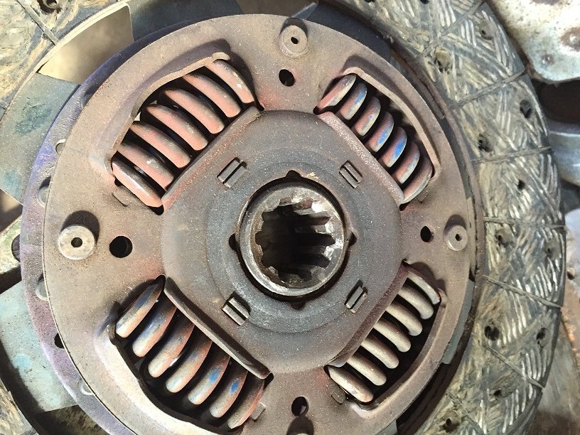

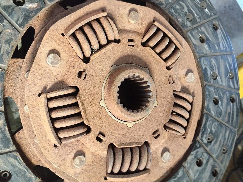

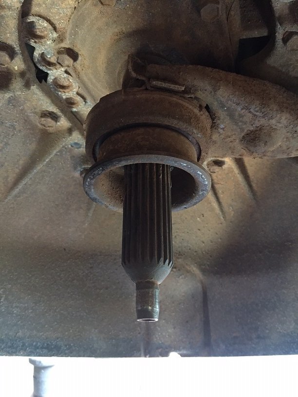

Iwan you only need the clutch plate that suits the G/Box. Diesel box's generally have a fine spline on the output shaft! Petrols have a course spline.
When i spilt the box from the donk this week I will post Picks so it is easy to see!
Starcruiser, I have thought about elect. fans but have had bad experiance in the past! I doo have room to moave my radiator as my grill is 2"'s forward to allow for steering oil cooler and water to air intercooler radiator (had that one with my turbo'd 2H)

IMG_1435.JPGPetrol splineIMG_1437.JPGPetrol Clutch plateIMG_1436.JPGDiesel SplineIMG_1438.JPGDiesel clutch plate

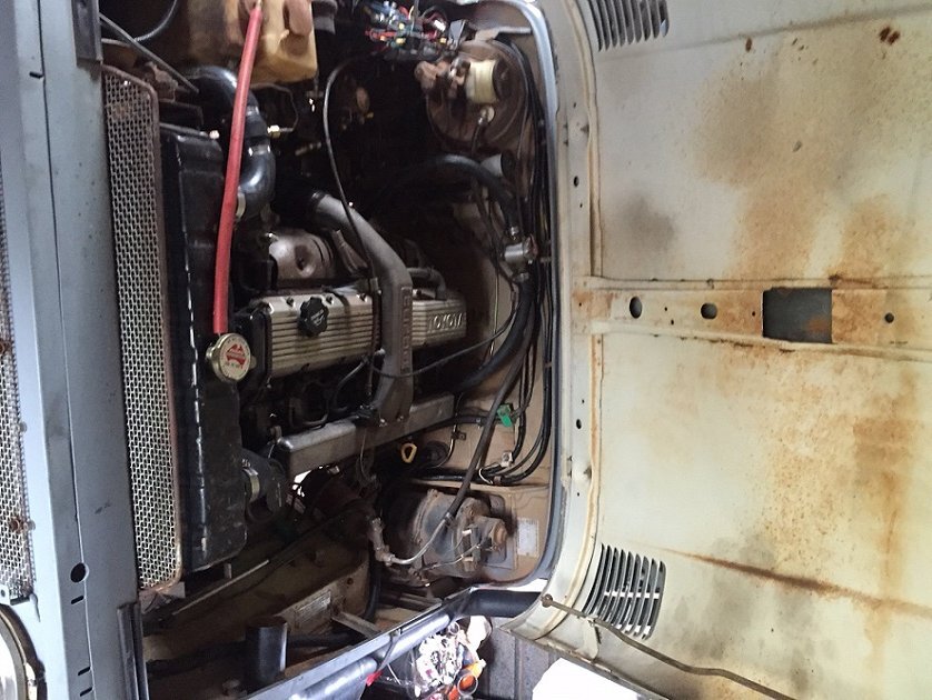

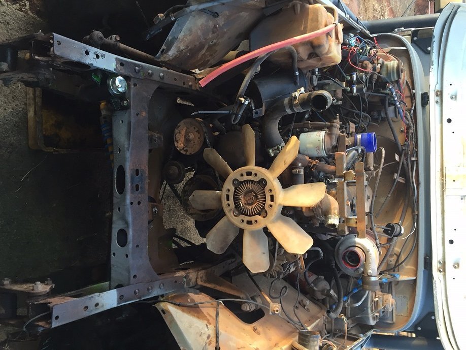

1HDT.1.jpg1HDT.2.jpgWell the hart is in and running. Just some minor things like intake and Exhaust to make and its get out the way the Warthog is coming through!!

Well she is up and running!!
home built twin air intake for the turbo! Custom twin pass radiator.
