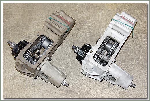

Thanks all. Since I'm new, I'm still grouping around in the dark, here. I had no idea there was a dedicated 40 series forum. I'll go there. Next. I'm using the Toyota motor Co. repair manual #98077-1, chassis and body book. The part I'm referring to is labeled the output shaft extension in the manual. Maybe that explains the situation and problem of not recognizing the part. On the other hand, the problem could be that I'm a native Texan living in Wyoming, USA and close to Yellowstone National Park. Many people, everywhere, say I barely speak English to begin with. Funny. I understand, nearly, every word I speak and some of what I write. Did that help any?
The extension housing is the long part extending out from the transfer case's lower right.....

I've never striped a transfer case - don't you have to be a member of some darkside coven to go inside gearboxes, etc(?) - but if you look at www.sor.com online catalogue page 68 there are fully exploded drawings and the list all the parts. Sor are in California and their parts are excellent, not the cheapest but I've never had a problem in 15 years of using them. Their tech support is good with real people answering the phone!
From the drawings it looks like you can draw the nose cone away replace bearings, gaskets and rebuild. I'm sure it is a lot easier to write about than do.
