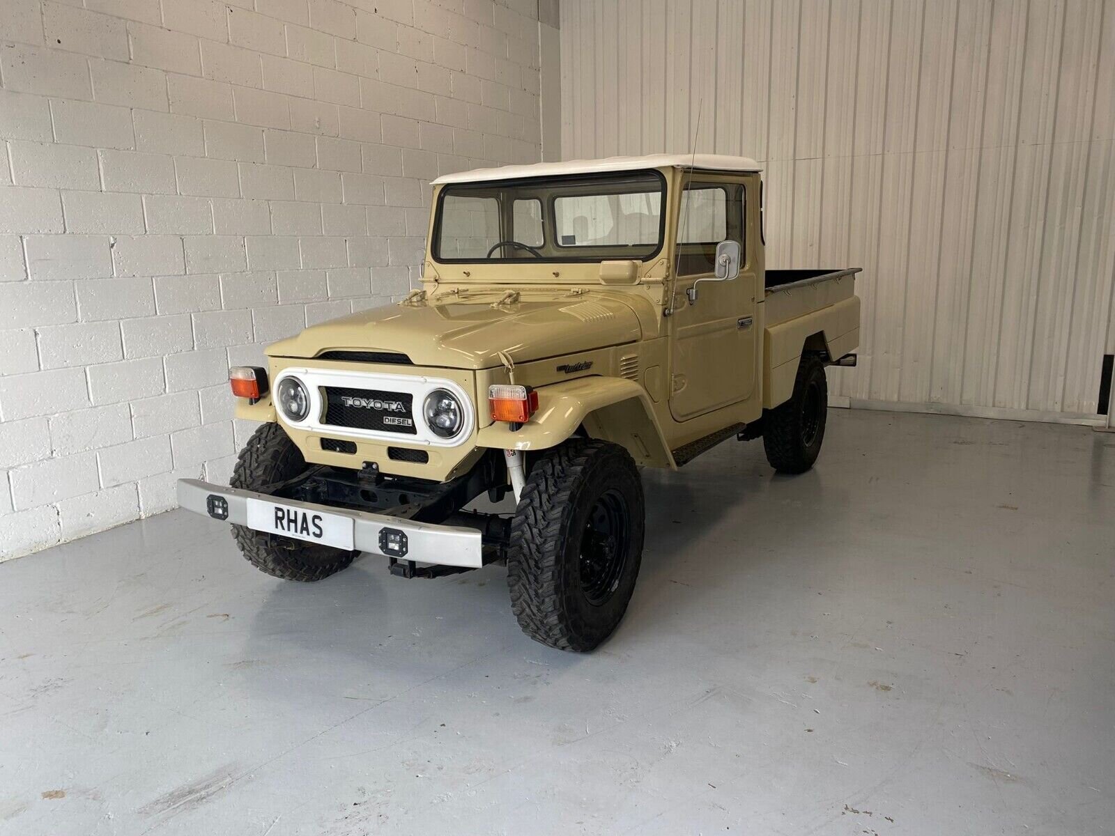

I am the very proud new owner of a 1977 HJ45 originally from Australia and made its way to UK via a period in South Africa.

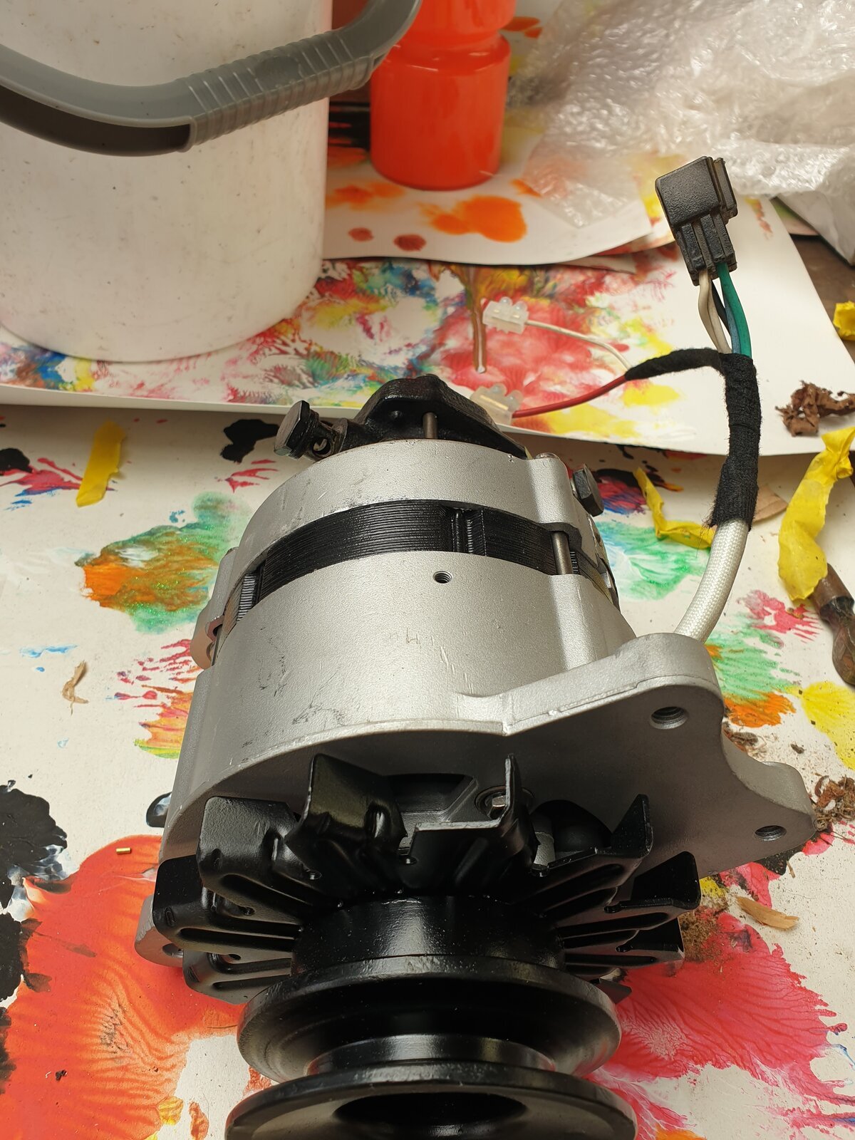

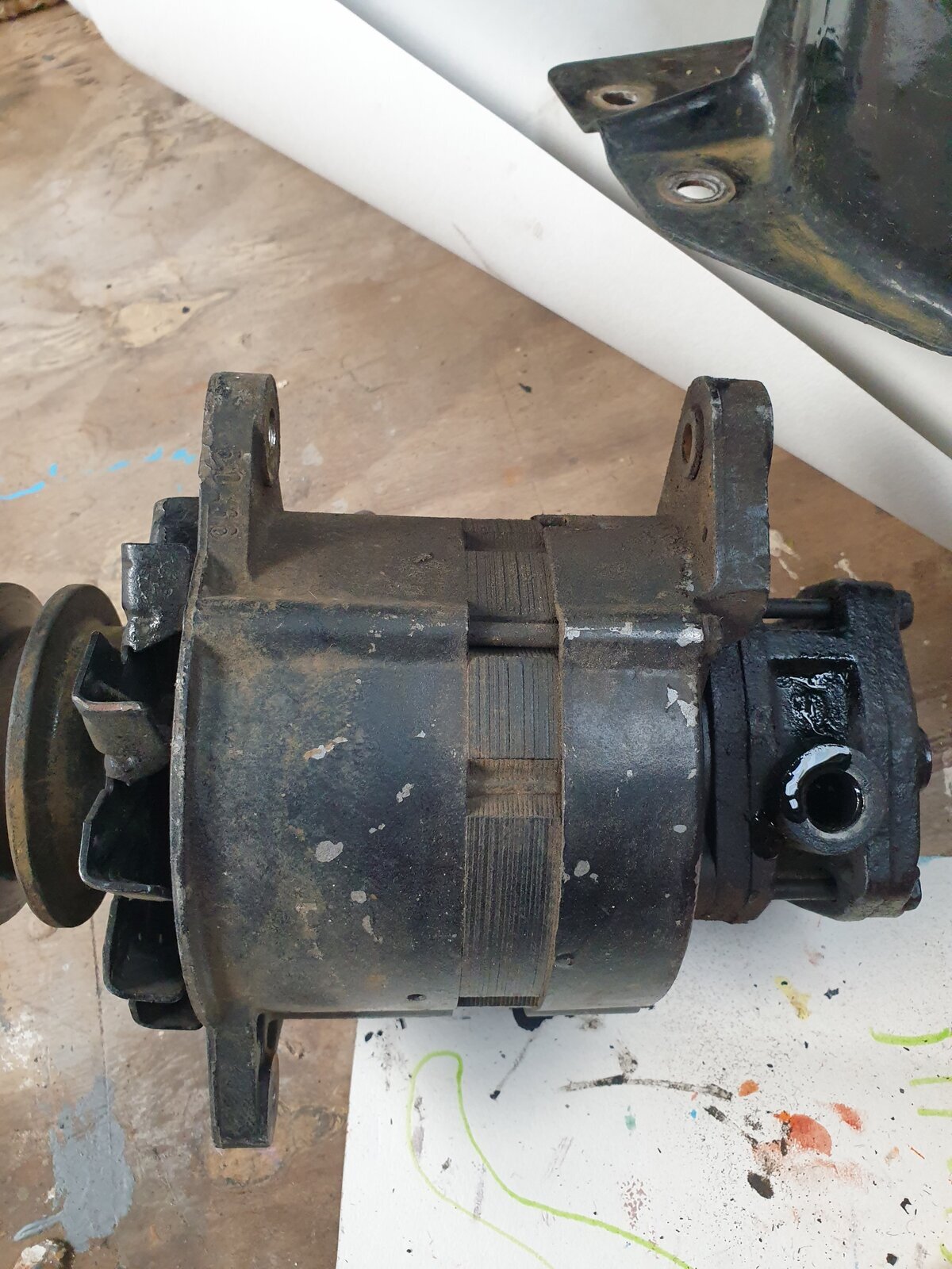

So just to wrap this thread up a before and after shot.
Very impressed.
