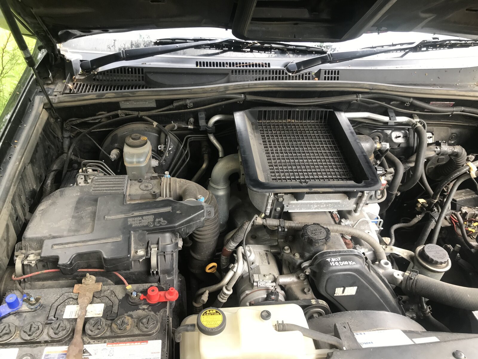

Thanks mate. Hope work is going ok for you. I didn’t realise it was a form of D4D. The mechanic at the Toyota dealership I bought it at went to do some electronic testing of the injectors as I was purchasing it and when he lifted the front he stopped and said this engine will never have injector problems. Photo of my engine below.

One of the reasons I keep thinking it is pre D4D is that some of my friends who have a Hilux or Prado with D4D it’s written on the engine and there is a badge on the side of car where as mine has neither. But as I’m new to it all I could be totally wrong!

Looks like a factory intercooled 1KZ to me but i can't be sure . It will say on the bulkhead plate kzj95 or kd95 i expect .
Either way you got a better engine in my view :thumbup:

I can see the plate in your pic just above the brake fluid reservoir

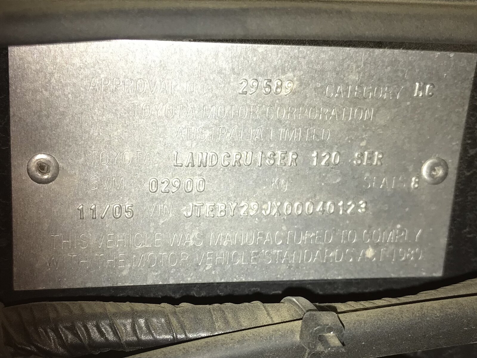

Thanks Shane, now I know where the brake fluid reservoir is. The plate doesn’t have any of those numbers as it might be different in Australia. See attached

It most certainly is , for us that has paint codes on it as well :think:
I'm trying to think of a clear indicator without wandering out into the rain on a cold dark and wet morning at 7.50am in my dressing gown because i have both engines .
Maybe if you google where to find paint codes on your truck it might locate another plate ?

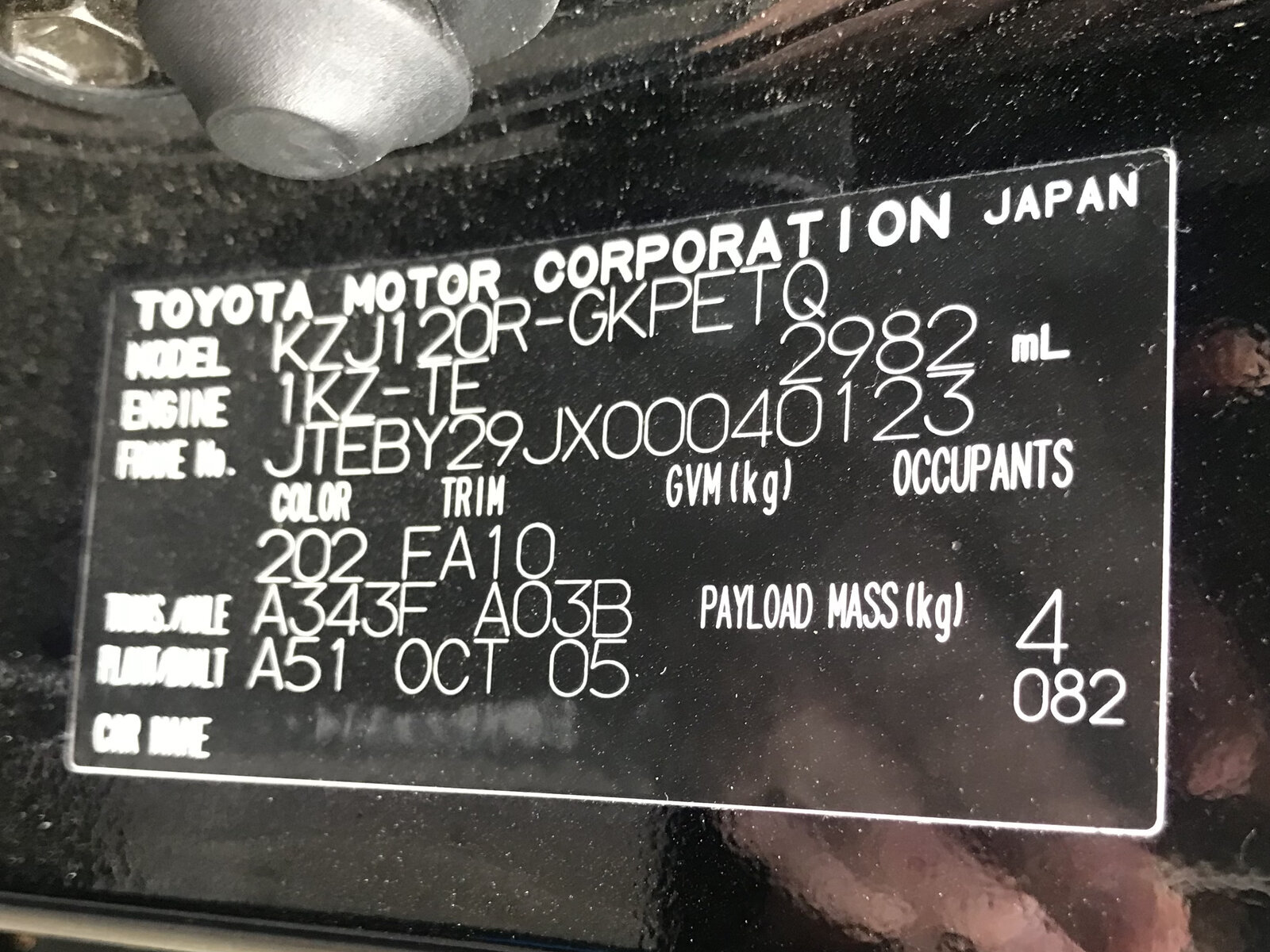

Ha definitely don’t walk out in the rain. Found it! 1KZ-TE

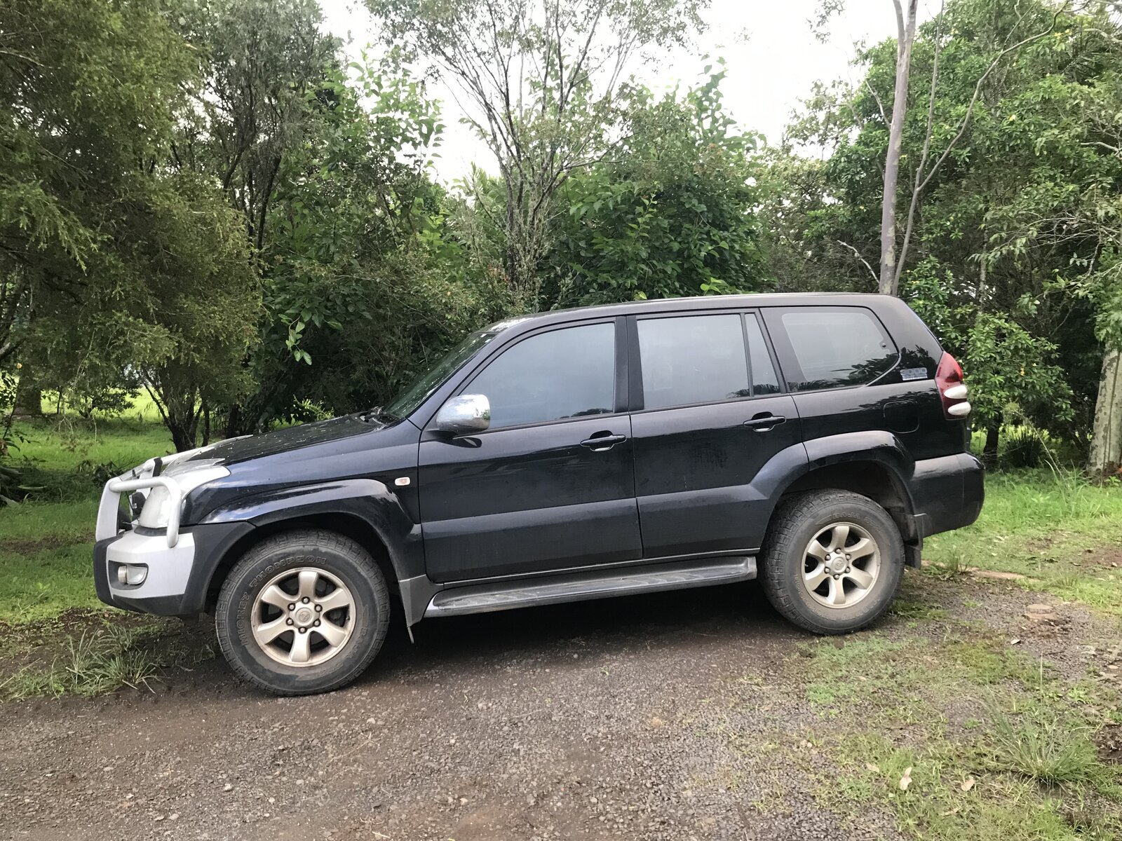

And the right colour too :thumbup:
Cooling is the only known issue with this engine , more so in the auto because your radiator has gear oil and water flowing through it .
It shouldn't be an issue for you if coolant has been replaced every 5000 miles but some radiators corrode inside letting water and oil mix . Possibly Toyota added a separate cooler to the 120 ?
Other than that its just general maintenance to keep that running indefinitely and we know half a million miles and beyond is possible .

Yeah I love the colour. Yeah that’s interesting regarding the cooling. I’ll need to learn to change my coolant as I’ve only just learned to change oil. Not sure about a separate cooler will need to do more research. Will keep an eye out on the radiator as well. Thanks for all the info and tips. Appreciate it!!!
