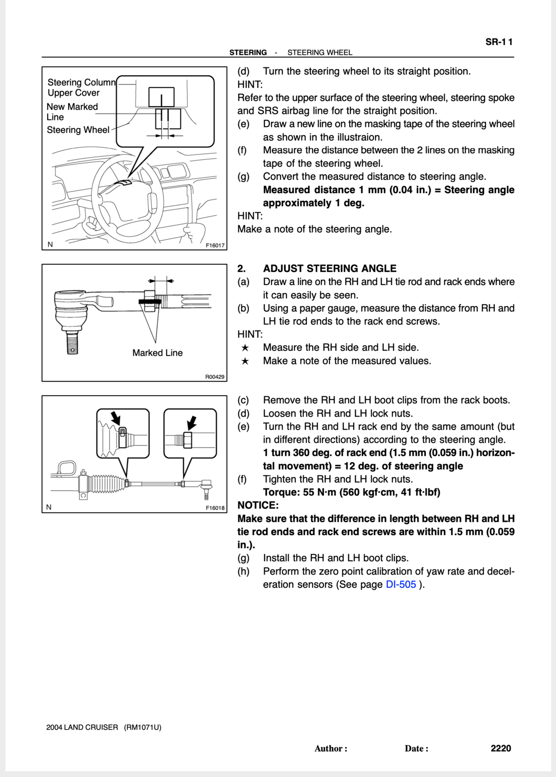

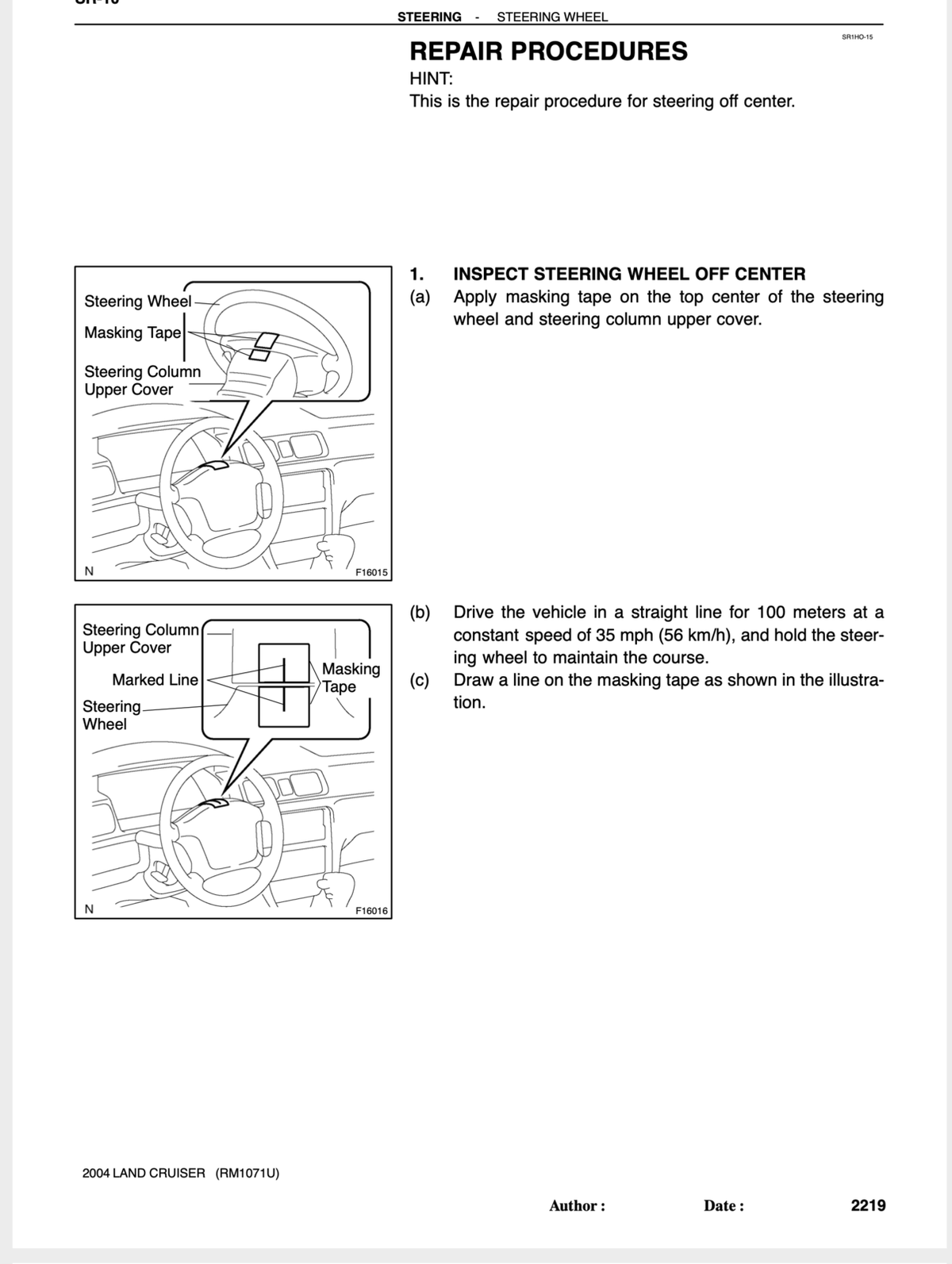

This is my humble opinion, I don't think you need to remove the steering wheel, I would first have the steering alignment checked (tracking) then once you know that to be good you can then follow this procedure, I did and it worked.
Hope this helps

For the steering, do as JJ says. Adjust the tie-rod ends.
