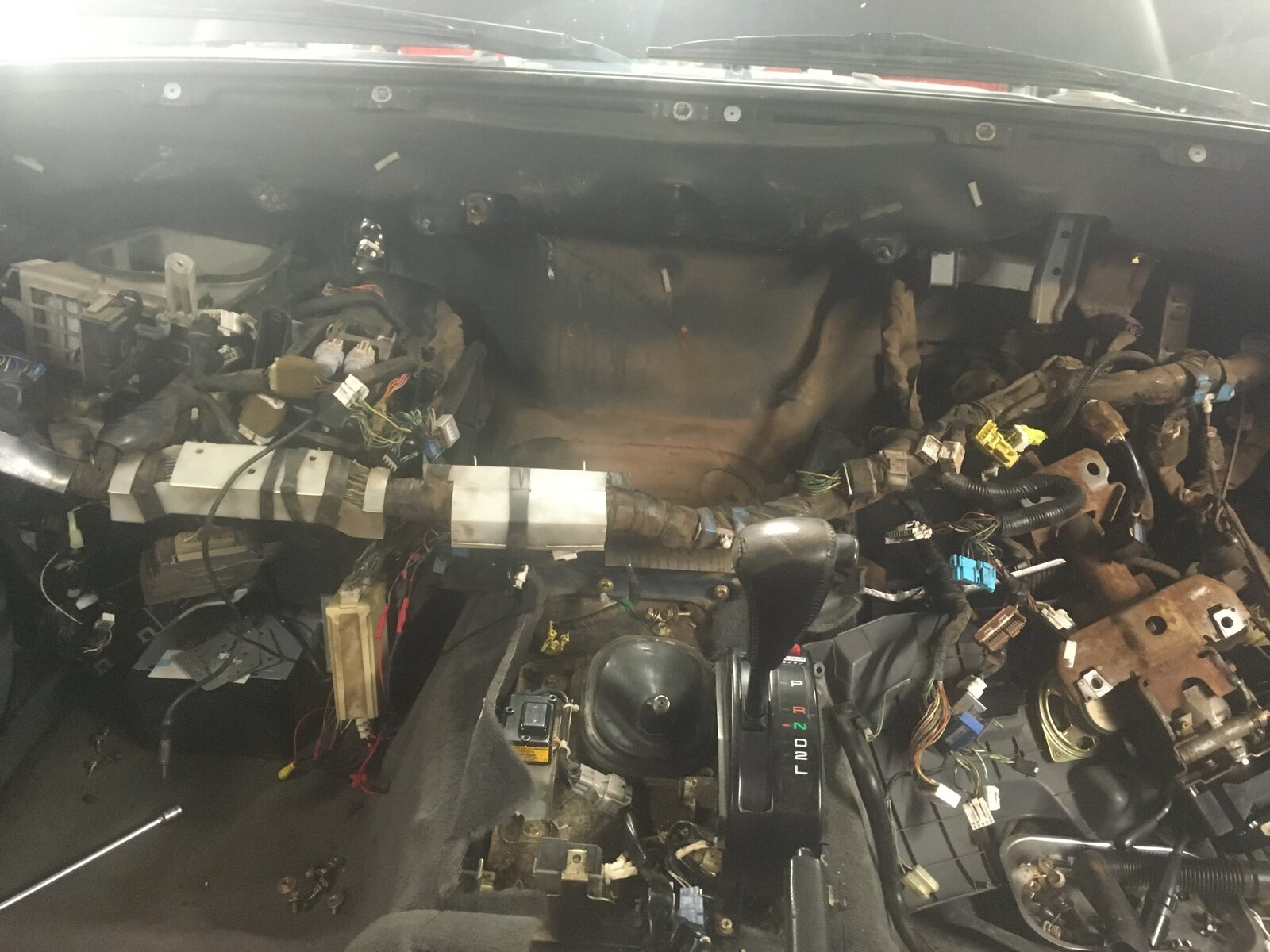

I'm thinking this probably means blocked matrix? I had a look in my Hayne manual and it suggests I'll need to get the A/C degassed and remove the evaporator to change the matrix. Anyone done his and know what the score is?
