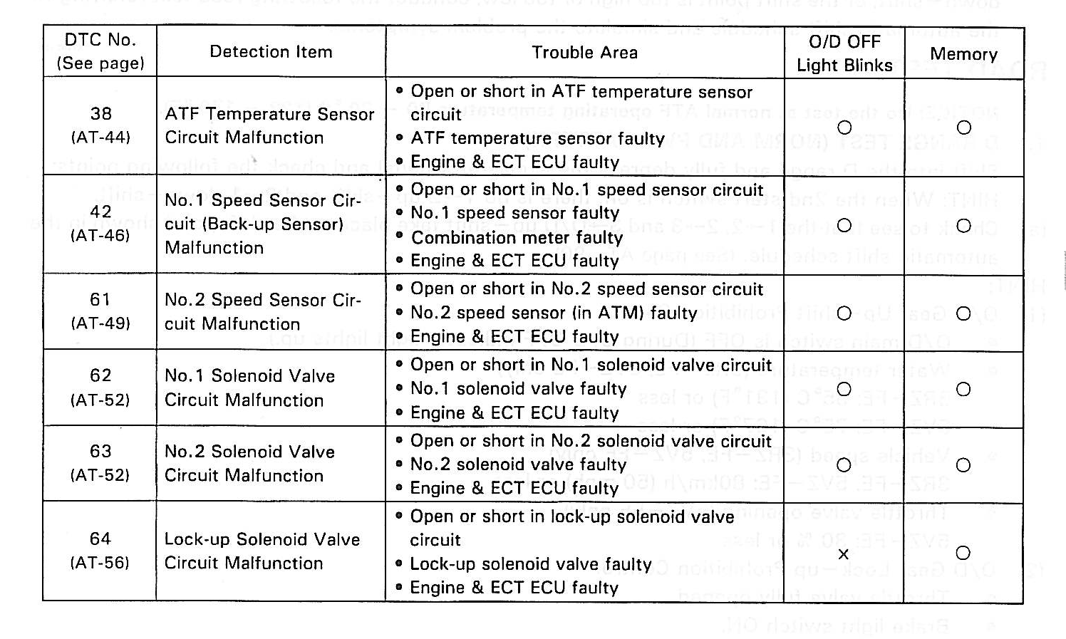

I have seen the O/D light flashing when I use the diagnostic checking in the engine bay. Mine flashes steady when the pins are connected together showing nothing wrong( touch wood) with my auto gearbox. Not sure if the Max Ellery manual has any codes for the auto box. Might be worth checking the levels ,etc in the box to start with.

I was just looking in the autobox workshop manual and saw this and remembered your post,
jump TE1 and E1 together and press the OD switch, then read the code
