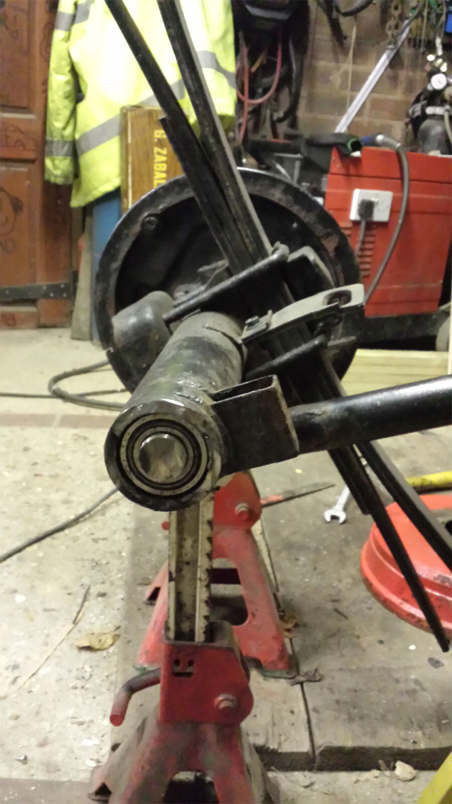

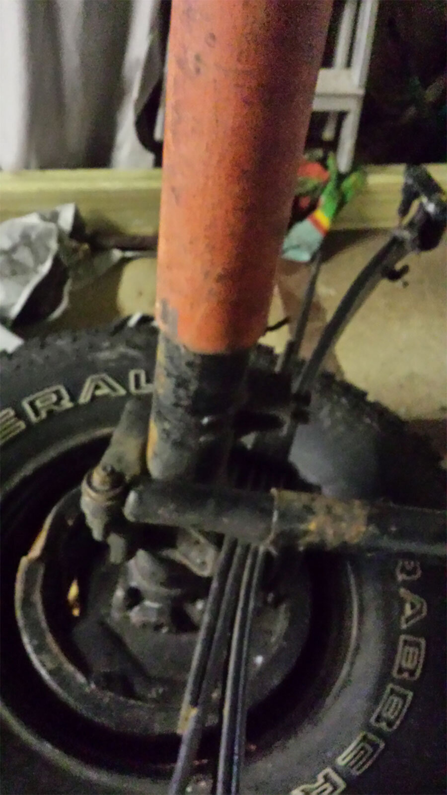

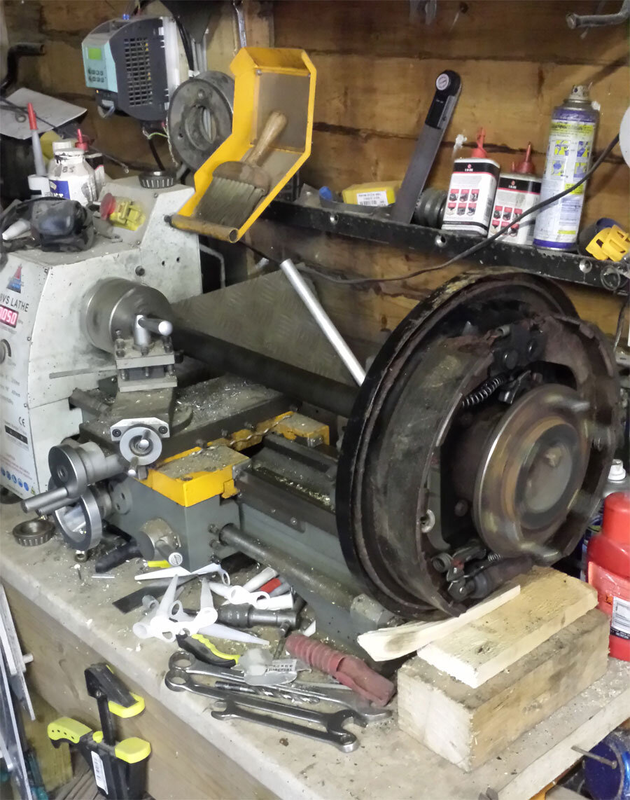

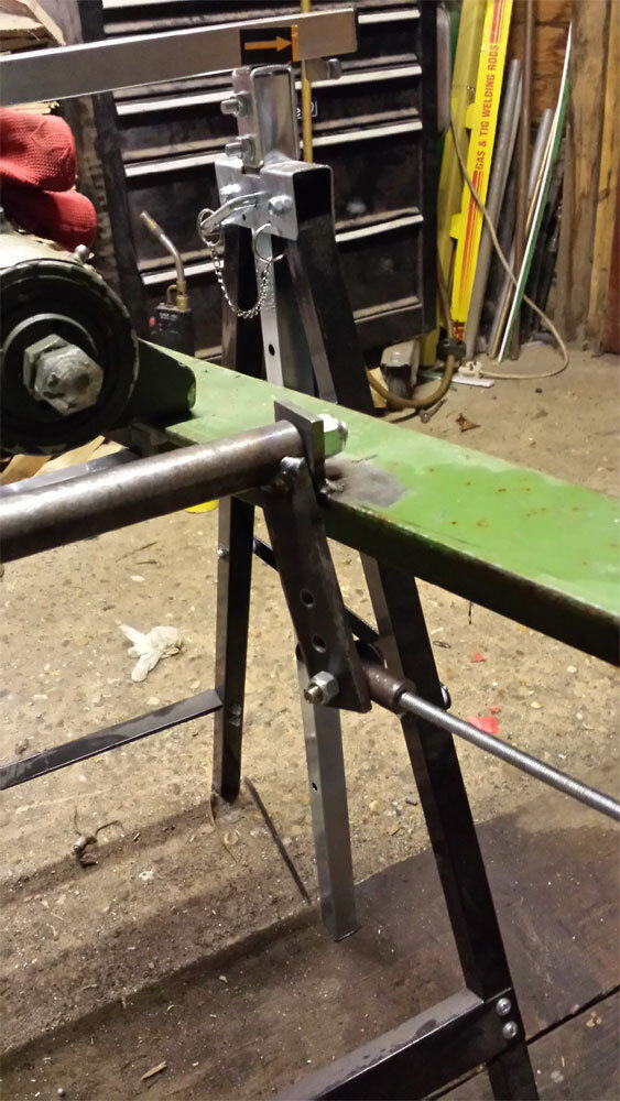

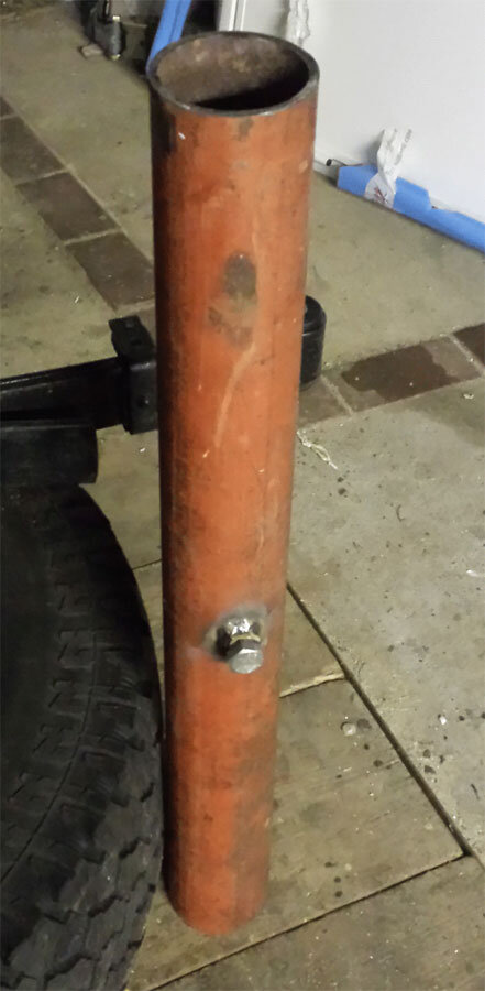

this is our first problem to over come, a floating half shaft, with one bearing in the hub end, this was not enough and i wasnt going to take the chance running on one, so i searched for a bearing to fit in the original axle tube to carry the shaft so i could cut off the excess, what a pain there is a limit to what you can buy, the only one was 62mm out side and 32mm internal the shaft was 33.75 so we had to get it in to the lathe, this will get some laughs,
i managed to get hold off a 75mm steel tube with a 5mm wall to use as a sleeve, i drilled out the middle and fitted an oil filler point as the new bearings are open faced and i need to lube

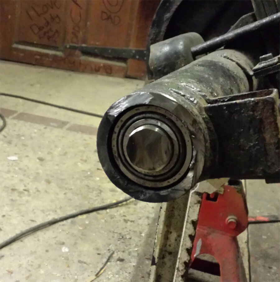

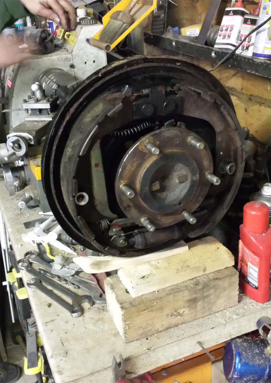

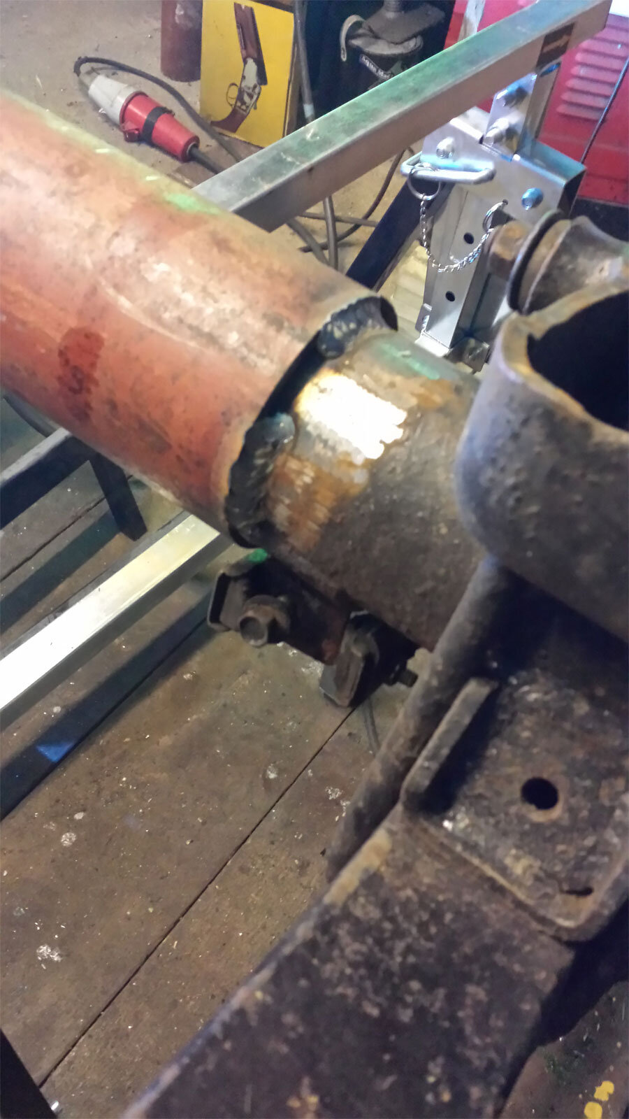

this is the bearing fitted and the shaft cropped, all the old brackets were cut off and reused as i want to use the original brakes, it was welded in so it wont move and it sits against the shoulder we turned down in the lathe
the welding is buy paul hes first class, the 19mm holes were just to get that extra fix the the original axle outer tube

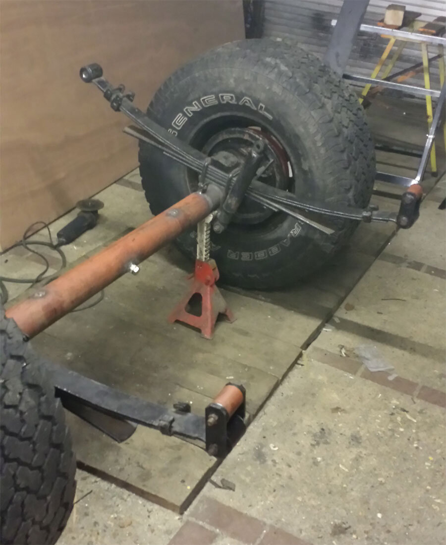

job done, these wheels are 35inch and im getting excited, you will have to remember this has not been down on paper so we do discuss as much as possible and we do get some silly mistakes.

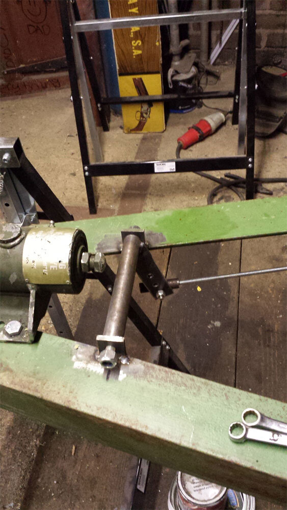

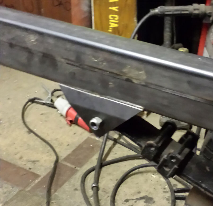

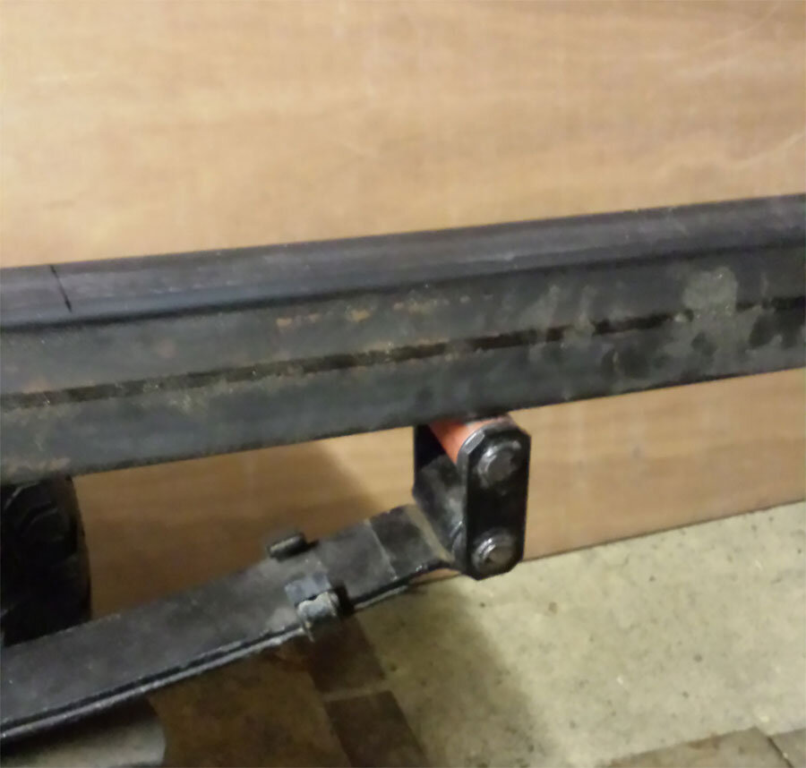

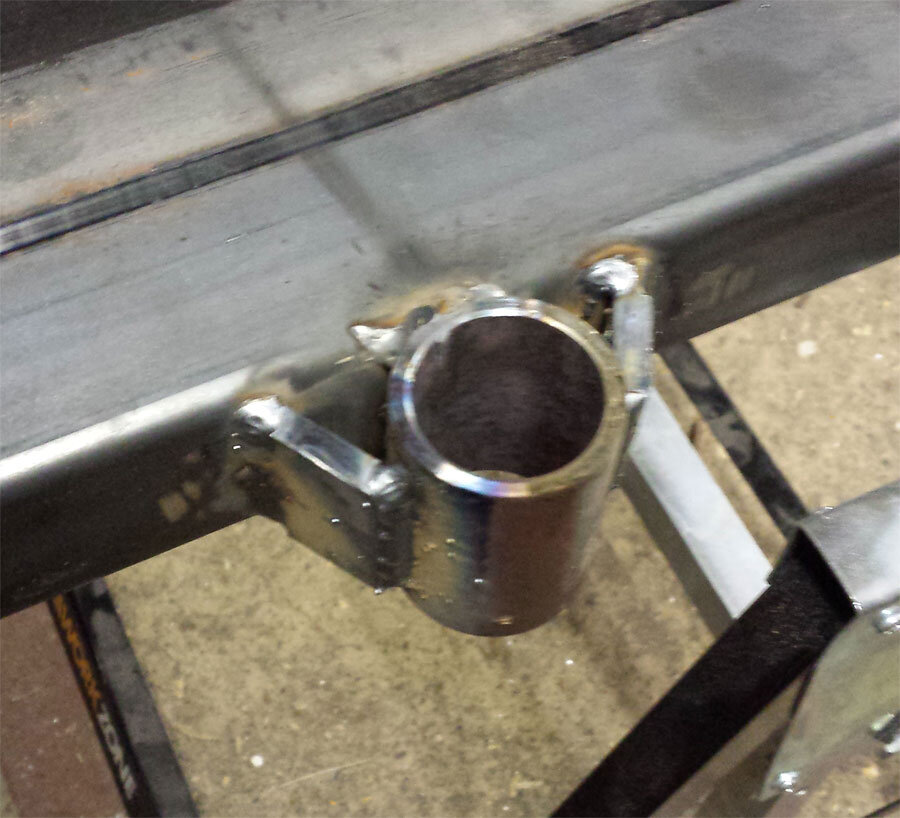

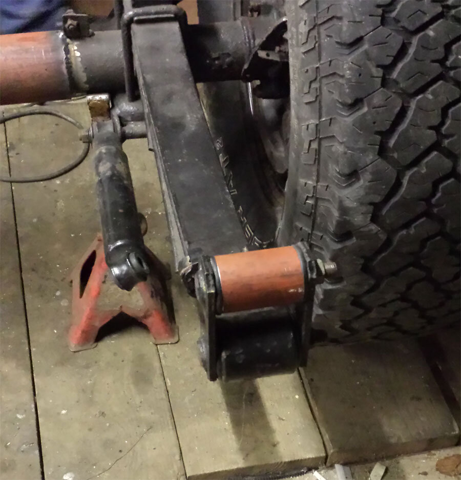

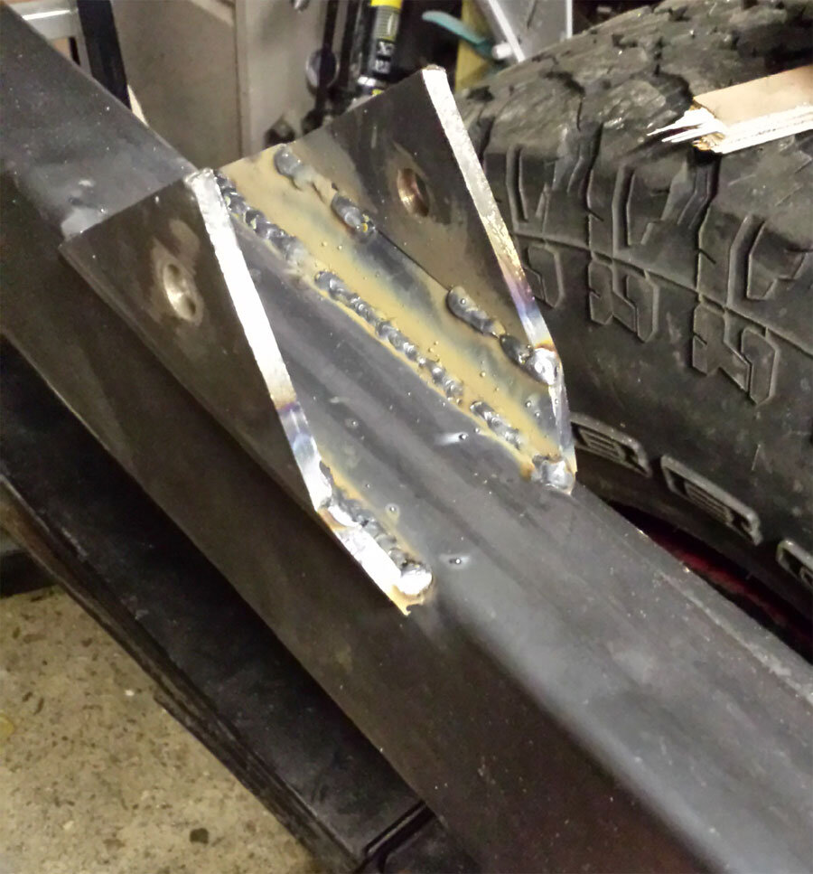

the next bit was to fab the mounts for the springs.... easy bit
we had tube lying around for the bushes and some 4mm flat for the hangers, well thats what im calling them, profiled,drilled, folded, then welded on to the chassie, which is a 100mm x 50mm box 4mm wall

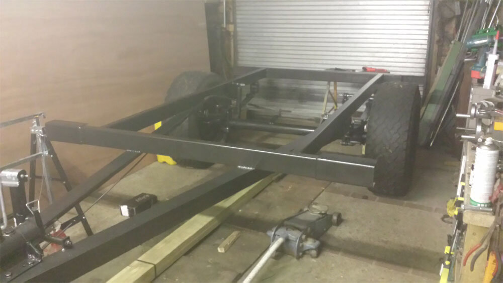

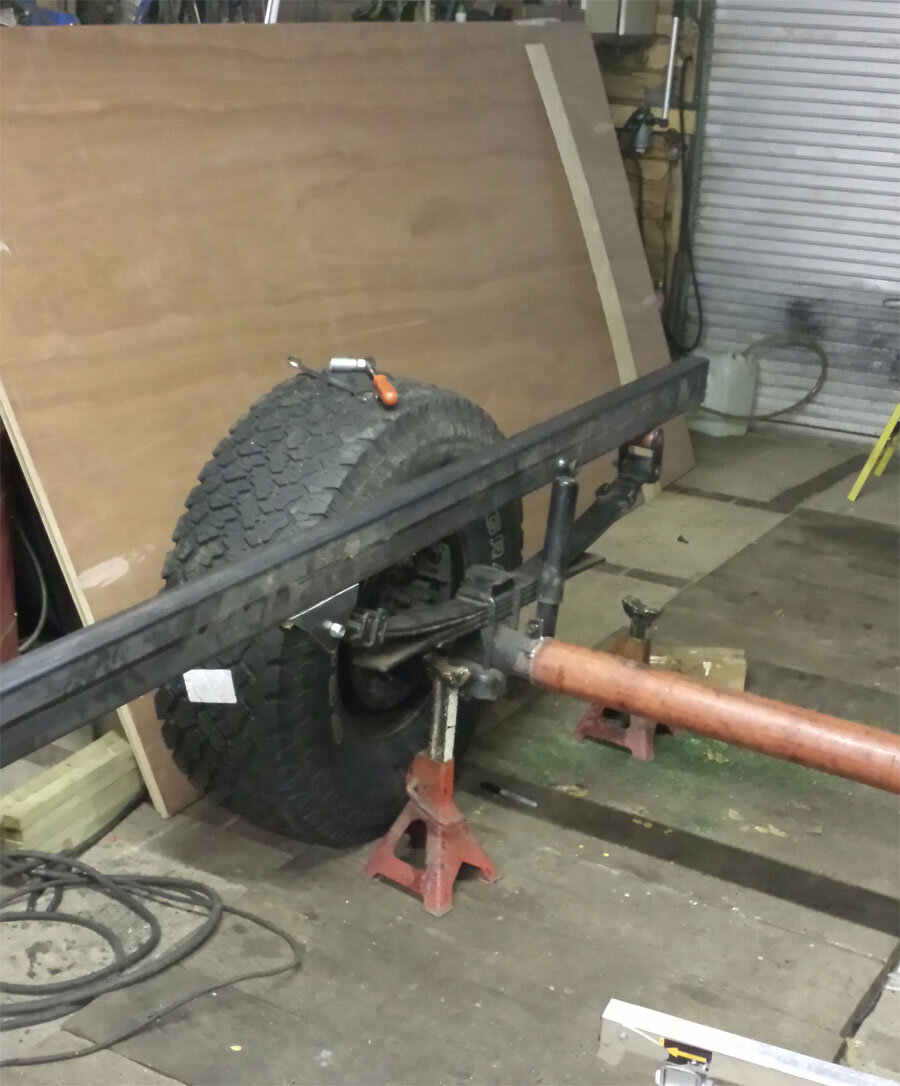

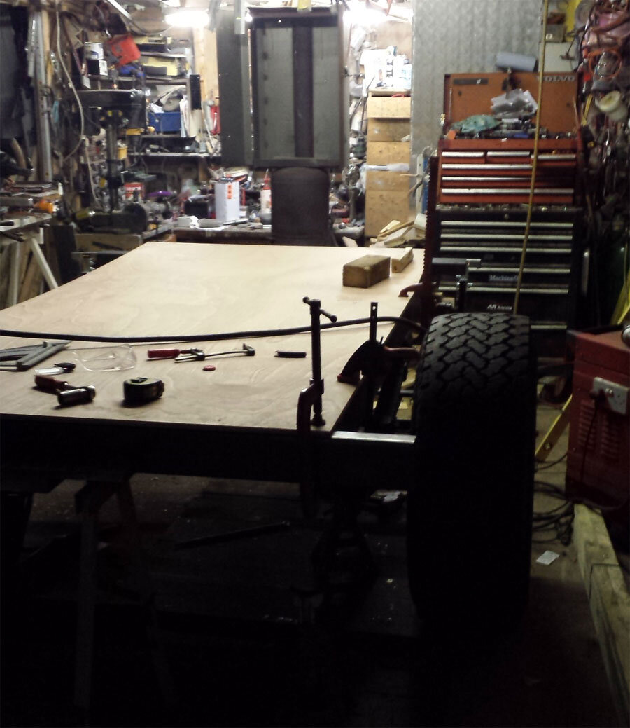

the chassis is finished at 2.4 long x 1.250 then out riggers taking it out to 1.800 wide
this is the biggest square we could find to set up the chassie 8x4 marine ply

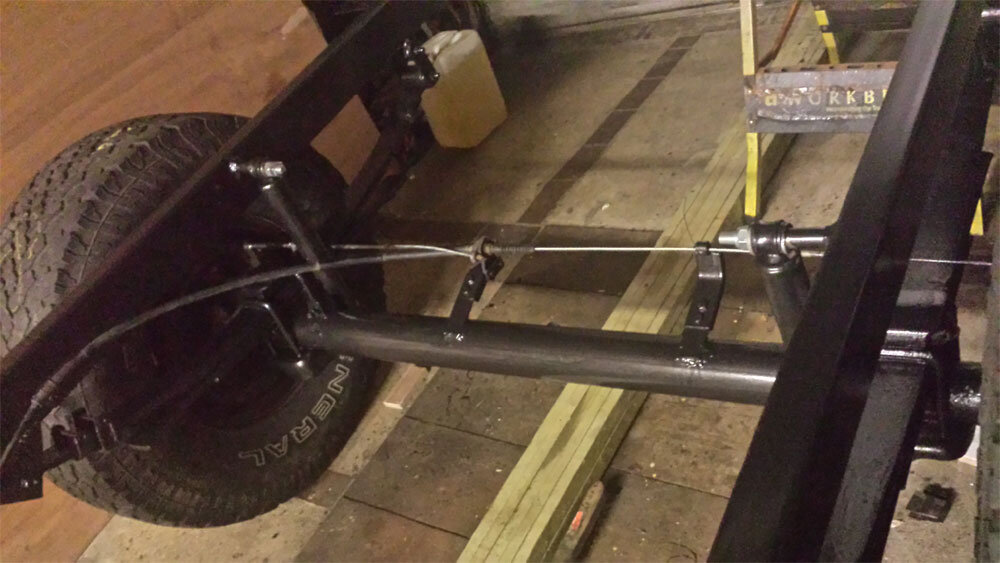

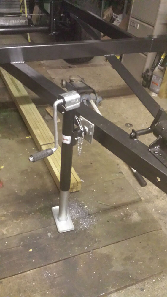

the chassie now set we went about the a frame, which has to be long for the angles shes going to be getting in to.

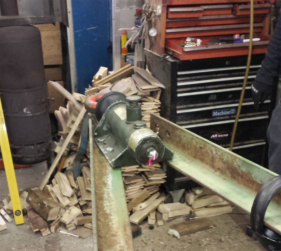

the last time we set up an a frame we used string lines, b-----ks to that i got me a laser and it went as sweet as a nut once we set up center on the chassie
you can see the laser beam on the rear of the bradley hitch, this is only set upside down for welding purposes
