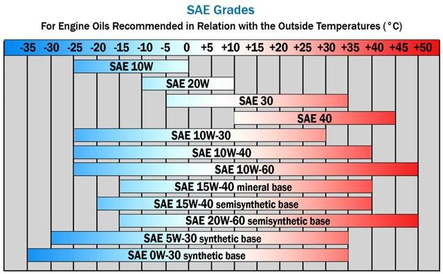

Hello, I live in New Zealand and just joined the Landcruiser club. Thanks to those who helped with my center diff actuator. I have ordered one from Chapelgate. Its got colder here now as we are going into winter. Will be expecting sub zero overnight temperatures and single digit highs for the daytime in the coming months. 15/40 is often recommended for use here but seems a bit thick for winter use to me. I am planning to do a bit of hunnting soon and will be traveling to areas that get down to minus 10 c in the mornings. What oil grades do you guys use? Engine is 1hd t with 278k on it. Is the likes of 5w40 too thin? Thanks.
I use 15/40 all the time
cf028082-9c32-408b-9922-6c55c0d2dc53_SAE chart.jpeg cf028082-9c32-408b-9922-6c55c0d2dc53_SAE chart.jpeg
15-40 fully synthetic CI-4/SL oil grade, good for 10,000km in this hot coastal climate.
