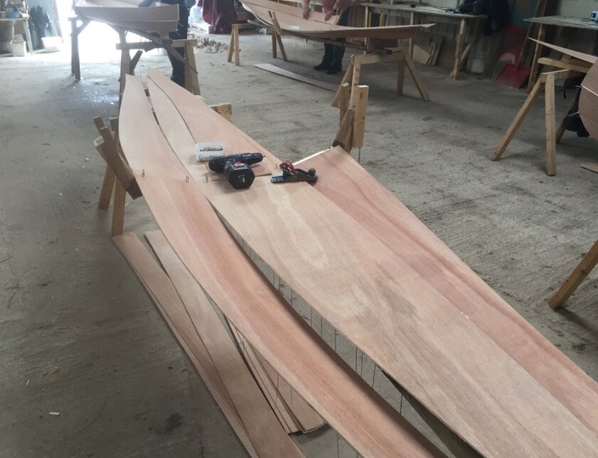

Then you lay some of the bits out, in the right order is best or you end up with something very strange.

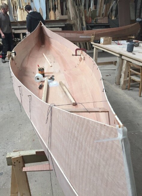

Using cable ties to begin with, you start to tie planks together in a wobbly, flopping heap.
Screen Shot 2016-03-28 at 21.22.15.jpgScreen Shot 2016-03-28 at 21.22.26.jpg

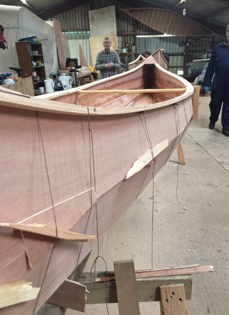

Next job, which is a bit odd, is to use strong twine pulled tight, under the hull to give it some shape. Odd yes but it really works.

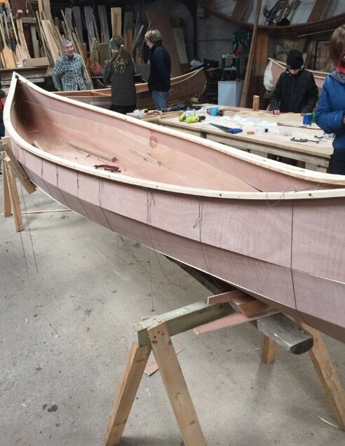

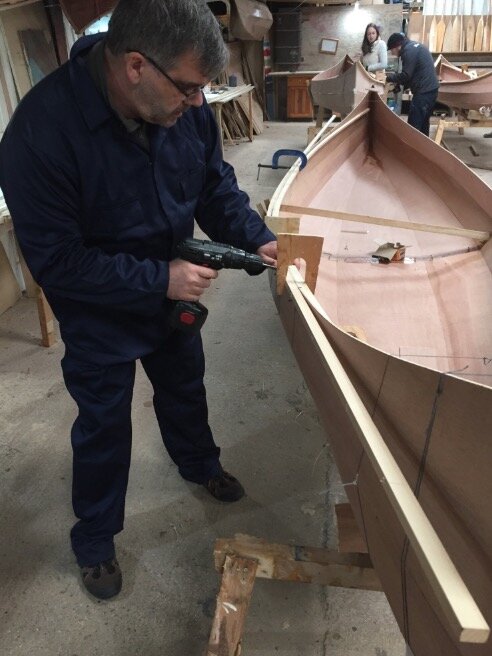

After that you have to weld, sorry nail, uhm no screw some gunwales on. Yes, I know gunwales? Go figure. We weren't in Wales and I didn’t have any guns. Moving on.
Oh here’s my mate attempting to fit his gunnels. Gunwales.
This gives the boat some real shape but strewth they fight you every step as they twist all over the place.
Once you get the yoke in the middle it all starts to go more rigid.

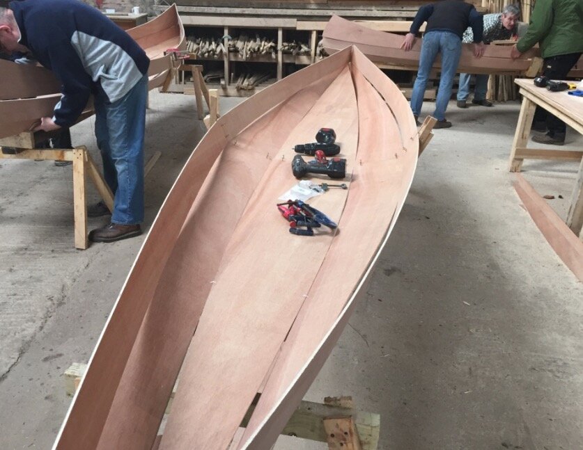

Using packers, you get all the planks lined up so there are as few gaps and ridges in the hull as you can make possible.

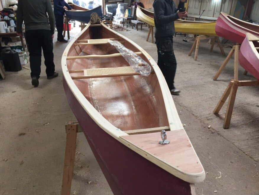

Last job before bedtime is to resin the inside with fibreglass tape. Horrid job. Sticky, nasty and errm, sticky. But it firmed the whole thing up so I could get some paint on.
And get the seats in. All the other bits and pieces and about 5 hours of sanding.

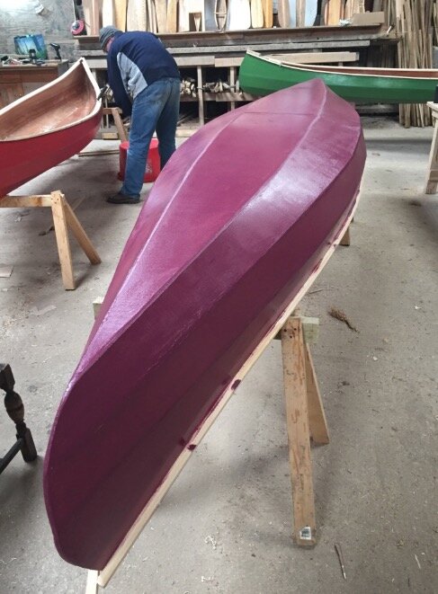

And some pain. Sorry did I say pain? I meant paint.
So after 4 days you end up with a canoe.
Stick it on top of your Cruiser and job’s a good’un.
