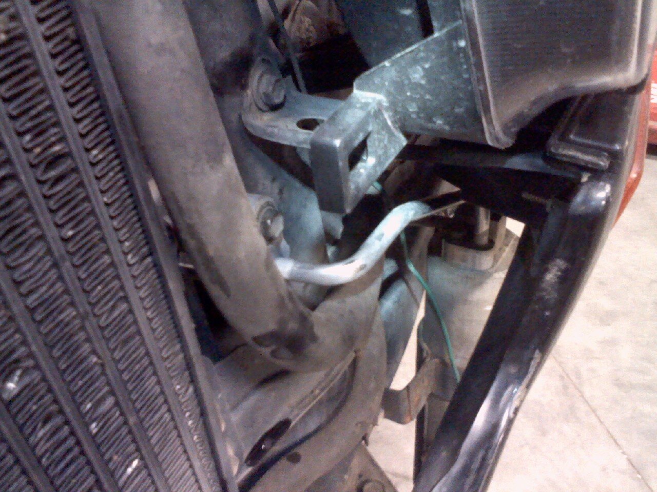

I bought my 97 LC FJ80 from a lady who had wrecked it in a ditch in the snow this winter. Nothing major had to be fixed; headlights, windshield, and AC. So far the headlights were easy, the windshield was $250 dollars, but the AC is a problem. When the lady put the LC in the ditch, it snapped one of the hard lines that attach to the drier bottle (dehydrator). I have ordered 2 seperate parts from looking at a diagram of the A/C system, and both times was wrong on the part. Now, after spending many hours researching, I still have no idea what part I am looking for. The diagram I am looking at does not show the part, I can not find another diagram, and It is only a 6 inch line that I need. So I need help if you guys can provide it. The line that is broken attaches to the top of the drier bottle and runs up to the radiator. I thought initially it attached to the condenser, but while I had to the grille and brush guard off putting on the new headlights I was able to see that it ran to the radiator. Any help that you guys could provide would be amazing, because I am getting very frustrated shopping for this part.

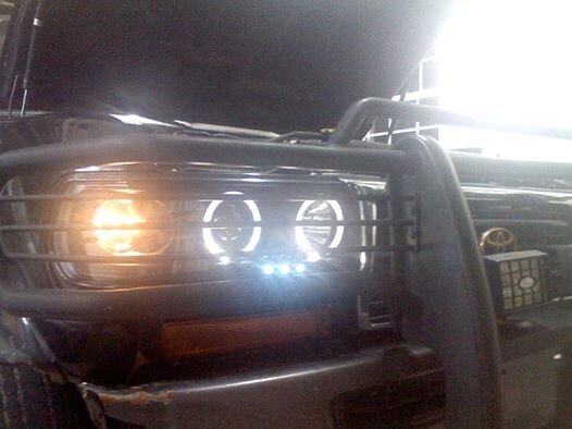

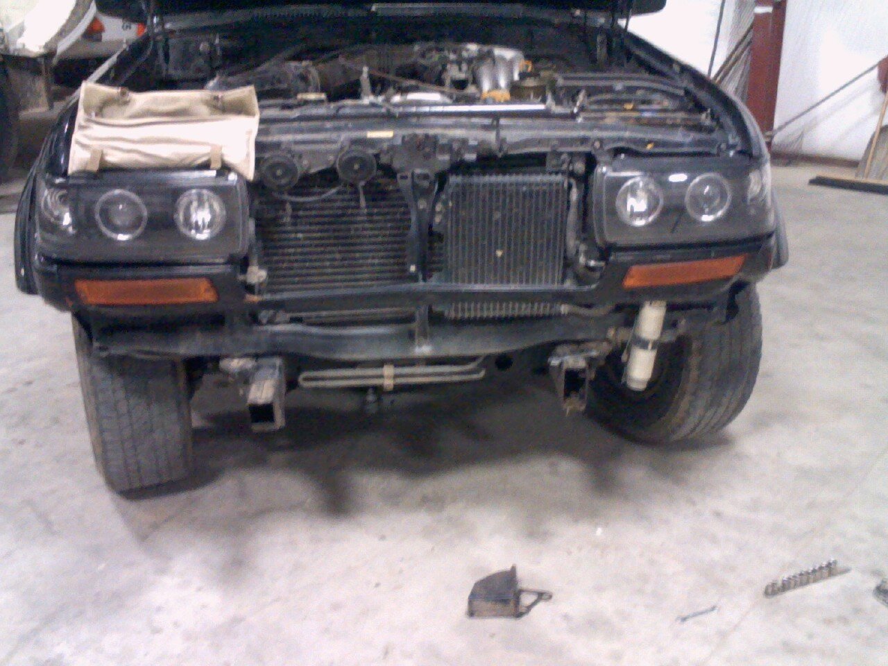

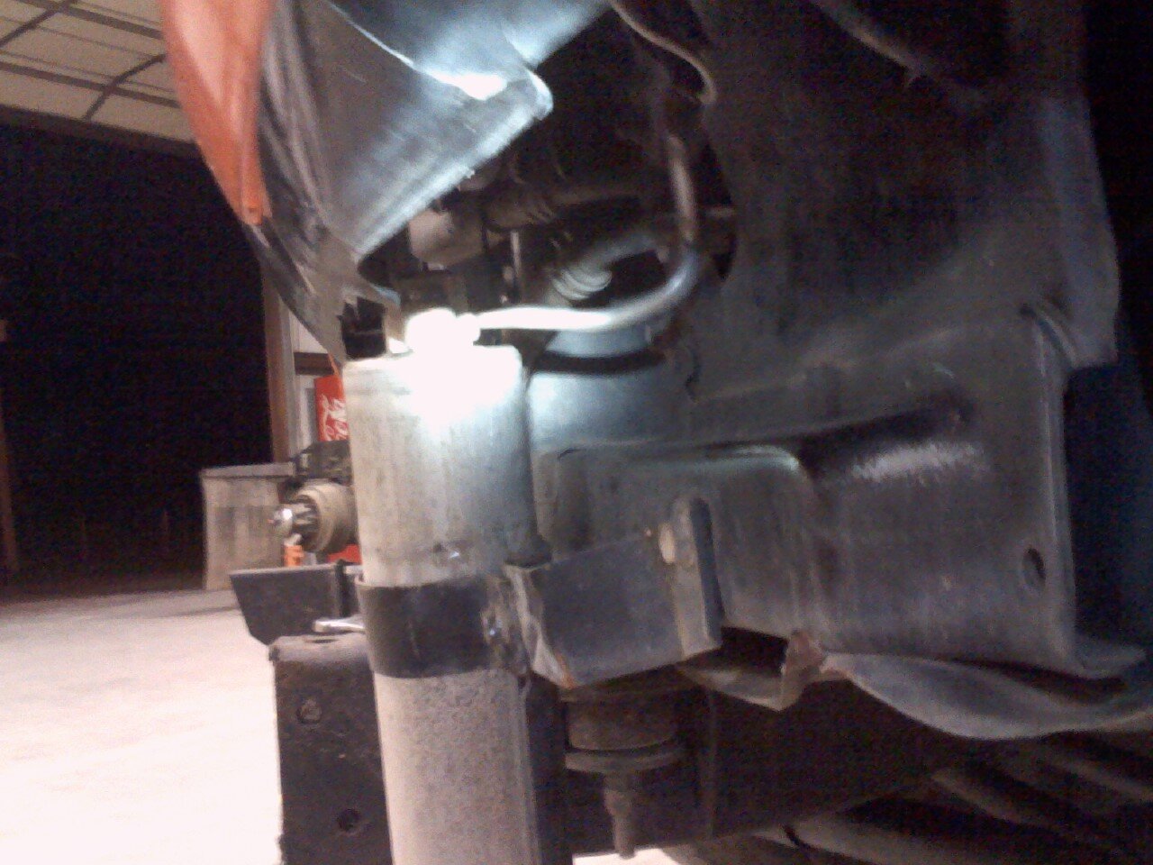

Ok here are some pictures of the part and the front end of the LC pulled apart. Plus the new headlights I just put on!
There are 2 pipes that attach to the drier, one goes to the condenser and the other goes towards to bulkhead. BTW the condenser does look similar to a radiator. The short pipe that goes to the condenser is 88716-6A421 and the longer pip the goes towards the bulkhead is 88716-6A410. Both should fit a US 97 FZJ80.
Yeah took me forever to find a diagram that showed the part, but i found it and have it fixed now. Thanks for your help. Now looking for an oil leak. I will get pictures up soon.
