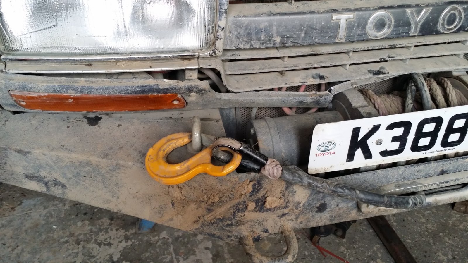

After winching the layers can jam up on the rope still on the drum, one other thing I do is to wind the rope back on criss cross it stops the windings biting in between the other layers and jamming, I have had the windings get so tight it became impossible to pull the rope out, I have had to hook the rope to something solid and reverse the truck back to get them free
Cheers Ben, I'll try that next time.If you already have some rope pulled out, simply put 2-3 wraps of the rope around the tube on the bullbar and while holding it firmly in place, flick the winch "Out" button for a second or 2. That is usually enough to un-jam the rope.

Tip for when plasma rope jams on the winch................................
