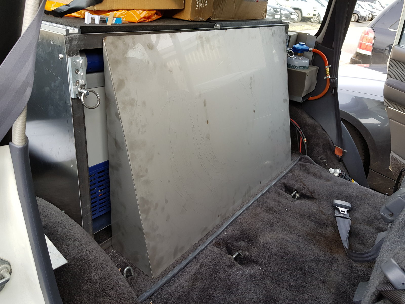

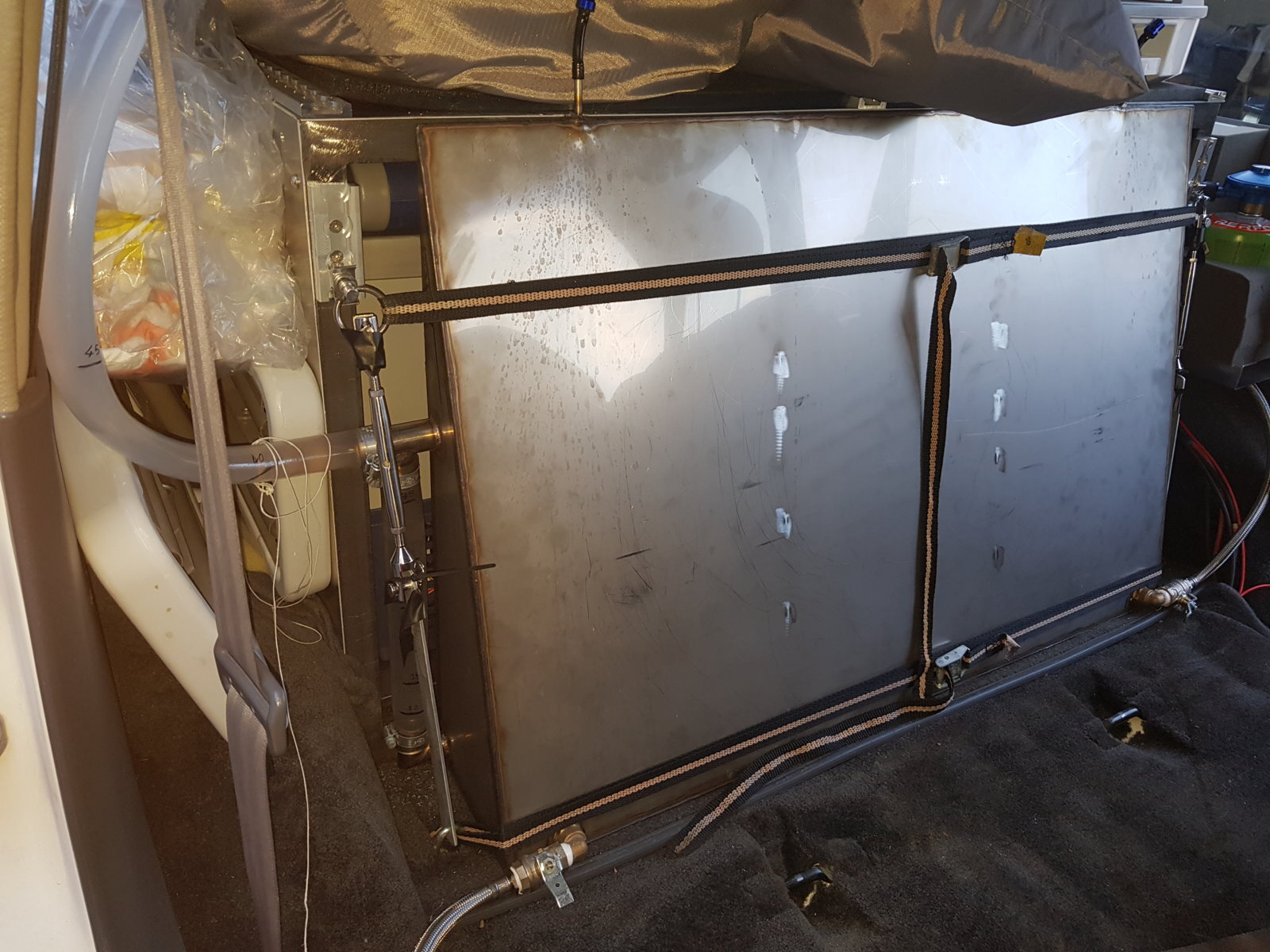

    It
    Yes it is expensive because you have to use 304 or 316...but to clean there are specific products to be used. You can clean it ones a year just to be sure!
    For mine I spent around 300£... it's a bit, but it's made on my drawing so...not to bad for me!
  12. Aeronick
    Aeronick Member I am in great_britain
    107
    65
    28
    Map
    The previews pictures was just a test before to weld it...I took a pictures of the final result!
    I fitted 2 ball valve to connect one to the water system and the other one is used to drain it or attach a supplementary tank if needed.

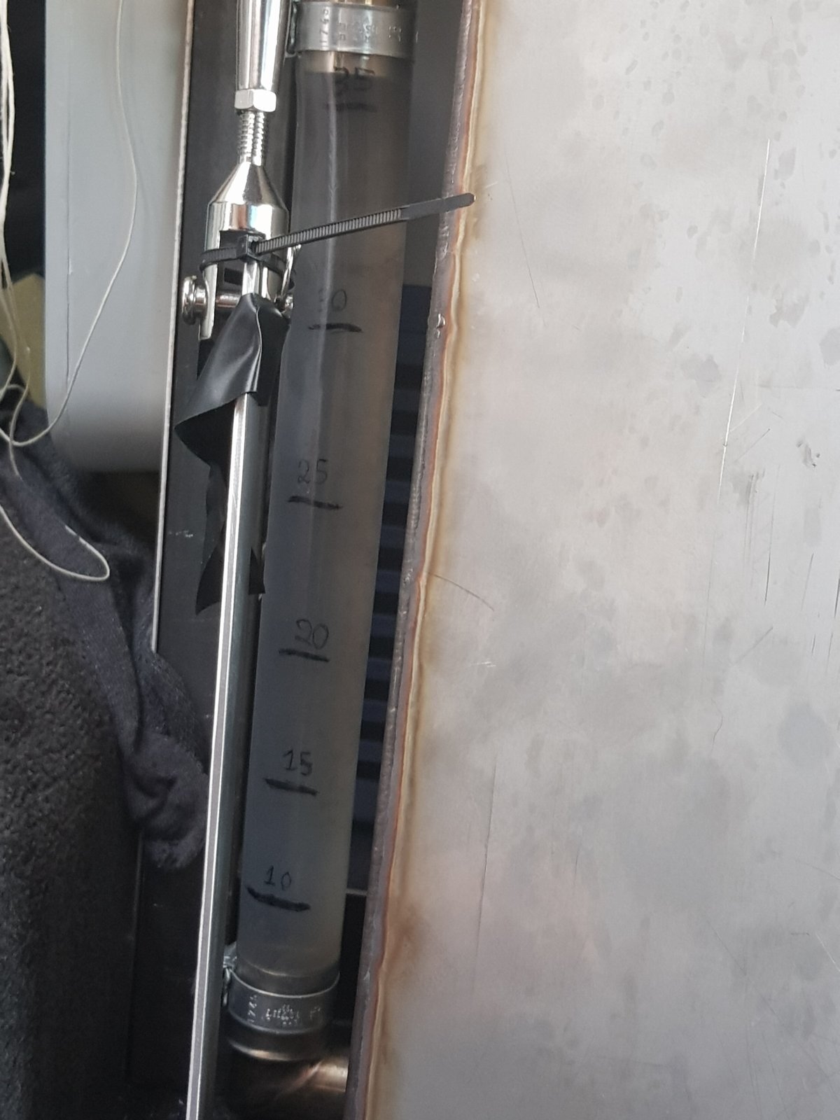

  13. Aeronick
    107
    65
    28
    Map
    And I have a level indicator that I graduate in order to know how many liters are left

  14. alexander
    alexander New Member Supporter I am in wales
    48
    19
    8
    Map
    Looks like a good design.
