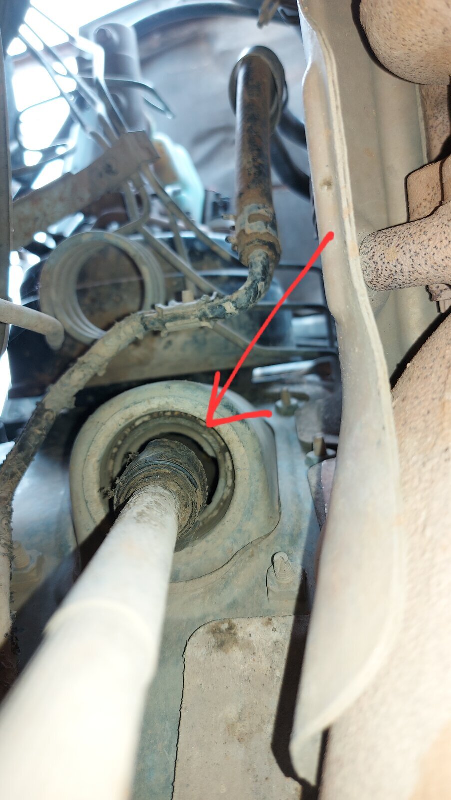

I've also noticed that the steering rod which comes from the steering rack up the the steering wheel (sorry I don't know it's proper name) has had its rubber seal completely worn off at the top; please see the photo attached. I'm wondering if this has anything to do with the noise I'm hearing or does the seal serve no important purpose other than for dust/ water protection?
