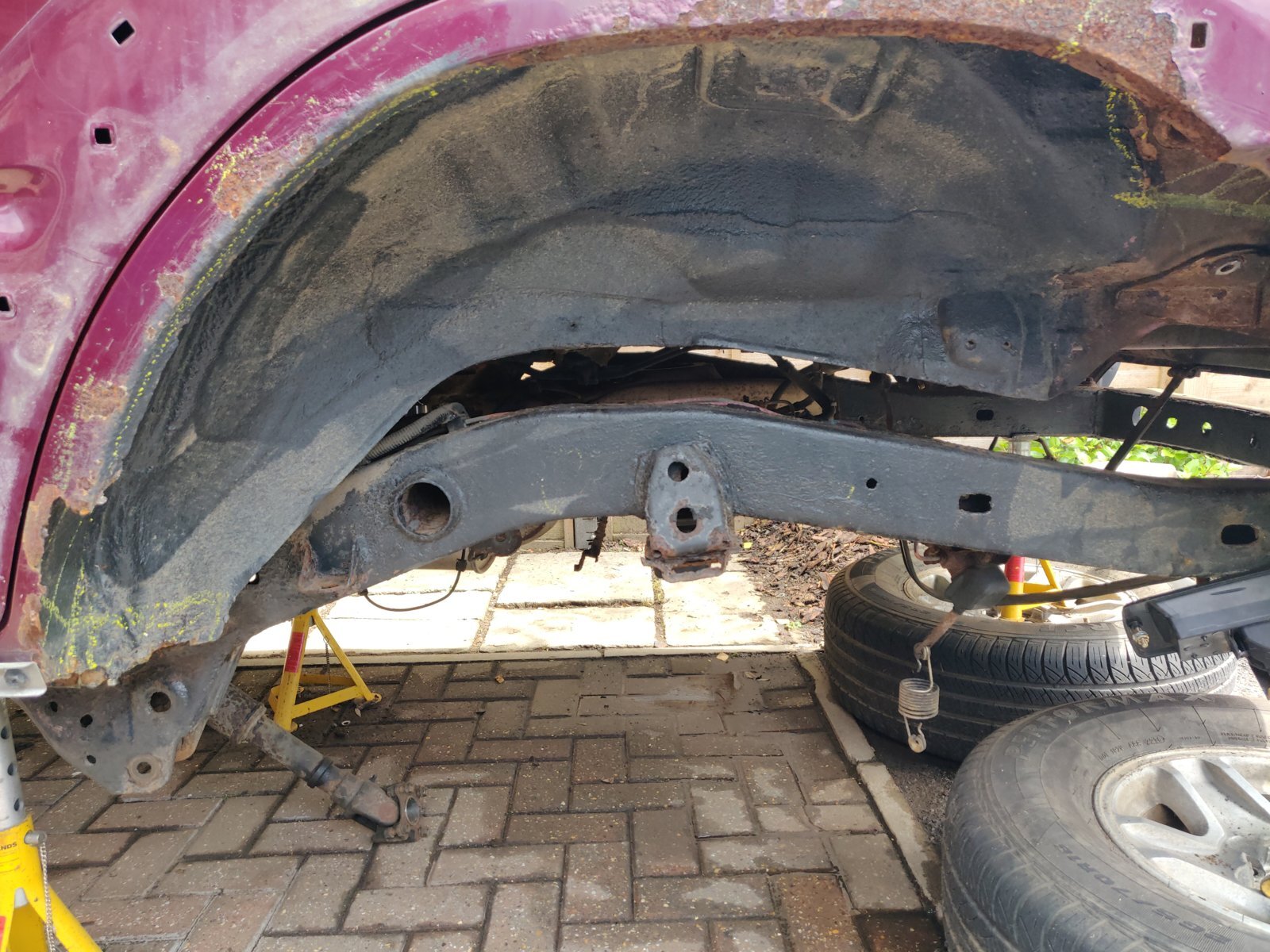

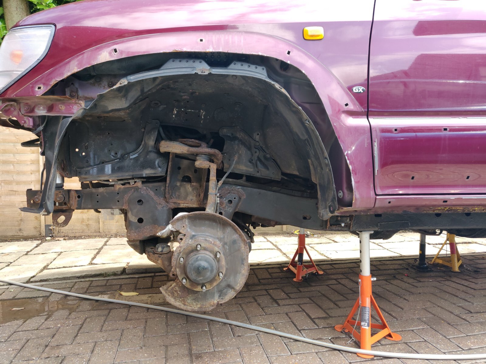

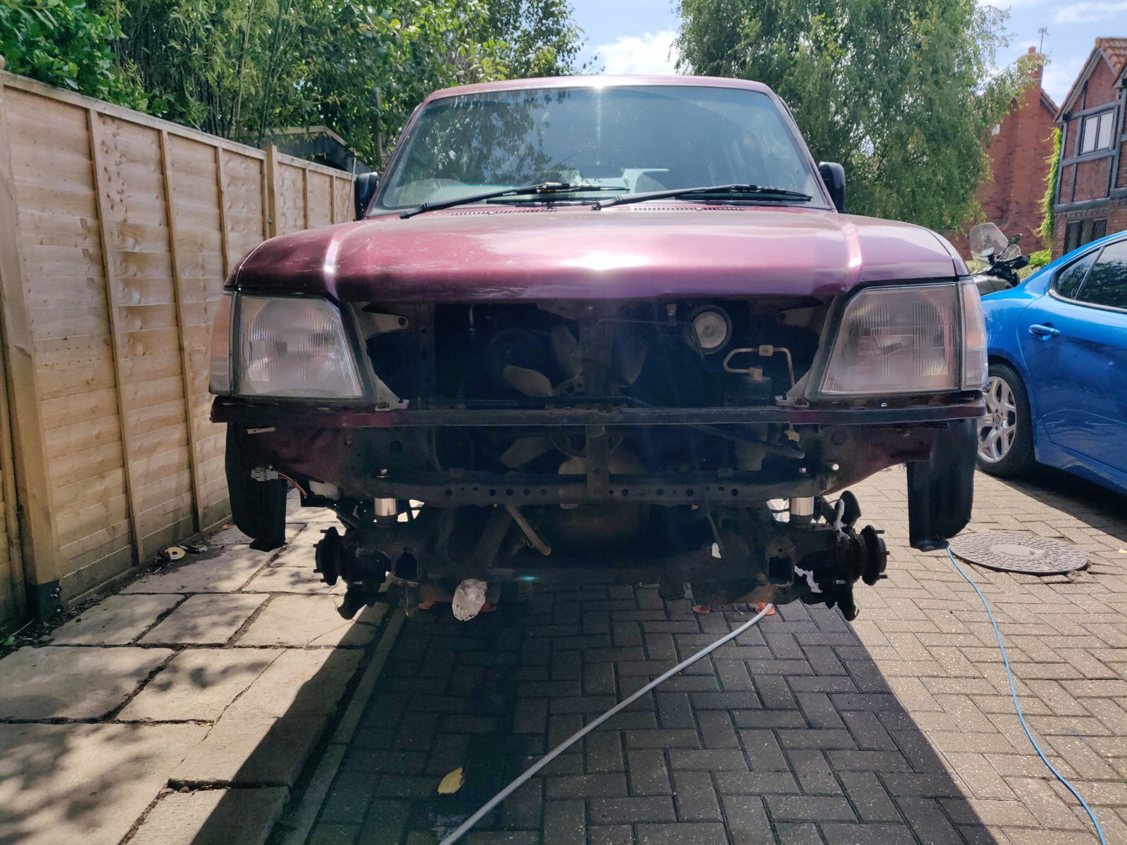

    Body lift done. Bit more grinder work sorted the knackered nut. Also chopped off the over long milners bolts from the kit. Looking a bit better! Pics of chassis clearance.

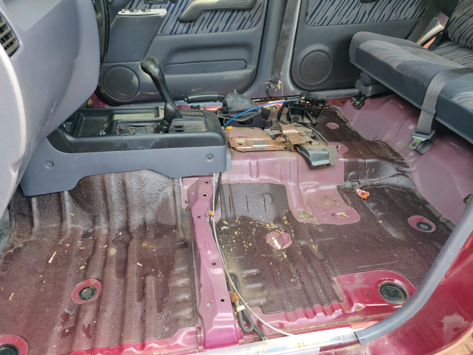

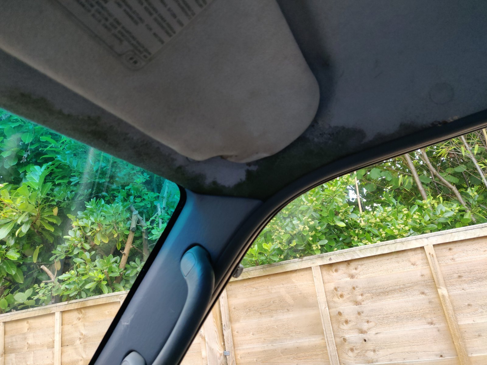

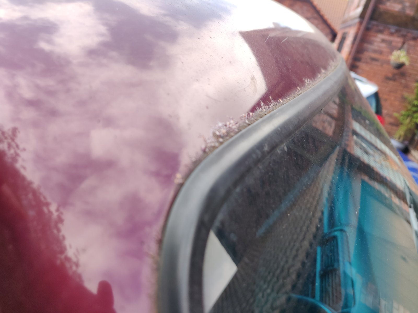

    Then onto stripping out the carpet... Found the water ingress. Rained hard last night... Looks like windscreen seal has gone. Anyone any reccomendation on whether to have the screen taken out and put back in with new seals (after sorting out the rot) or just get it replaced?
  4. MarkW
    MarkW Well-Known Member I am in morocco
    2,121
    745
    113
    Map
    theres probably a rust hole behind there somewhere I'm afraid
  5. Finiterex
    Finiterex Well-Known Member I am in uk
    206
    83
    28
    Map
    Yep that's what I figured too... More welding!

    Well feeling a bit disheartened this evening....
    N/S front arms slackened off, tried to get track rod ball joint out but had to cut nutt off and can't find my splitter to smack it out...
    Didn't have a 34mm socket for the hub but so popped to Halford... Only one they didn't have... Yup 34mm!
    So cut tie rod end off to look at steering rack amd maybe fit the new tie rod inner and hey guess what.... Rack is leaking PS fluid out the ends so that's fooked too!
    Gonna be a new truck at this rate and I'm gonna be bankrupt!
