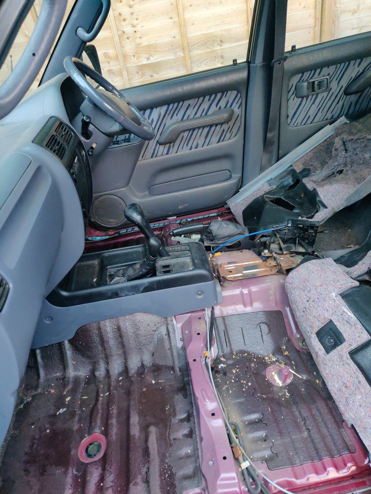

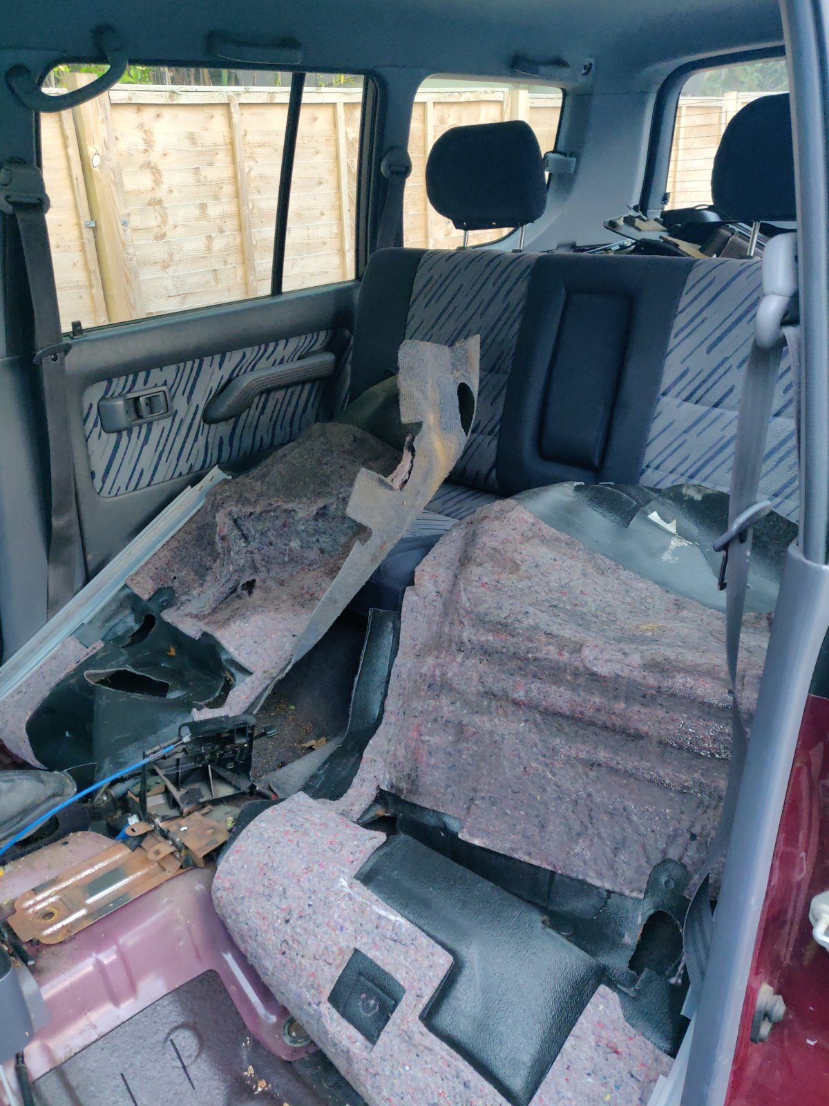

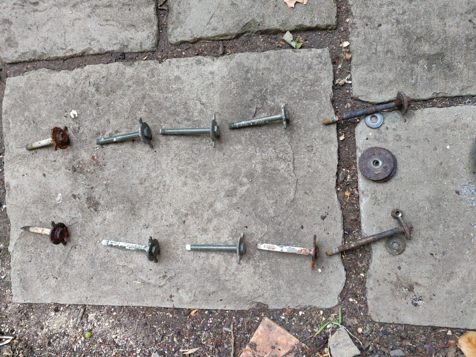

This evenings activities... Body no longer attached to chassis... Interior mainly out... Body lift kit going in tomorroe evening once I've detached the steering linkage and bent some brake hoses!
