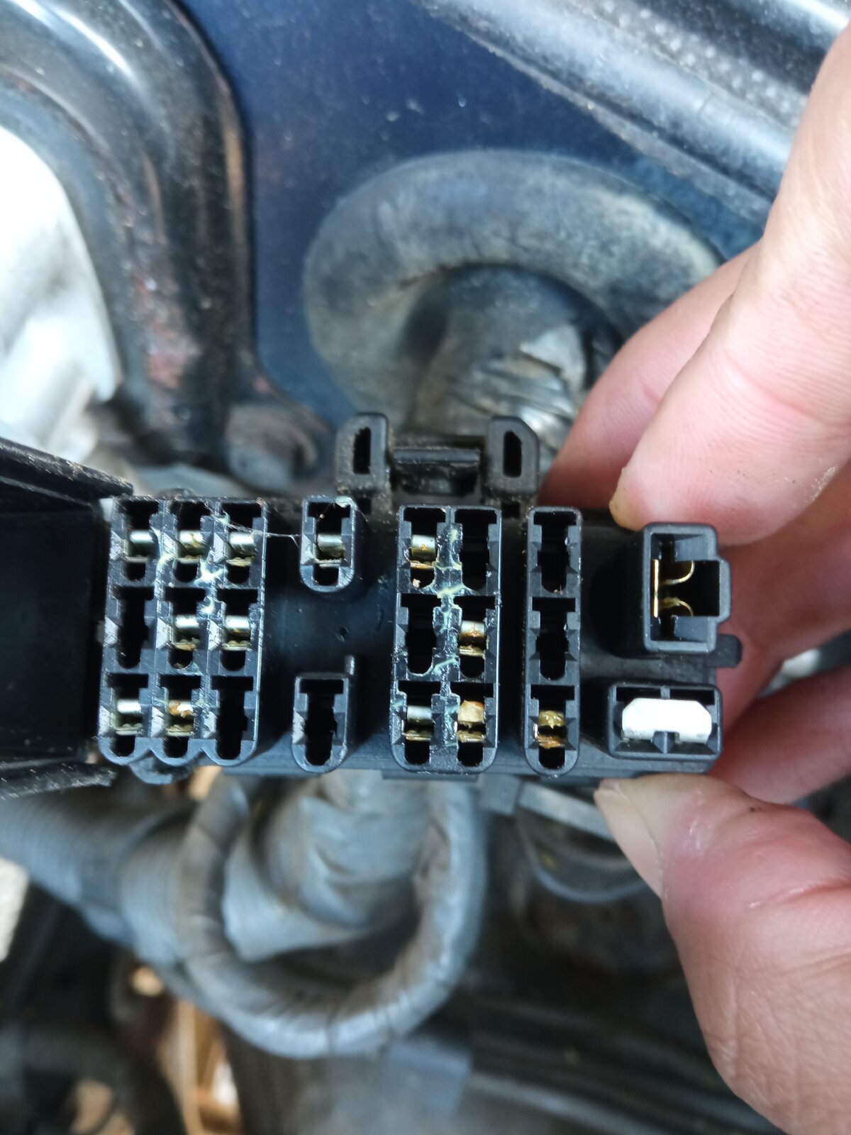

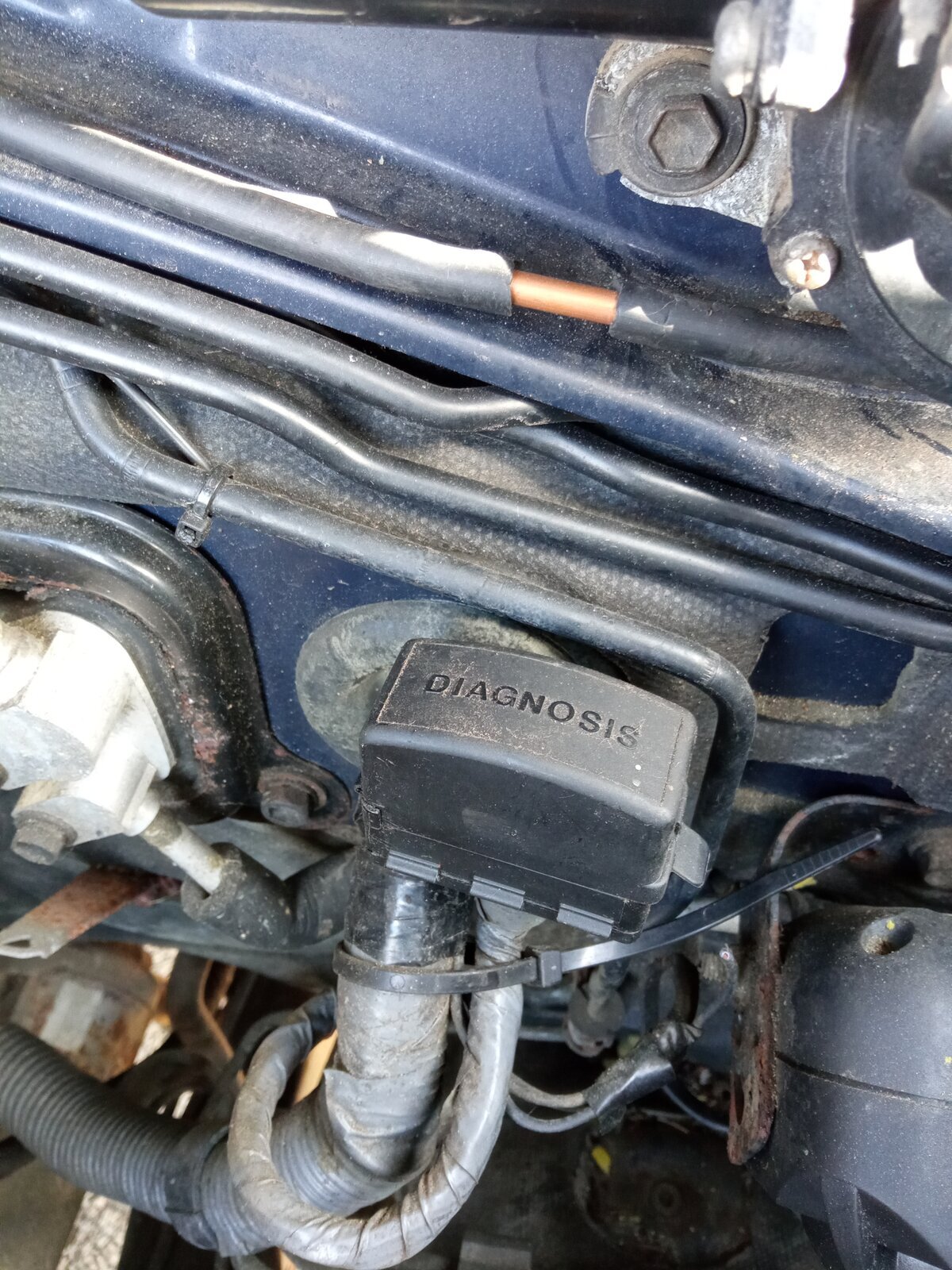

The 80 series 1fz-fe is OBD1 until 1996 I believe (95 is an oddity), and you can have WAY more information IF you can find a TOYOCOM or TOYOFAN which the manufacturer zf-scantools literally just stopped making (I'm not affiliated in any way)... look for those terms online and there is a Facebook group that talks about TOYOBD1 app and another group for buying/selling...
TOYOBD1 Users, and the selling group name I cant recall and I dont Facebook but if I find it I can send... oh and it works only on Android and is on Google Play... but you can usually easily find a used Android phone or tablet for cheap and it connects via bluetooth...
Youtube has a bunch of stuff about this and IH8Mud has lots as well.
