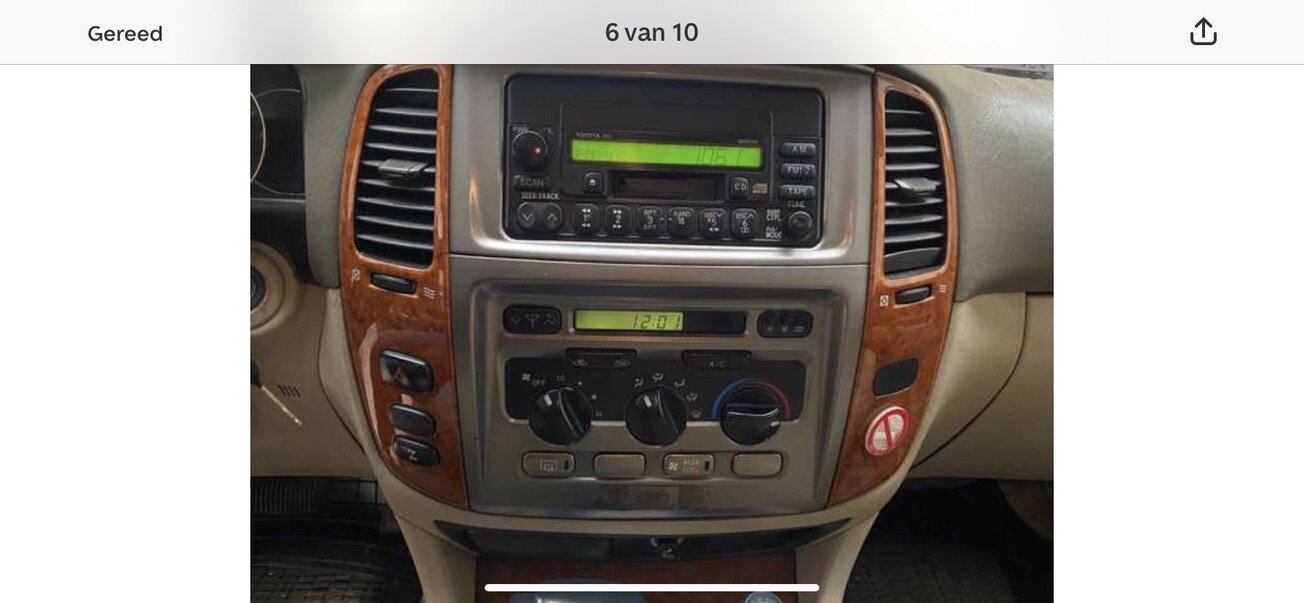

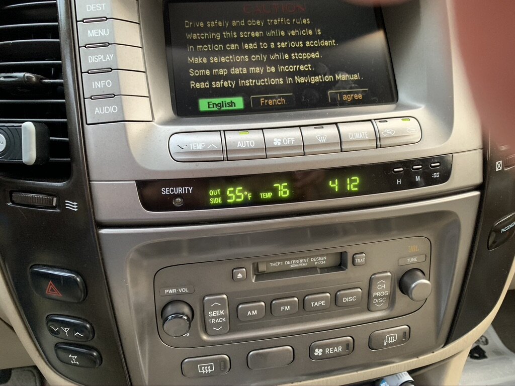

This car is originally from Calafonia (USA) and imported to the Netherlands (Europe). I need to replace the radio because the American radio frequency is different to European radio. For example the USA radio does not receive frequency 92,8. Only 92,7 or 92,9. So not the even digits. As the radio search function is operated via the touchscreen, as-well as the Airco / Heating system, I believe I need to replace the total unit. I have attached pictures of existing unit and the desired unit I think I need.

First, you can't go from "Current" to "Desired" without a major rebuild, because you have a 2003-onwards version (8/2002), while the "desired" version is the 1998-2002 version. (Which really is desired, because it really was much easier and safer to use, and easy to upgrade)
One way to go is to get hold of the HVAC-control-parts from a version without integrated navigation, and thereby be able to fit any modern radio/navi head unit.
Another way is to change out the whole unit with some Android unit which can handle both functions, e.g. like described in one of these mud threads:

But, if you can get a solution with physical buttons, it will be the best. Having to look at any kind of display in order to find a button, or to see what setting you are on, is a not a good solution when you are responsible for driving a car. In a "self driving" Tesla you have some assistance, but when your windows are fogging up while there is one car from the right, and one overtaking, and you are late for kindergarten, it's not a good idea to look down on your screen. The 2003 onwards LC100 without hvac-integrated navi is not much better either, as there are only push-buttons, and no tactile feedback. Except for the rotary temp setting, where you are supposed to get 1/2 a degree per notch. For the mode button, you actually have to look down at a tiny, grey, display, in order to find out which mode the hvac is set to.
The Pre-2003 version with the three big rotary buttons is really one of the best user interfaces for hvac controls ever, as you can feel what setting you have, without having to look down there at all. It will be in your fingers after a week. I haven't heard of anyone managing to graft it into a post 2002 version though. Presumably there were changes to the signalling or ECU, apart from the changes to the shape and size of the dashboard.

You won't be able to get the "desired" version with the rotary controls, because it is pre-facelift and there are signalling differences. What you can get is the button controls:
img_20180119_133109-jpg.1615195
Replacing all the bits and pieces from a touchscreen to buttons with a conventional 2 DIN slot is about $1500 in new parts. This includes the AC ECU, some control boards, brackets, the side panels, the AC controls themselves and a few other bits and pieces. Hard to get them second hand locally as there were barely any such models in Europe.
A cheaper option is to try to get the needed parts from a wrecker in Dubai or Australia (works, but buttons and knob are mirrored). Lots of parts involved, so there is a big chance to get sent the wrong or missing parts.
