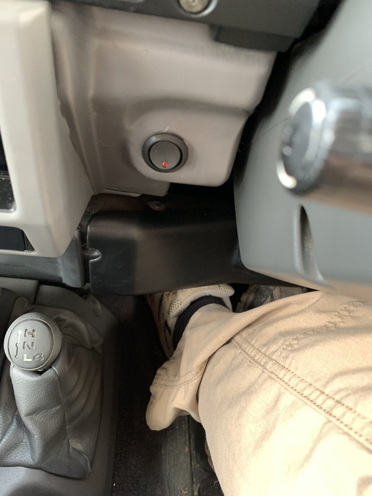

Looks aftermarket so you'll need to trace the wiring. Does the LED actually illuminate so a switch for a lighting relay or similar? Alternatively take the missus out for a drive and try it.... could be an ejector seat!
Looking like an aftermarket switch maybe for rear fog best thing to do is switch it on and have a walk around with ignition off first then on then sidelights then headlights
Steve was spot on, imports have to have a rear fog light retro fitted when registered here to comply. Must be wired wrong if draining battery, it should only be operative with ignition and lights on. You now know what its for anyway.
