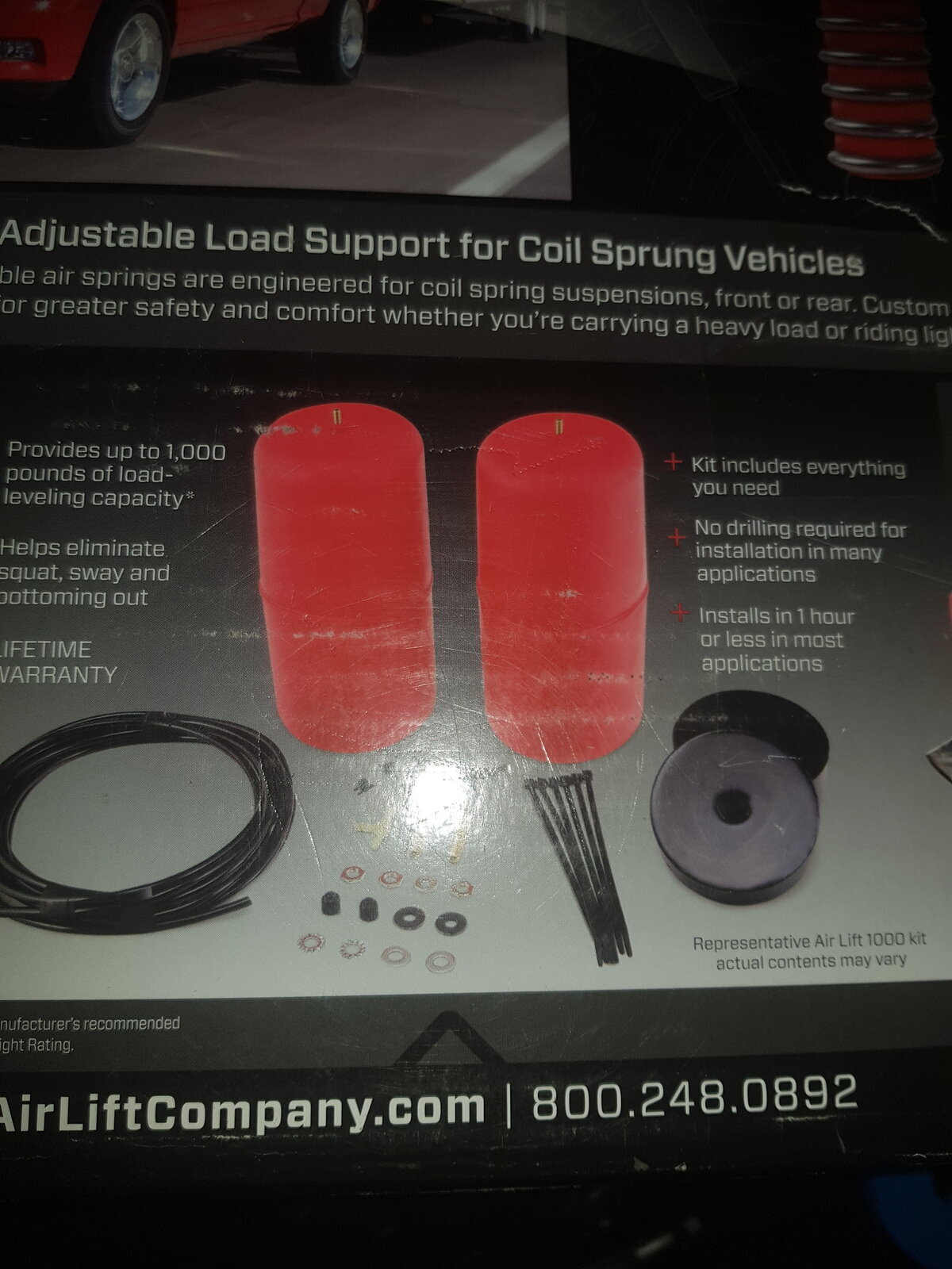

Anyone got any pics....?
I think I've made my OME springs sag after I towed 4 tons of Halftrack that was very nose heavy on the trailer.....it nearly put her on the bump stops.... now sits level when parked and not tail high like they normally do .
I'll upload one in a min. They are literally just red bags that go inside the springs
hope this helps
